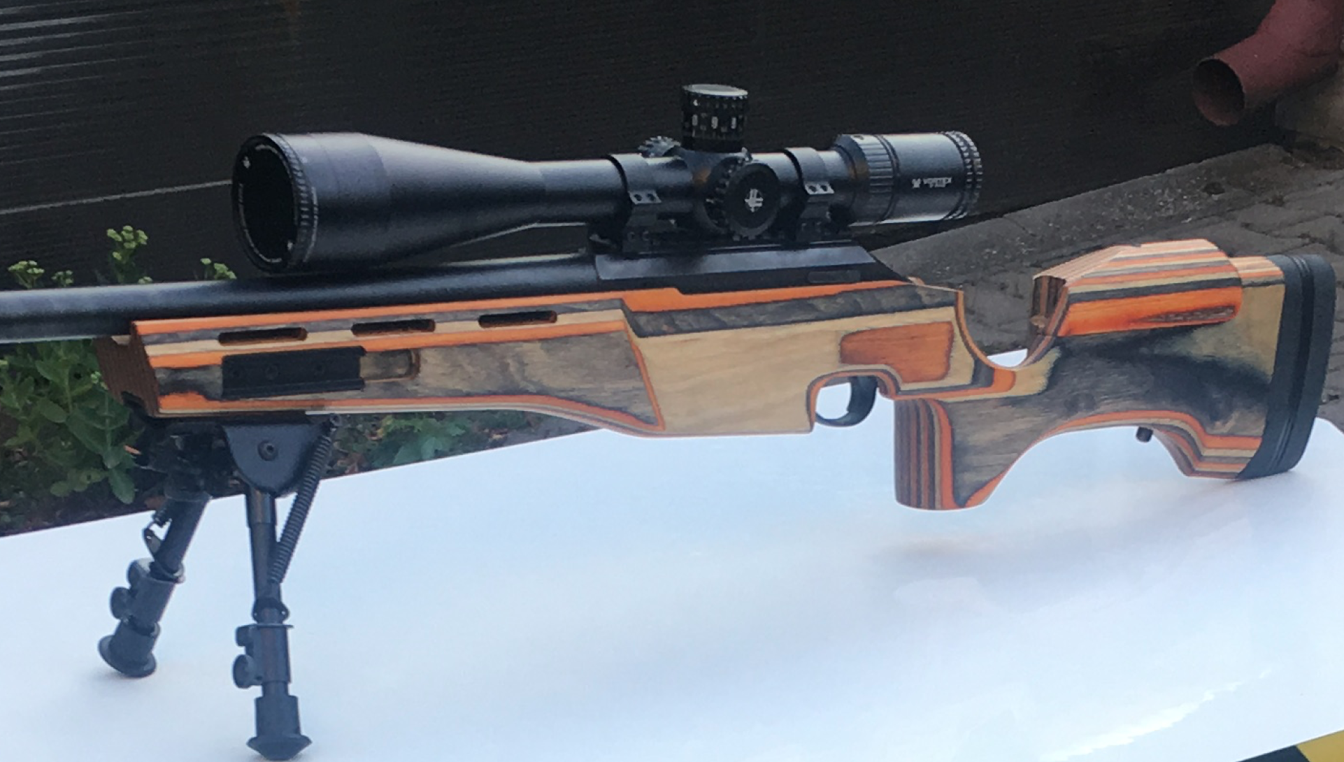

I have some of these that work great. At .735”. Scope is a NXS 2.5-10x42
7112084

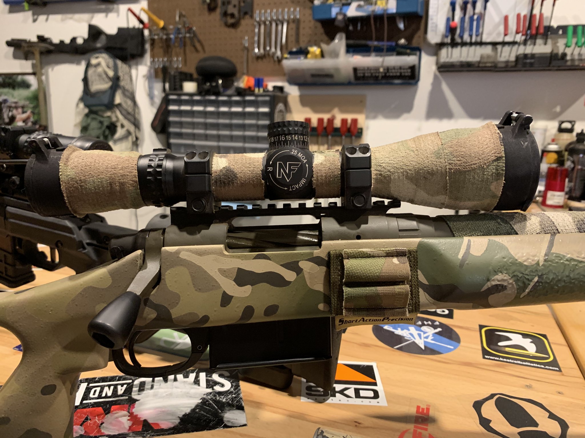

These are the lowest I’ve found. They align well and hold tight.
John

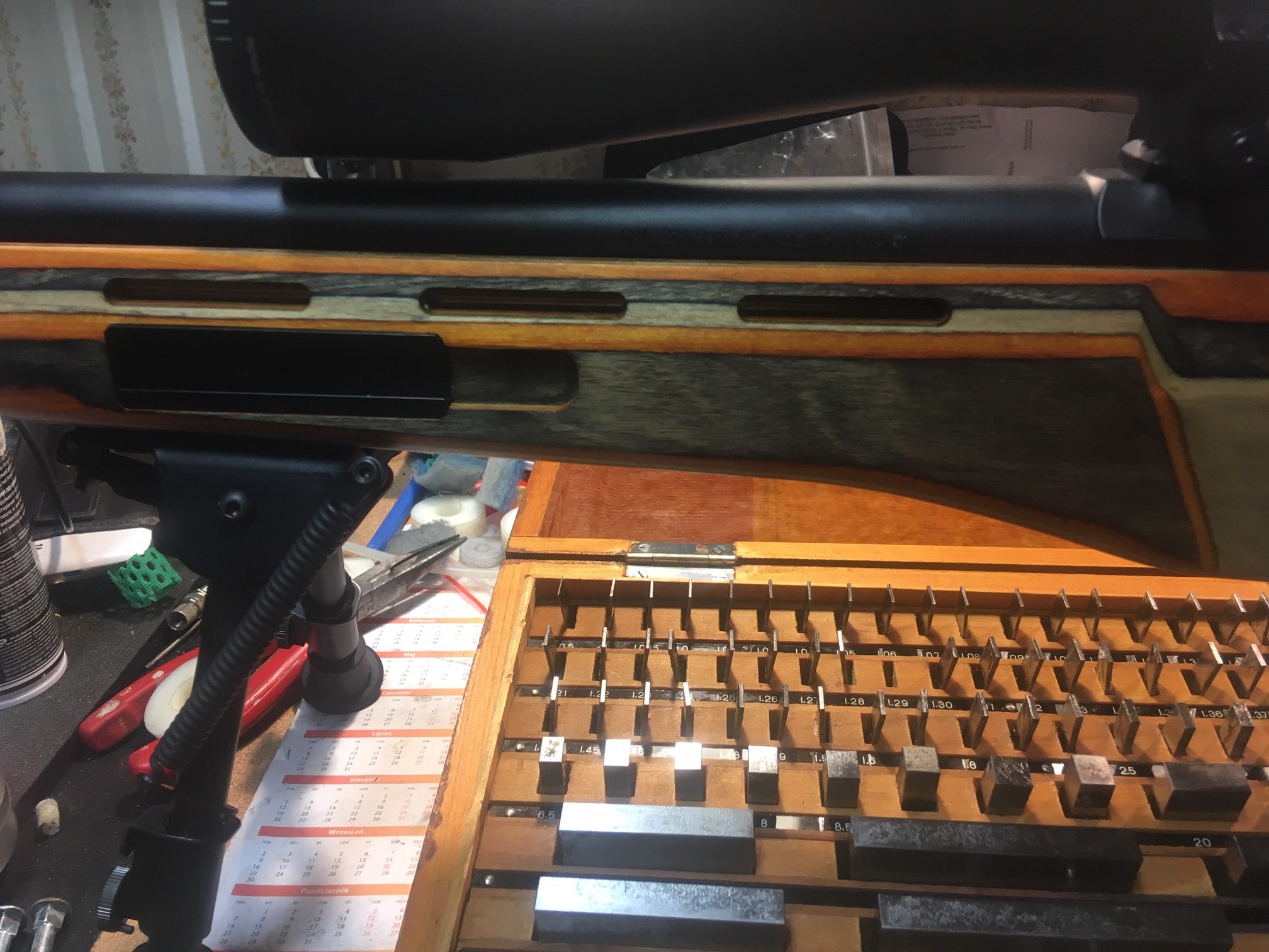

Ken Farrell 30mm Lows 0.735”
