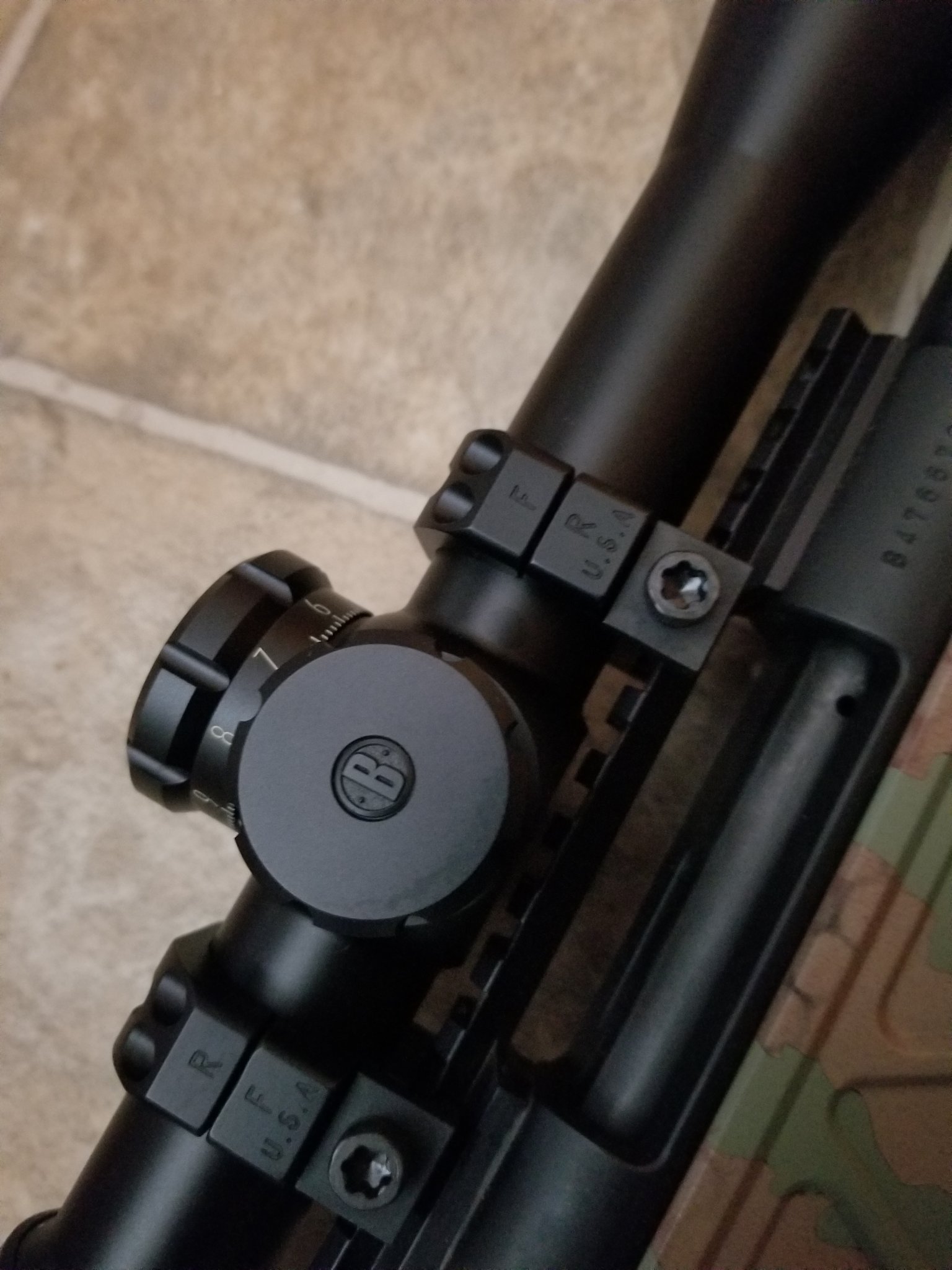

    I’m mounting a 44mm objective scope and have some vortex precision low rings (.87) but it still sits higher than I want off the barrel.
    What are some other good rings that go lower than that? I saw the Seekins low go to .82 but that’s not a lot of difference from where I’m at.
    The scope is still 1/2 inch off the barrel at the .87 height.
    Ken Farrel and APA are going to be as low as you can find...
    ETA:
    I'm assuming you are asking for 30mm main tube.
    The above pic shows my KenFarrel rings on a Bushnell LRHS which also has 44mm objective...
    And yes, I do realize in the pic, the top half rings got mixed up. The fronts and rears are not matching but that is an old pic and I did not torque down on it that way.
    Reactions: Rerun7
    Ken Farrell low rings are at .735 of an inch. I just checked, that's what I had on one of my rifles before. Now I gave my dad the Bushnell LRHS along with those rings since he doesn't have adjustable cheek piece. They're low but will clear the erector housing.
