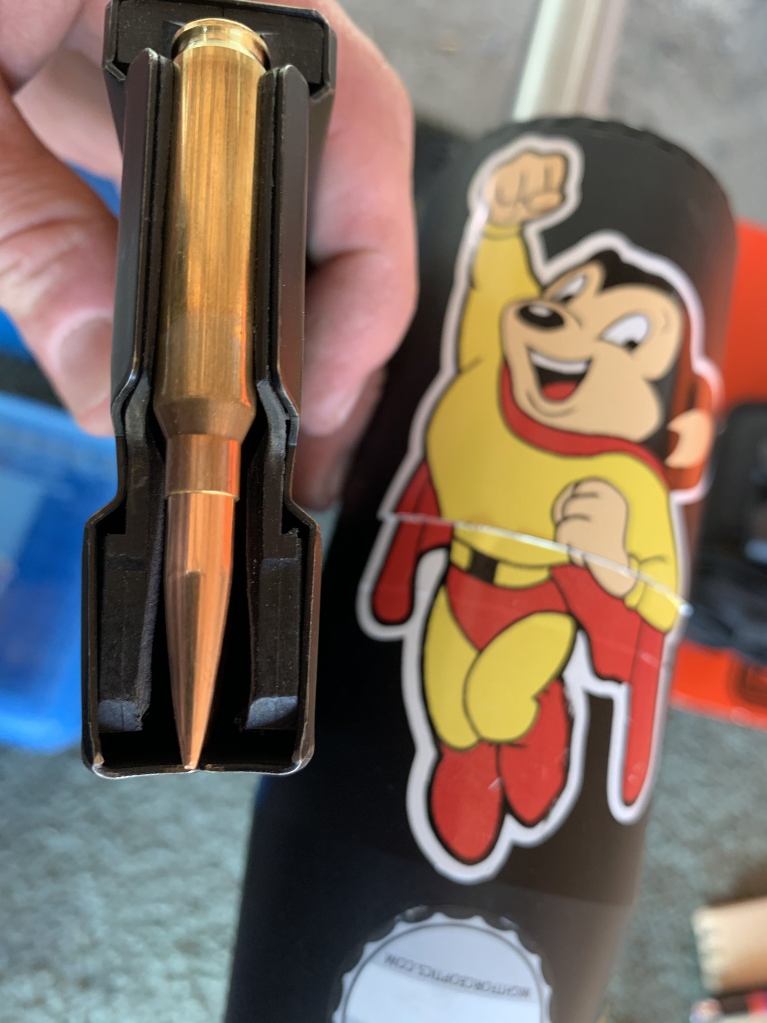

I would normally say straight 6BR but with 6mm bullets being the way they are 22 BR does sound like a good idea.
