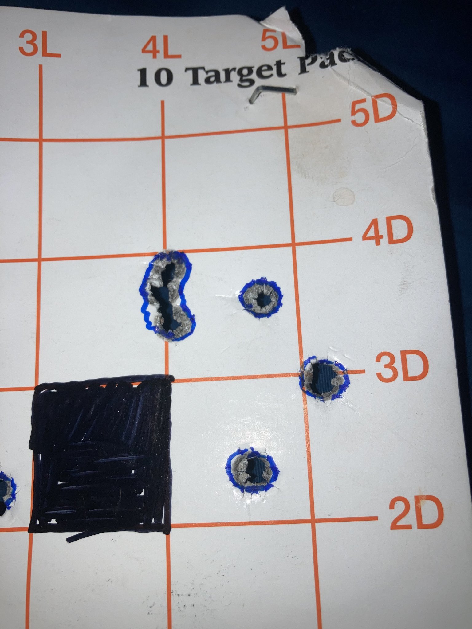

So the very franken lr308 that brought me to this place has entered the final phase of tinkering g and load development.
Adjustable gas block- heavy spring and buffer . Nice trigger , epsilon muzzle break .
Function in now 100%
Accuracy load development is coming along .
168 match monsters over 43 grains Varget .
after much reading here about shooting large frame gasser and trial and error . I’ve figured out how this pig likes to be driven .
The three shots on the right of above target is from bipod and rear bag- three into right at 1inch .
The three shots touching circled in blue on the right just under .5 inch were fired with bipod loaded with forward pressure- firm grip on handguard rifle pulled firmly back into shoulder and close attention paid to follow through- wait for recoil impulse to cease, allow trigger forward to reset .
Both groups fired with exactly the same ammo same magazine- shot one after the other at 100 yards with a gusting 12-16 mph westerly wind(blowing left to right )- . Driving a gasser is different than a bolt as we all know - now that I’ve got it running and think I’m done tinkering with it with the exception of playing with seating depth a little more learning how to drive a particular rifle especially this ugly bitch makes the difference between a MOA rifle and half MOA rifle
16 inch BA barrel

One more random thought on the matter- I specifically went with the BA barrel over the factory DPMS barrel because of all the posts here about BA tending to underside gas ports and the DPMS barrel being so horribly over gassed, like worst I’ve ever seen or heard of - shit the BA barrel was as bad maybe worse .
And the last problem of random flyers that I’ve spent all winter pinning down was the gas block hitting the hand guard- not all the time just every now and then didn’t figure it out until I stripped it completely down and saw the matching marked on top of the gas block and matching marks on the inside of the handguard . I’d actually taken it down to make sure my barrel not was tight to spec and if my barrel maybe needed some shim stock to tighten everything up. Everything was tight as hell and but was fine . Random flyers have disappeared after filing a touch more clearance on the top left side of the hand guard . And I painted both spots with a white paint marker and 150 or so rounds in there’s no marks on the paint .
Not much a drunk pissed off Marine can’t fix with a file and some good sour mash.
