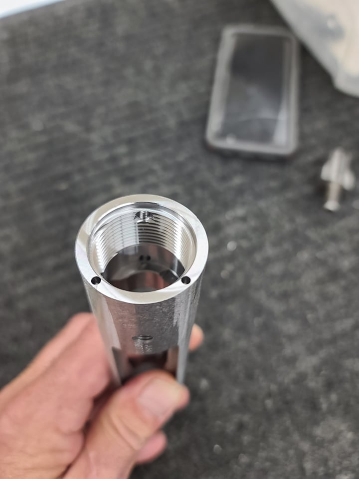

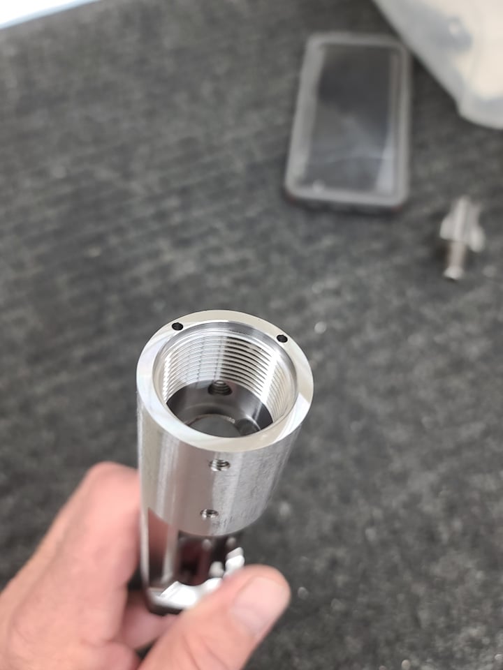

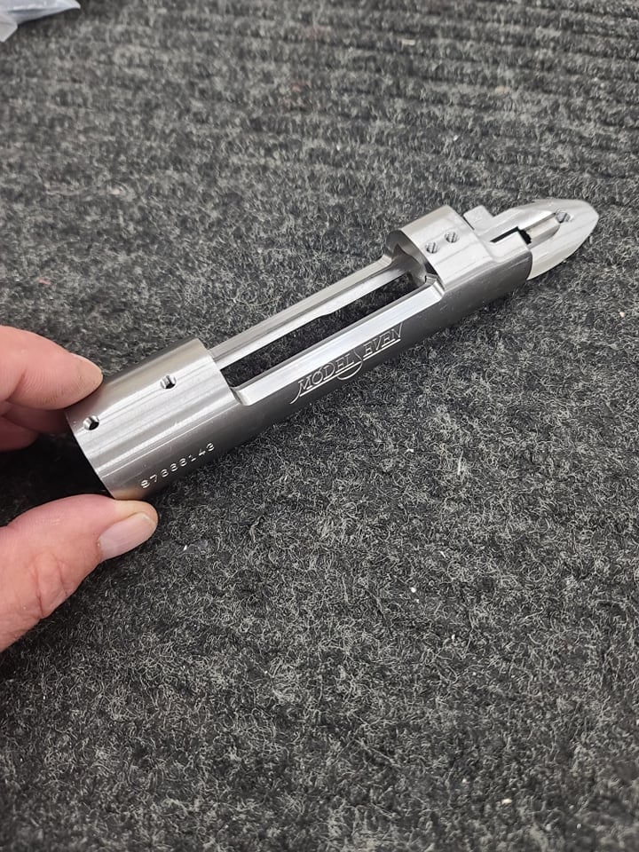

    Over the last week or so we've been running a large batch of M7 receivers through our Tier 1 Blueprinting process. We're finally ready to release these to the public.
    Here's the background on how this all came about: Prior to the Remington implosion their Custom Shop was located down the street from LRI. During an end-of-the-year inventory reduction effort, a sizeable quantity of Remington Model 7 Receivers was offered to us.
    Up for grabs:
    Remington Model 7 receiver blanks with the following work completed:
    • LRI Tier 1 Blueprint
    • Diamond honed receiver bore
    • Pinned for LRI recoil lug
    • 4x 8-40 scope base holes
    • Higbee Lead thread on receiver bore
    • ID chamfered front scope base hole
    • Resurfaced ejection/loading port
    • Rear tang hole opened to 1/4-28

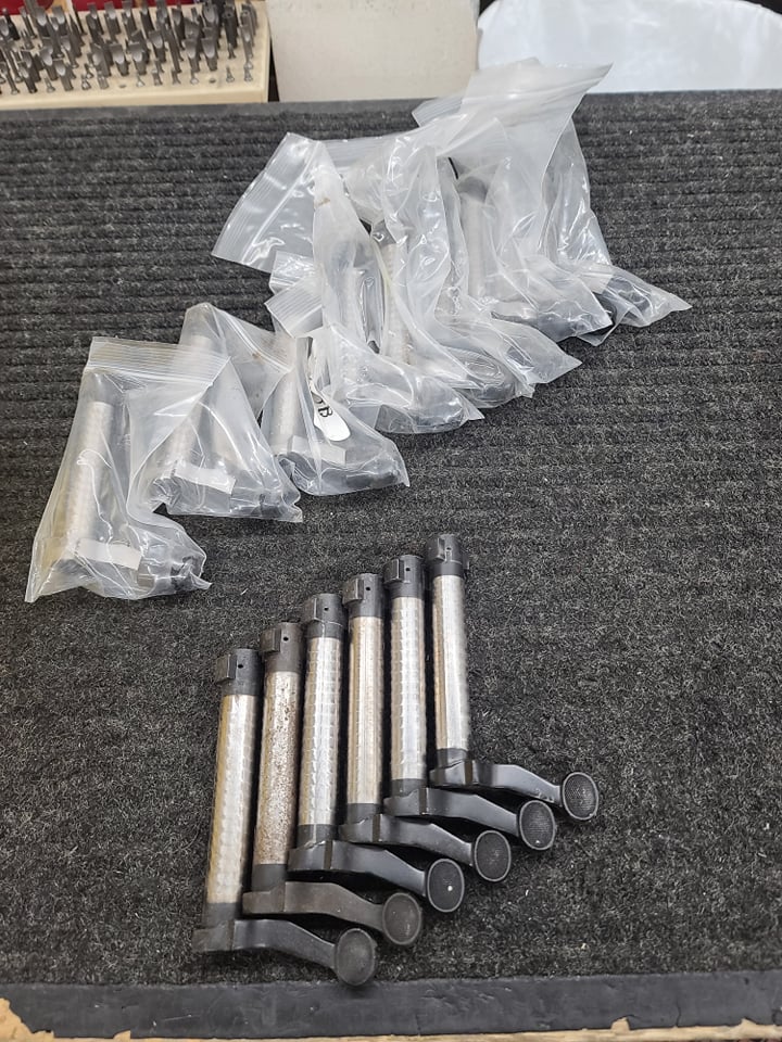

    Standard bolt work as part of Tier 1 Blueprinting:
    • Bolt nose resurfaced
    • Bolt face resurfaced
    • Bolt lugs resurfaced
    Elective gunsmithing services for the bolt: This is not part of this special. Our standard published rates apply. (Dealer rates will be honored as well)
    • Bolt nose bushing threaded/soldered
    • M16 Extractor installed
    • Alter bolt face to .390, .450, .480, .545 (using threaded bushing and induction/solder)
    • Dual ejectors
    • Bolt fluting
    • Time/Tig service
    • Bushed striker pin

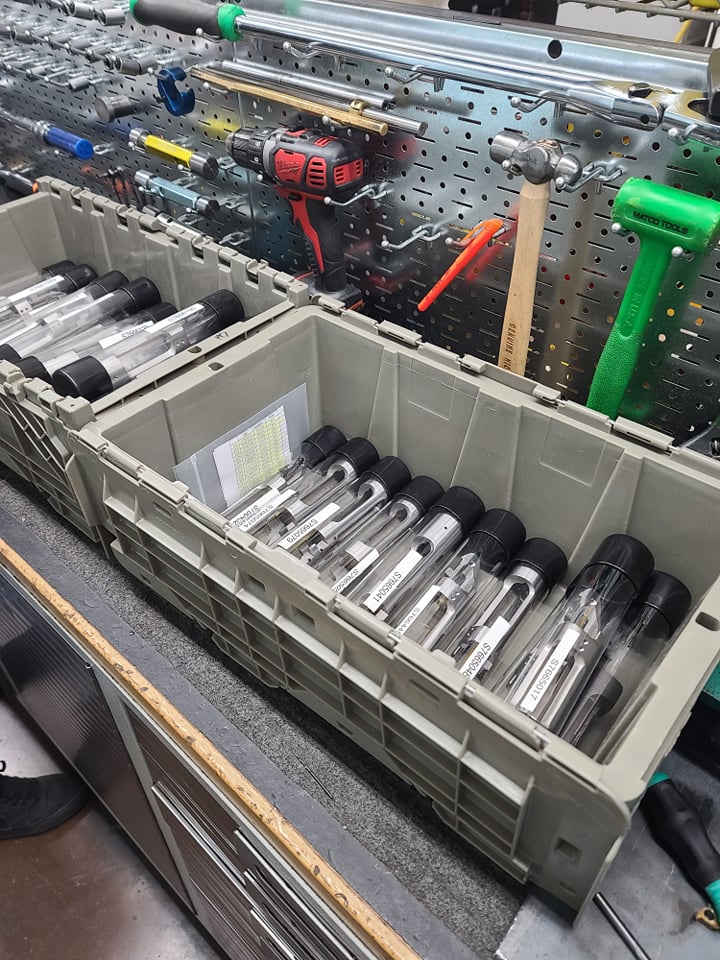

    As most know by now, Remington suffered a recent bankruptcy. Shortly after this happened, the entire M700, 40x, and M7 product line was liquidated. LRI has M7 receivers and a very limited supply of M7 bolts. This entire sale is 1st come, 1st serv. We do not have any fire controls or small parts in inventory. These will be items you will have to source. Our bolt inventory is very small. Less than 40. These too are first come first serve. You cannot buy bolt(s) alone. They must be part of an M7 action purchase. Additional receivers however can be purchased. (no limit on those) To keep a level playing field, this is limited to one bolt for one action. If we had more, I'd be all over selling multiples.
