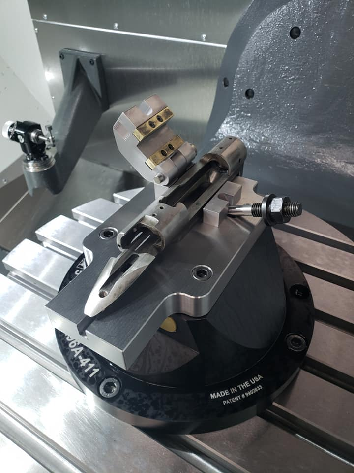

Gunsmithing LRI's 5 axis receiver blueprinting:
Incredible.
I dont fully understand what Im watching but Id imagine new owner of viewed machine would be squirting as much "coolant" from the joy of his new capabilities.
That is great stuff to watch.
How has the learning curve been for you, Chad? Seems like you're up and running pretty fast.
Also, will this new machine affect your pricing?
Thanks for the show and tell, always entertaining.
42 receivers run yesterday. 50+ more due to arrive this am. We busy! :)

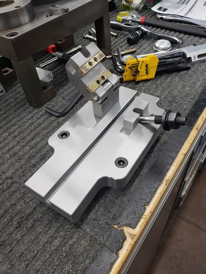

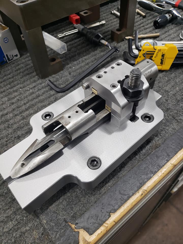

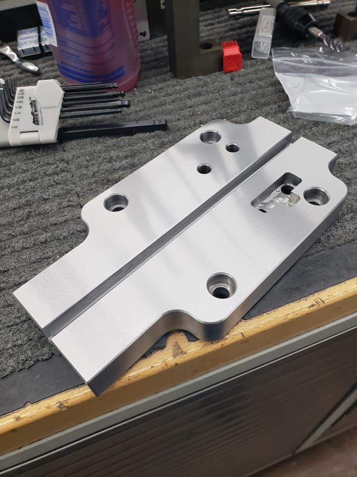

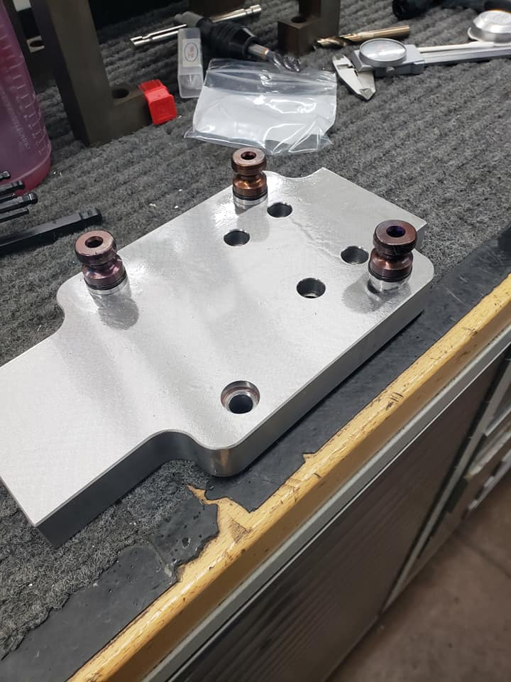

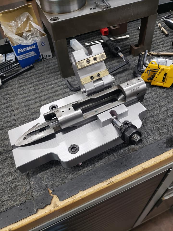

I Noticed on your site you are doing a fixture to run the Model 70s also... How close is that to being operational?
I think I need to send you my FN WSM!

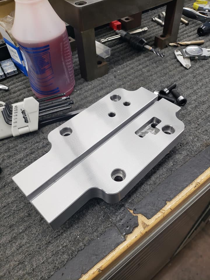

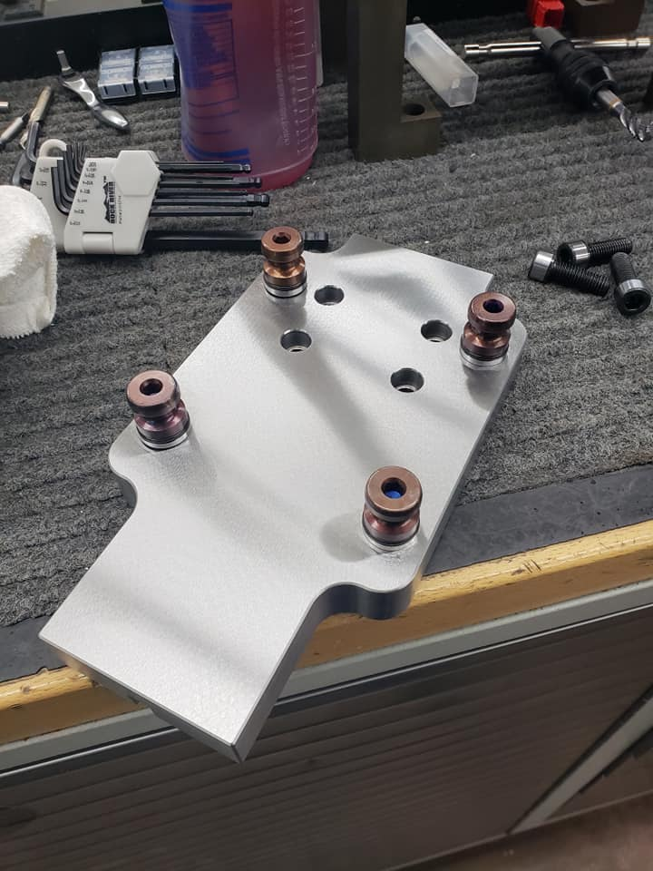

I literally just finished it. Had to cannonball down to Denver and back yesterday for a big material run so I didn't wrap it up yesterday as orginally planned.
On/Off the machine in 90 seconds. Tool package stays loaded at all times. Select a program and were rippin.

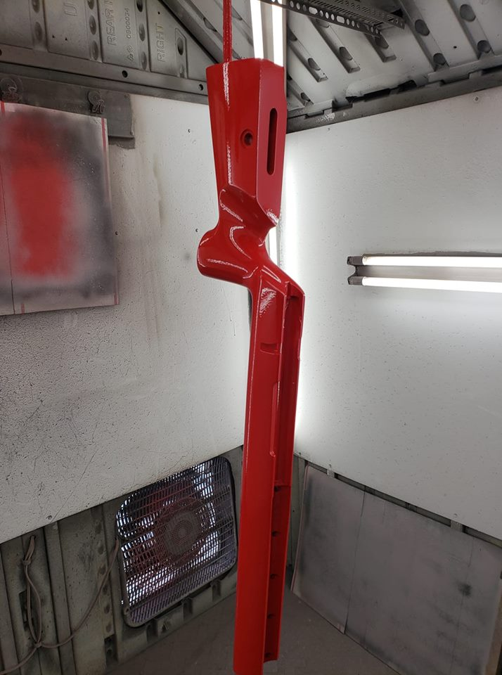

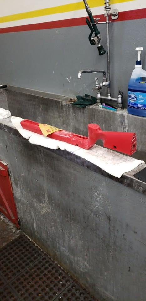

We've got a palma gun in here right now that were about done with. Automotive paint is still one of the jobs I like to. Relevance of this is that the Winny segment of this project has been on hold a few days. Fixture's done, now I just have to write code.
Hoping to get to that today.
Palma rifle: Viper Red on an old McMillan Prone stock that used to look like a blue raspberry, vanilla latte nightmare. :)

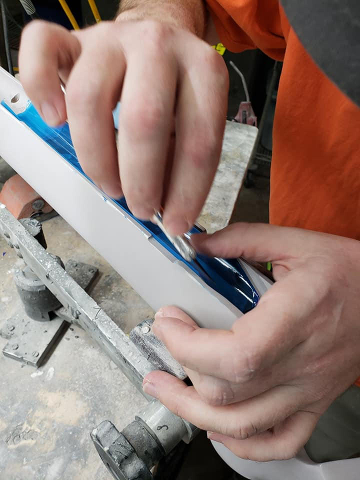

Masking:
7038543
Orange peel galore! :) Acutally, it leveled out pretty good.
7038544
No matter how good, I still like to color sand and buff. These things are so pretty when done this way. Still one of my poersonal favorite rifles to build. And with any color sand job I do, there's always a spot or two that I hit too hard and sand right through 4x of clear and through the base. Fortunately, I've gotten really, really good at fixing that. This'll get touched up and another coat or two of clear today.
