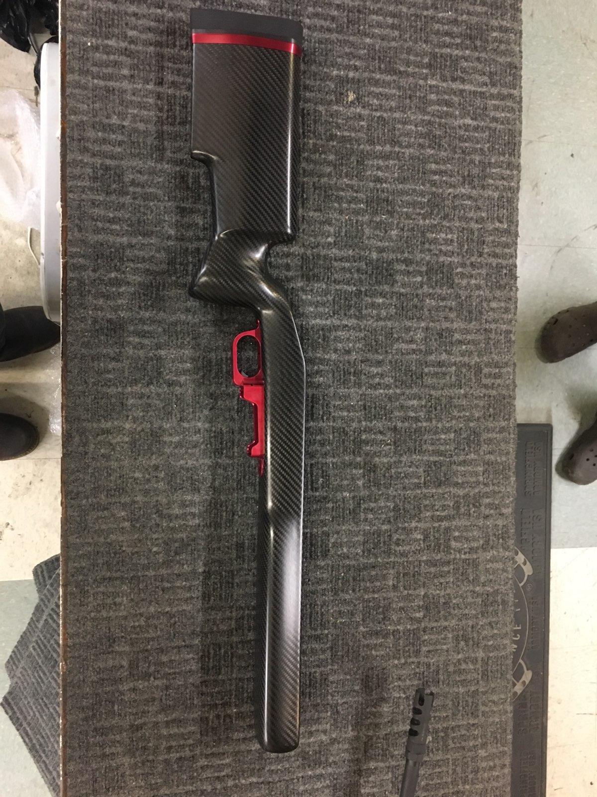

    15 or so years ago I was introduced to one of the most brilliant folk I've ever been fortunate enough to meet. A friendship was fostered and the catalyst was a joint venture on a rifle stock.
    That effort came to fruition about a month ago. LRI is very happy to finally debut the ELEMENT rifle stock. 100% carbon fiber contstruction. ELEMENT is THE LIGHTEST full size rifle stock available today.
    Specifications:
    Stock weight: .9lbs
    Stock weight fitted with hardware: 1.9-2.0lbs
    100% CoCured carbon fiber construction
    NO BEDDING, stock uses a patented compressive showline receiver register (patents (2) are on file and current)
    NO Core material. Stock is laid up as a homogeneous part. No left or right side. No dividing seam
    250*F autoclave cure temperature. Yes you CAN cerakote these with oven cure and its GUARANTEED not to delaminate, swell, or split in half at 150*F! We cap the warranty at 200*F.
    No pillars!
    All associative hardware is billet machined from 7075 AL and 4140 chromoly
    Paintable and can be Ceracoted
    Assembly ready from the box. You tighten two screws and go to work. No fitting, no fussing.
    Comes with: DBM compatible with ARC, AI, Alpha, Acurate Mag, and Magpul magazines using the typical AI release tab format. Ambidextrous flush cup mounts in fron/rear, Alloy buttplate adapter, recoil pad, and action screws.
    DBM features a dual release type lever for magazine retention. Push a button or hit the hook.
    Current configurations:
    Remington M700 SA (and most clones) with a recoil lug thickness not exceeding .250"
    American Rifle Company Mausingfield SA's.
    *Barrel channel is one size fits all up to a 1.250" cylinder.
    *Adjustable comb version in development. Status to follow.
    *Available in LH on special order basis.
    *Other variations are being developed. Status to follow.
    Price: $2,500.00
    In stock. Available for immediate delivery
    (Shown with original Proof of Concept Prototype from 2012)

    Stock below is clear coated in Cerakote and has not been color sanded yet. (Trial assembly for photo purposes)
    Could you into some detail about this please, because it sounds gimmicky?
    I would be curious to hear more about this as well. I believe Foundation stocks also state that no pillars or bedding is required due to their construction as well.
    Someone correct me if I'm wrong but the purpose of pillars in a composite/polymer/wood stock is to have a rigid support between the receiver and the bottom metal that won't compress easily under torqued screws, and that won't contract/expand with changing ambient conditions. The purpose of bedding is to provide a perfect fitment between the receiver body and the stock and eliminate any receiver stress that would be induced by high/low contact areas. I.e. a perfect mate or mold of the receiver.
    I can see how a superior construction (or chassis/aluminum bedding block) would negate the need for pillars, but I would still think bedding would be used to provide a perfect "bed" for the receiver to sit on within the stock. Obviously bedding isn't required in any stock with pillars, it is just used to provide exact and repeatable fitment of the receiver to the stock. I would assume that bedding would still be used with this stock to provide that same fitment.
    It sounds like when the action screws are torqued down, the action bedding area of the stock distorts and tightens it’s grip around the receiver ...for lack of better terms like a soft shell taco. Is that accurate?
    My gunsmith friend of mine told me that it pinches the flexes and pinches the receiver. I think it might be similar to the IMB on a KMW Sentinel.
    Nope. This is the rare circumstance where bedding is not going to do a thing for you. The stock is designed to distort under load. Its a calculated amount. This, believe it or not, is very possible and its used in other forms of manufacturing all the time. The patents involved here cover this very thing. One has to understand that for decades, bedding has been a fix. A fix because manufacturing inclusions existed and this was the solution. Things do progress and the ELEMENT is the current example of this. Aerospace, Nuclear, and Medical manufacturing is the cutting edge in today's world. This stock comes from that lineage of education and expectation. I'm but a small, small piece to this puzzle. The time/money invested to bring this piece to market is because the gun industry simply lacks the capital return that other industry enjoys. This thing was funded out of pocket by a few guys and they rolled a big dice to make it happen.
    I was as skeptical as anyone at the start. This was vetted however over half a decade ago. I have the first article/concept proof piece sitting on my surface plate. The system works.

    It holds up the same way an airplane wing does or a chassis on an F1 car. The guy in the background here has done both. Drive a truck over it, yes it will break. Normal use and abuse, it'll tolerate it all day. It's been tested to failure and the level one has to go to is so absurd it might encompass 1 out of 10,000 sold. Were still working on getting 100 of these in circulation so it'll be awhile, lol.
    EDIT: Just to clarify, "here" doesn't mean in my shop. Another company makes these.

    My company makes the stock - we've received positive feedback. Accuracy meeting or exceeding known, top shelf bedded rifles in a given scenario. The return to zero quality of receiver registration has been objectively perfect during destination travel hunts, sharp atmospheric shift, etc. -
