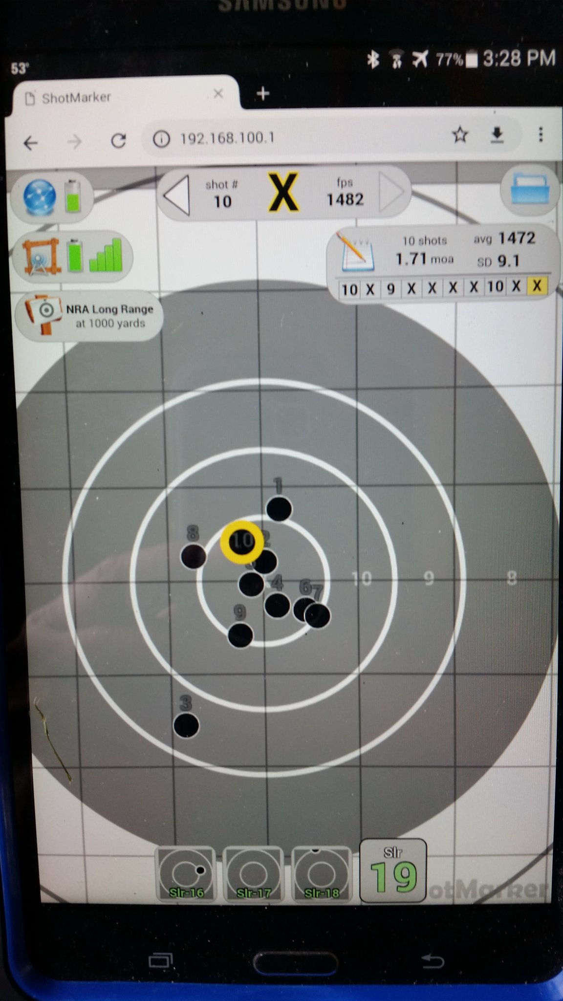

This is a 1000 yard group with the original Prime 6.5 creedmoor with my JP LRP07. It is an older factory rifle with the 8 twist, rifle length gas, 22inch jp barrel. I shoot suppressed all the time. Round count is around 1500.
