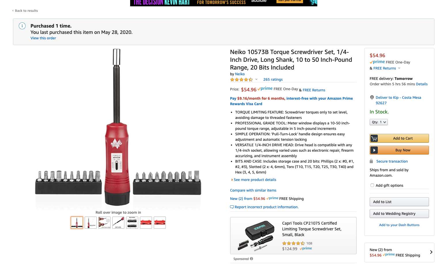

Cool. One thing I haven't got yet- an in/lb driver. Lookin at Fix it Stix.
Just ordered this........
It uses a ¼" square drive with female adapter to the accomodate the ¼" hex bits. So I can use my ¼" driver with the bits when I don't need to set a torque spec.
