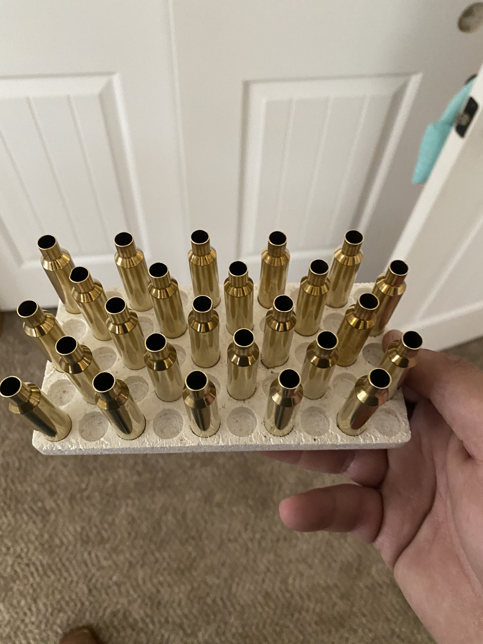

I just set my brass in the styrofoam shell holder from a 50rd box of Hornady American gunner that I cut in half. I’ll spray with hornady one shot on all four sides at a 45 degree angle to get the inside of the necks. Probably wasteful of lube but whatever. It seems to work best staggered like this for more even coverage.

I’ve tried most things and I get the most consistent (within .0005) shoulder bump from imperial wax. I’m using a SAC fl bushing die with the whidden click adjustable die ring (this thing is tits for fine tuning bump).
My fired brass process has once again evolved and now I:
Deprime
Run in 6mm expander mandrel
Put brass in 21st century lathe
Spin with rag to clean off any debris
Spin with 0000 steel wool on neck to clean carbon off
Spray one shot on neck
Run into neck turner (necks were turned when new) and this just cuts out any brass that has been pushed down from neck bushing
Spin with rag to wipe off 1 shot
Spin with 0000 to burnish neck
Anneal with AMP
Run .22 brush wrapped in 0000 steel wool into necks. This gets rid of a lot of the buildup from annealing inside neck.
Use imperial wax and bump shoulder .003 (this is what allows my bolt to fall free with gravity for this particular barrel) with appropriate bushing to undersize brass by .001 or so
Run appropriate mandrel for .002 neck tension
Dip in acetone and wipe with rag to get wax off
Spot check a few with a .241 pin gauge
Trim/chamfer/deburr in giraud
Run .22 mop sprayed with 1 shot in all necks (to keep seating friction consistent
prime/powder/seat
I use a hydro press to seat. This is my last QC check. Since I have verified .002 neck tension with a pin gauge, and used lube in case necks, everything *should* be consistent. I just make sure I’m within 10-20 psi on the hydro press. Anything too little or too much gets pulled and redo sizing/mandrel. Or I toss it in the practice pile.
Again, this is way way way more than I need to do. But I actually enjoy attempting to make perfect ammo.
