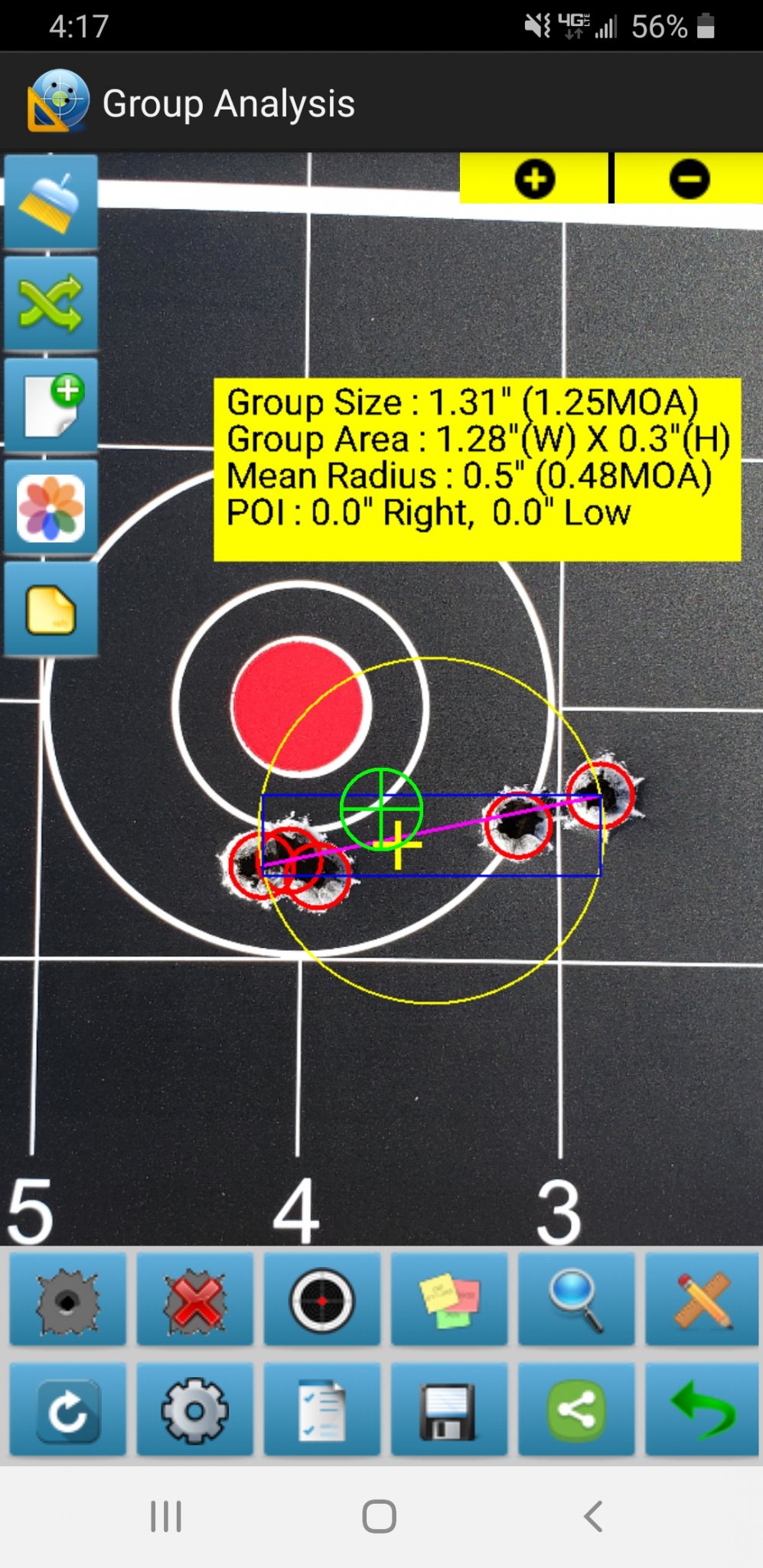

I started at .010 and went to .100 jump with 4 different charge weights, with virgin Hornady brass all groups had SDs below 13

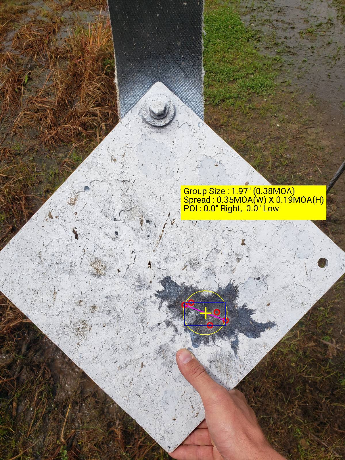

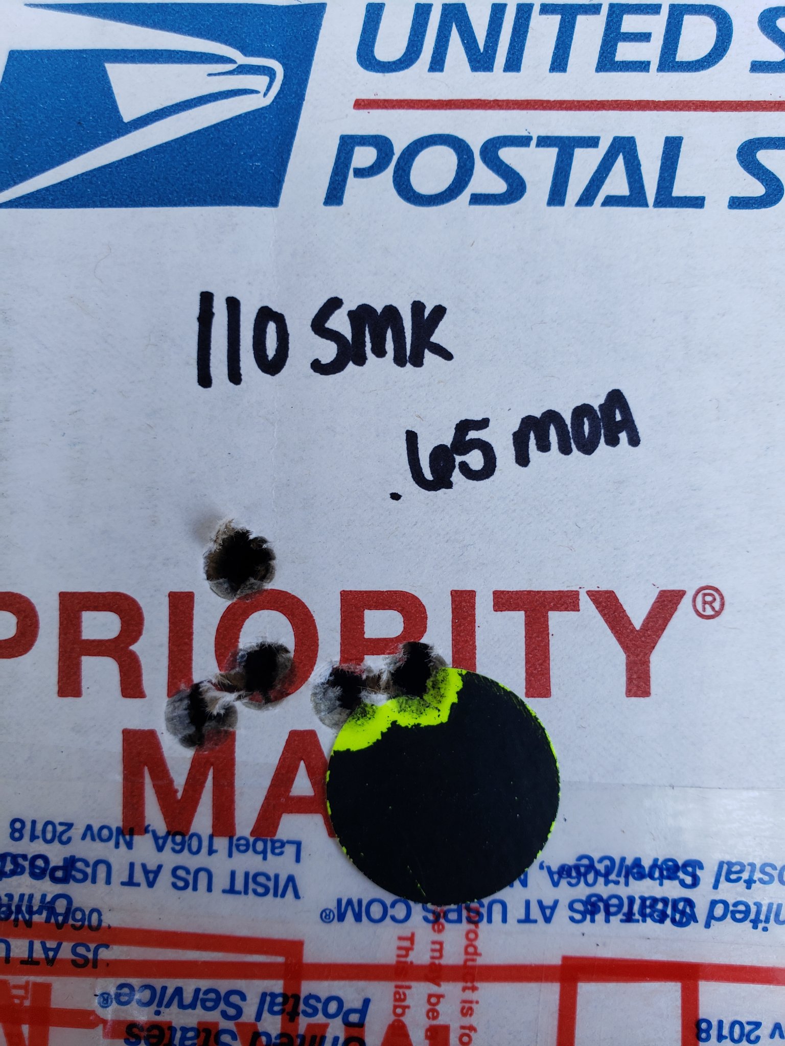

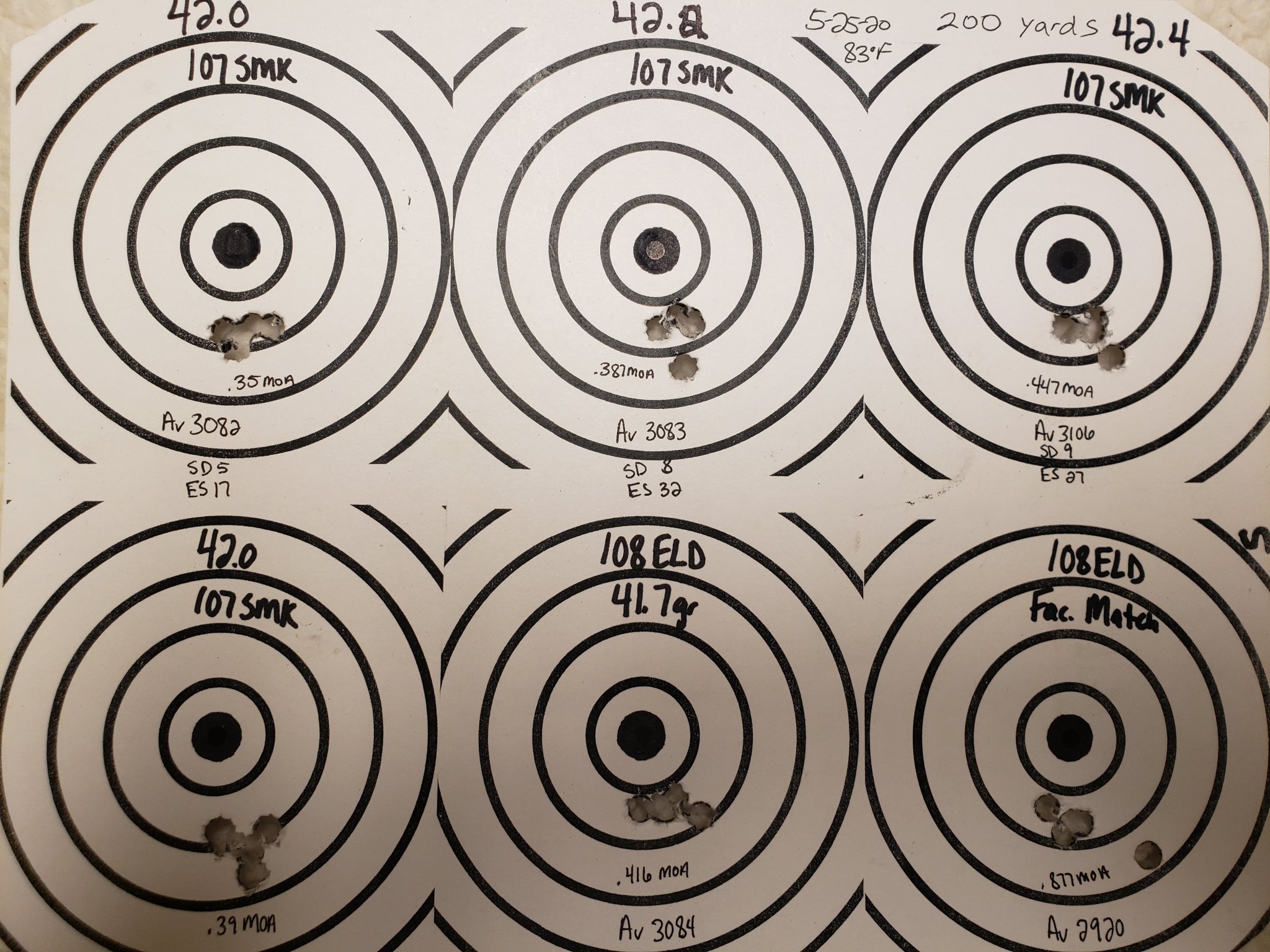

The best 100 yard group is this one, most are at 3/4 moa shot at barely over 2900 fps because I thought I'd try the low node I ignored at first. Had about the same results.

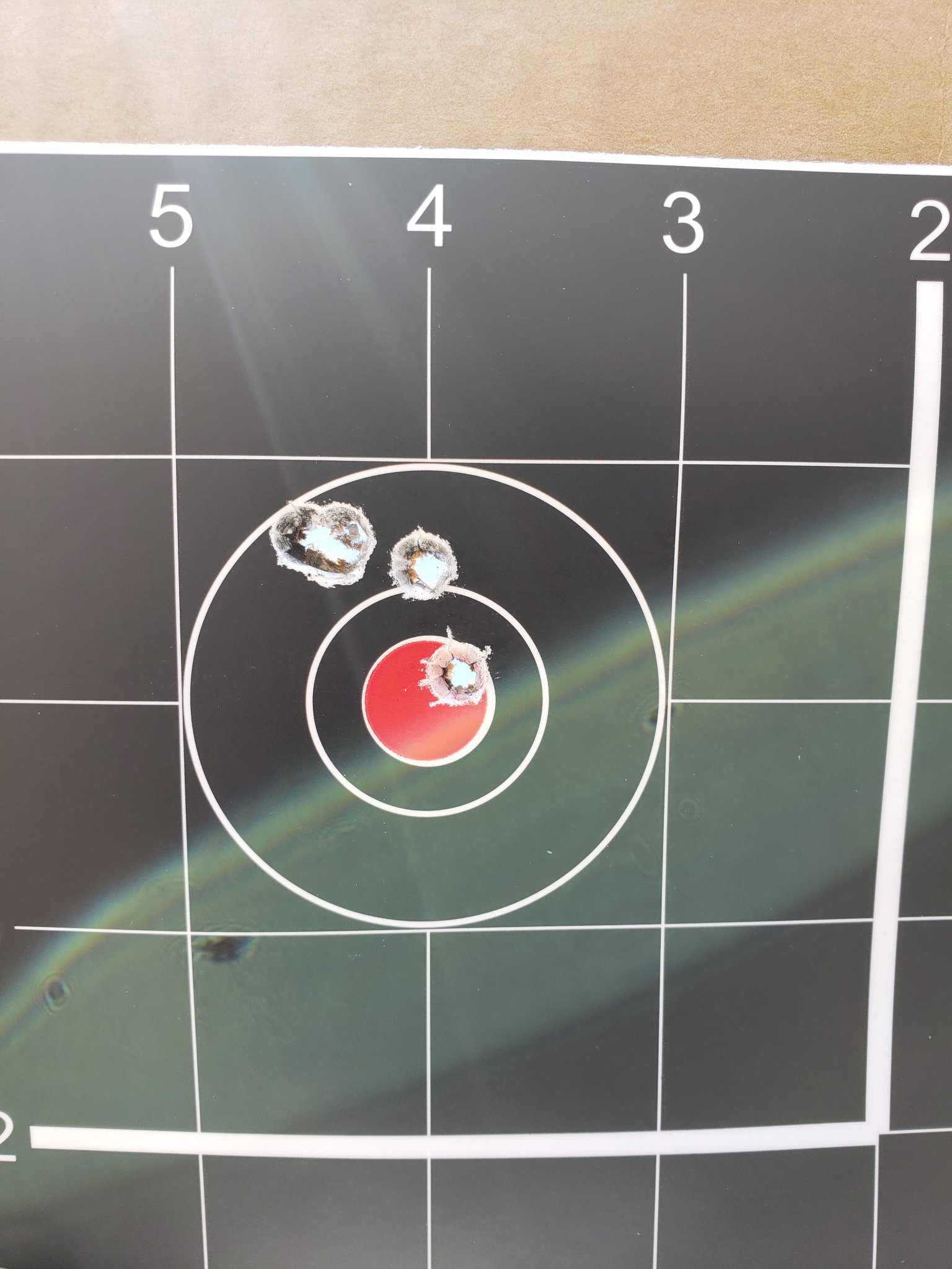

Same load shot this a different day at 100 yards
500 yards

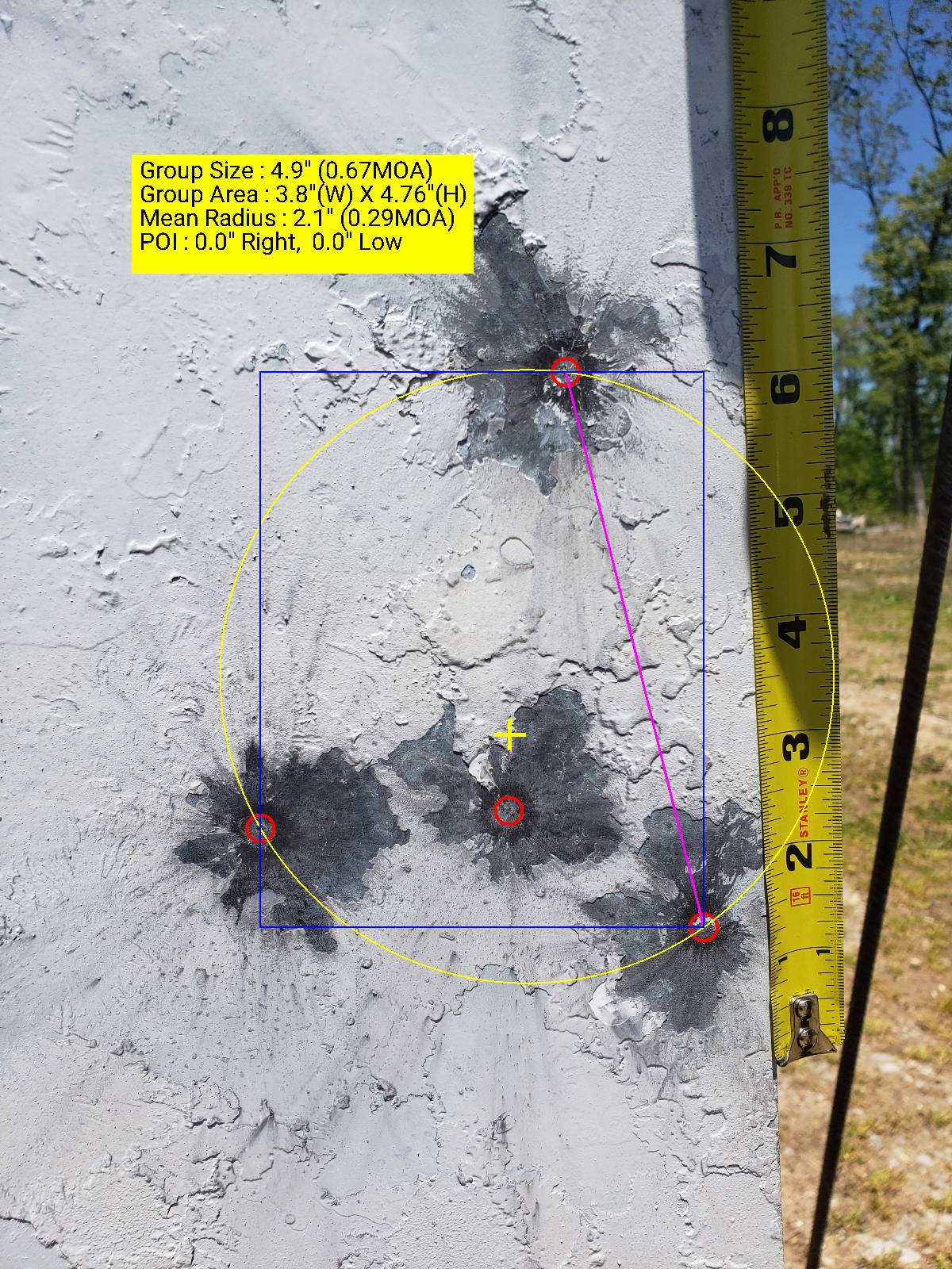

700 yards, missed wind call and only had 4 shots left for a group
I'm pleased with the groups at 500 and 700 but those are the only groups I have fired at more than 100 yards.

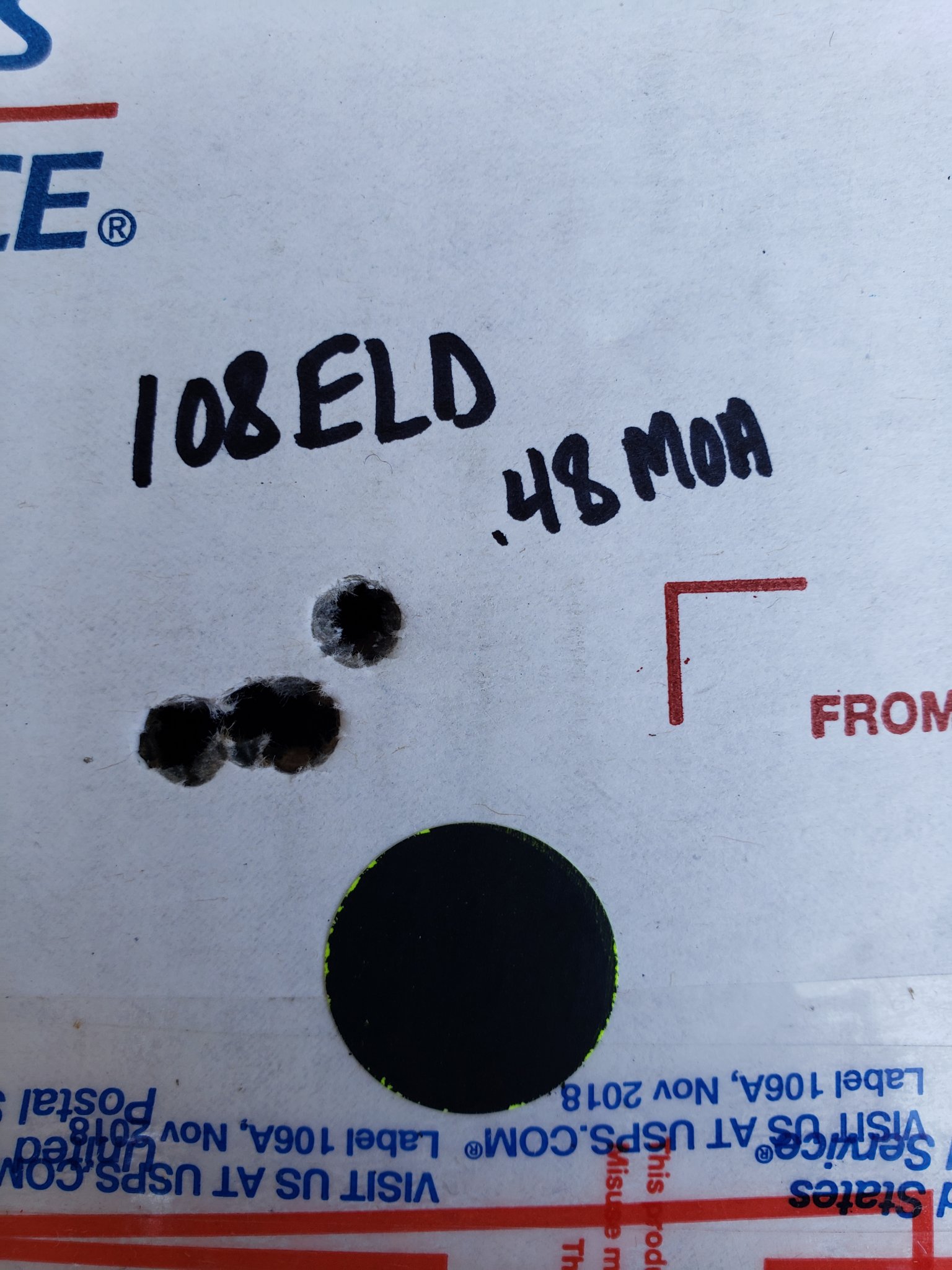

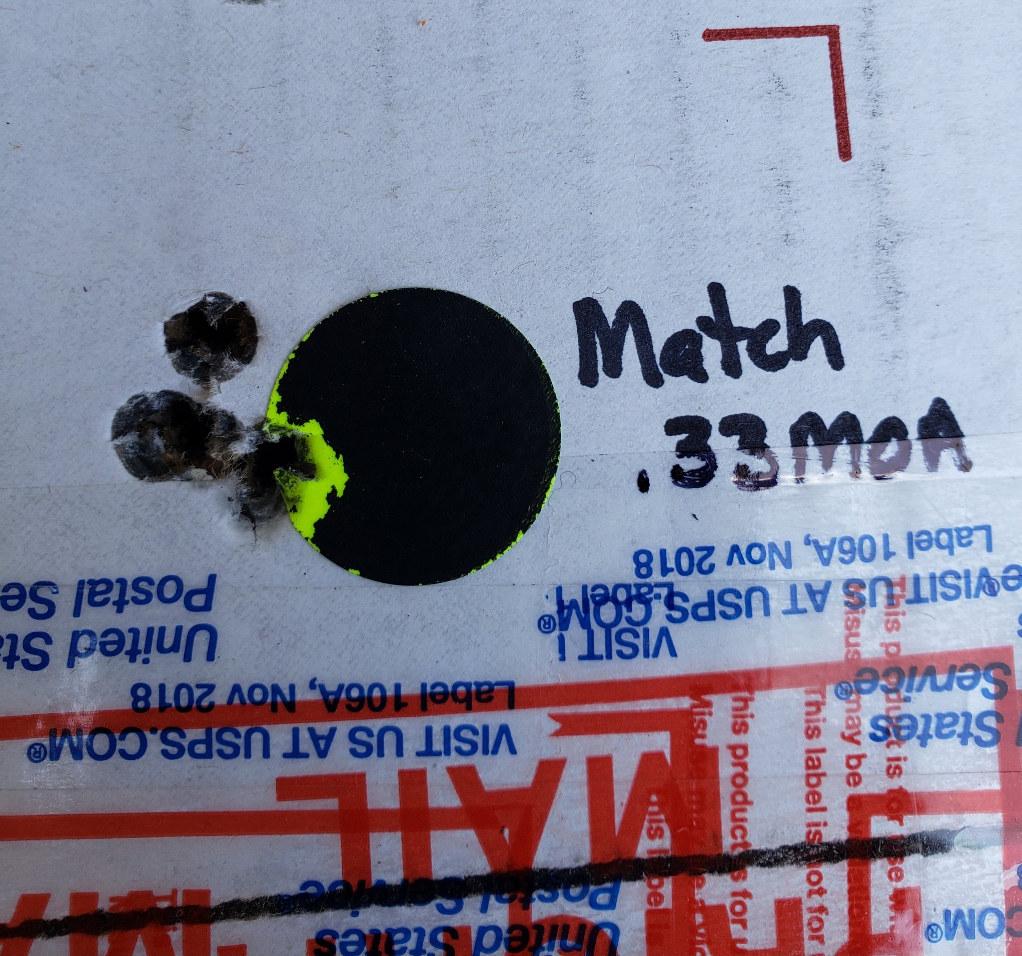

Since I was getting mediocre groups at 100 I had bought some Factory Hornady ammo (match and black) along with 108 ELDs.
I was able to shoot one group with 108 ELDs at 3030 fps, I may be responsible for the loaner. Had a SD of 6 for those 5 shots.
Hornady Match 108 ELD factory ammo, failed to turn on the magnetospeed so no velocity.

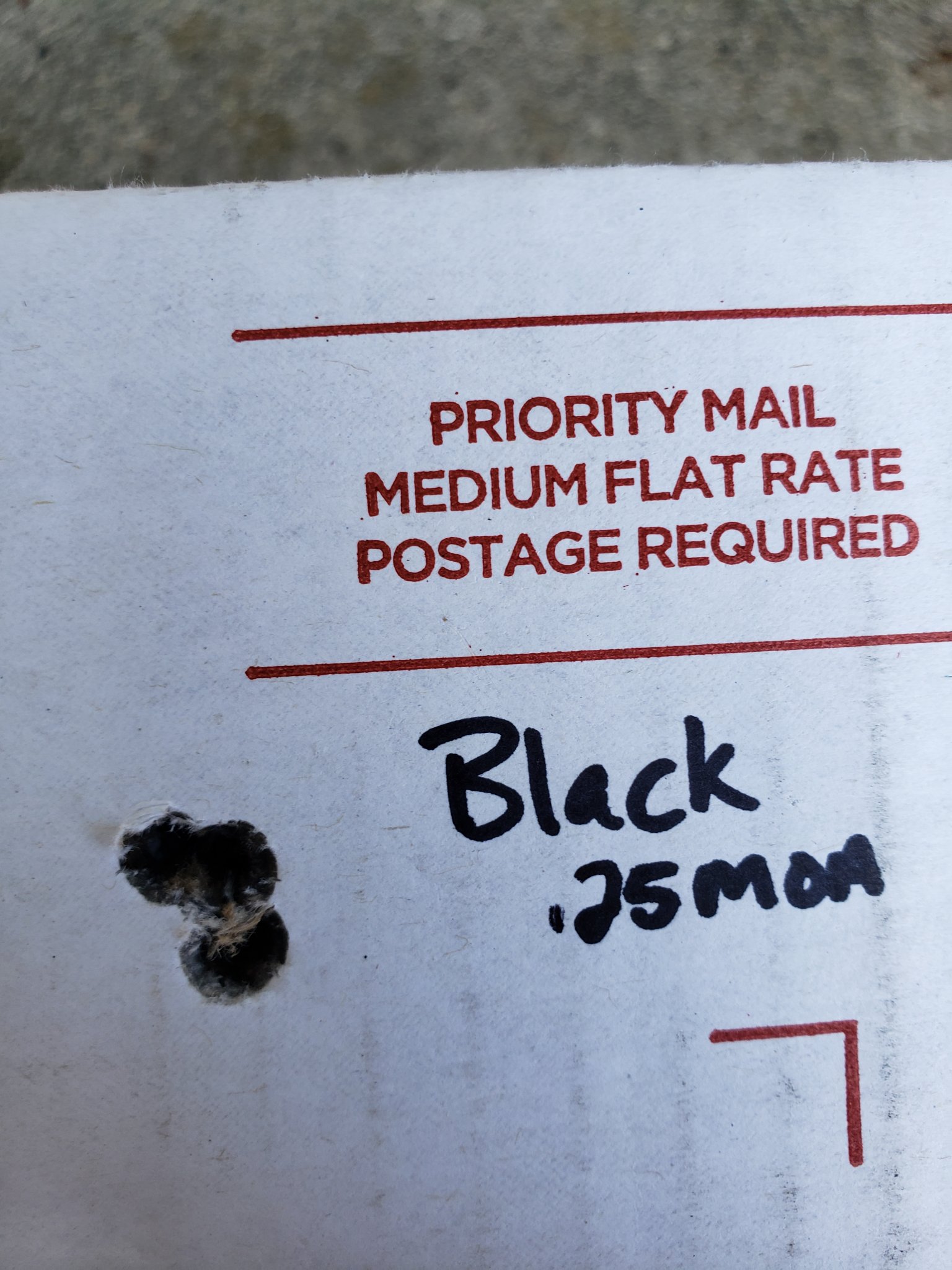

And one I couldn't believe, Hornady Black 105 Bthp, 2985 fps with ES of 57 and SD of 22.
