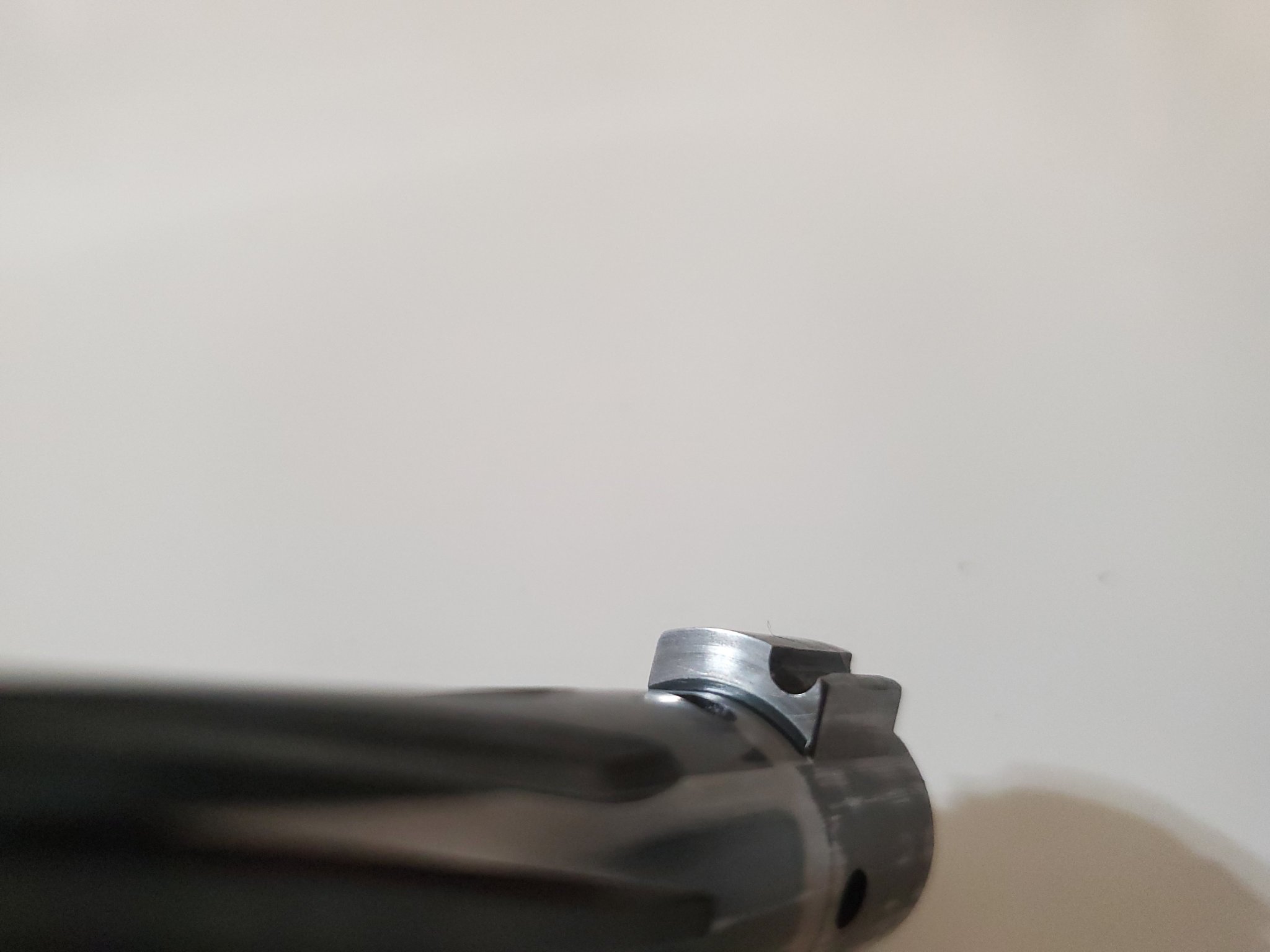

I didn't know that about the ball of metal at the end of the groove. I don't recall seeing that. I'll post some good pictures tonight.

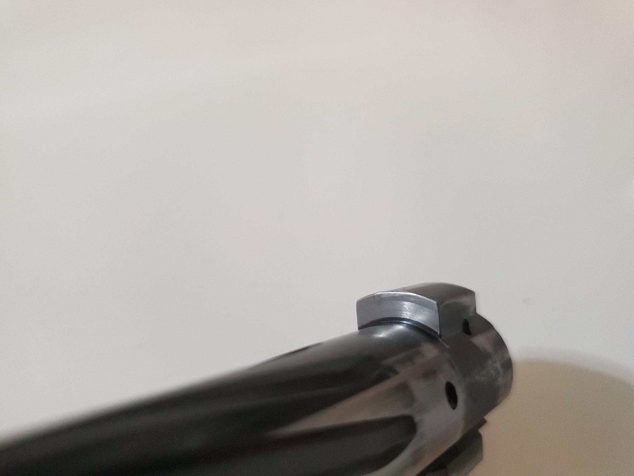

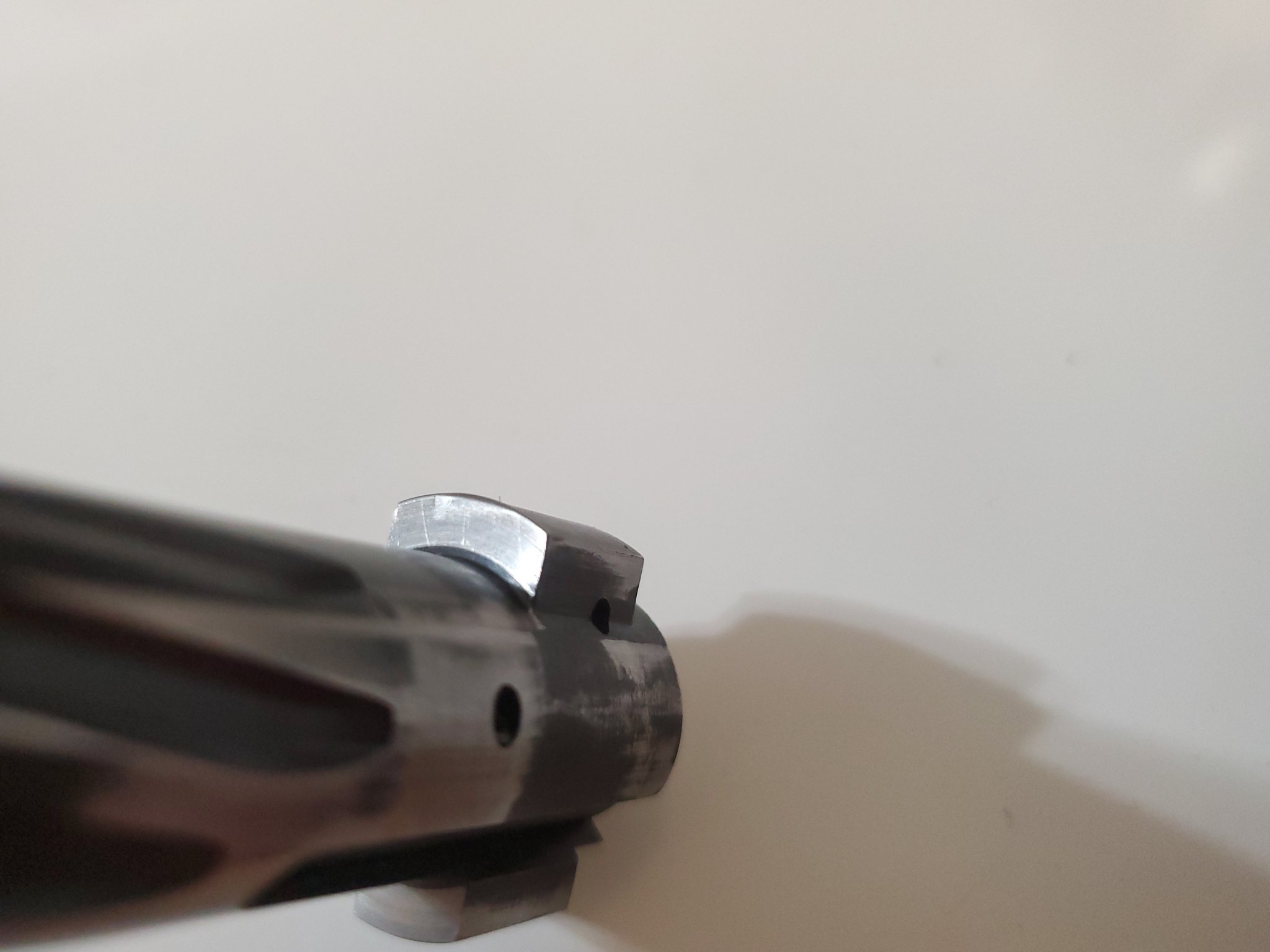

There's very small striations on the bag of the lugs that will catch a fingernail. That's nothing to worry about either?
I don't know the whole story about your rifle or have I seen it but no there's nothing to worry about based on the pics you put up.. What you feel is from manufacturing. Smooth as a babies butt is not what you want.
