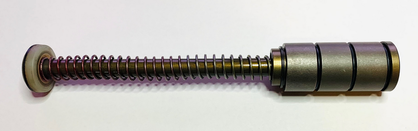

    Long story short ... I'm really struggling with finding a gas-adjustment and buffer combination that allows me to shoot my 6.5 REPR suppressed, without hurling cases out in front of the firing line and blowing out primers. First tried adjusting the gas down to the lowest non-zero setting ... didn't help. Then I tried heavier and heavier buffers and currently have the JP Silent Capture Spring (Heavy Version) for AR-10 ... which is about the heaviest damn buffer assembly on the planet.
    Currently with the gas set to "1" on my REPR, and with the JP-SC AR-10 Heavy Spring, I'm barely getting ejection at about 2:00-to-3:00 o'clock, and still blowing primers on ammo that works just fine in my other two 6.5-CM bolt rifles (both factory and handloads).
    What am I doing wrong? Am I doomed to "not" be able to suppress this rifle? Any suggestions I haven't thought of? I shoot everything suppressed, and if I can't figure this out, I'll probably sell it ... cuz I'm tired of picking spent primers out of the action.
    Anybody out there shoot their 6.5-CM REPR suppressed, and if so ... how the heck did you do that?

    Just because you put an AR10 SCS in doesn't mean it's the heaviest. I added 2 more tungsten weights to my AR-10 SCS. Now it's the heaviest SCS. The buffer portion weighs 5.5oz. And that's still not the heaviest buffer you can buy.

    Went to the range yesterday with my REPR back to the stock buffer and spring, and with meticulously constructed cartridges. Everything fired correctly, I didn't blow any primers, and the velocity was in the 2600-ish range with 42.5gr of StaBall and Berger 140's. My only remaining issue is that shooting suppressed (which is how I roll), and with the gas setting on "1", I'm still ejecting out to about 2:00 o'clock out in front of the firing line.
    Now that I have the code cracked on the right cartridge form-factor, I'm going to put the JP-SCS back in and see if (a) primer pockets start blowing again, or (b) the ejection pattern improves. BTW ... I too have the all three tungsten weights and the heaviest spring available. The buffer assembly weighs 7.8oz. Pretty sure that's the "peak" for buffer weight.
    It is for an SCS. I bought the standard weight and it came with one tungsten and had to add two more. Sounds like you're weighing the entire SCS assembly.
