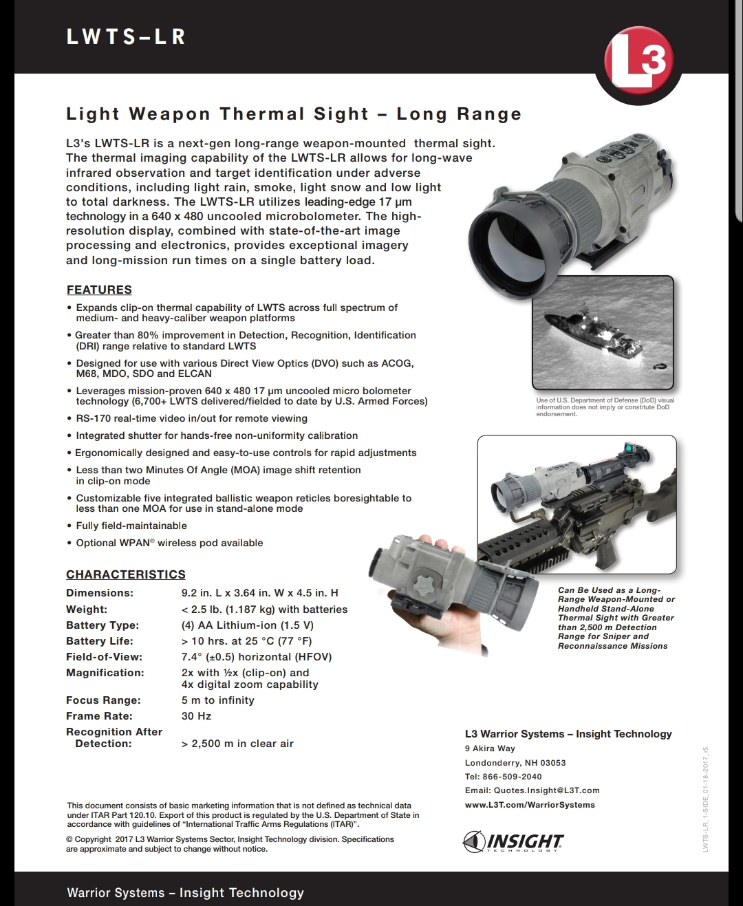

I think this is the new contender in the long distance thermal clipon space ... but as you might expect, they are not free. Though per the pricing I've seen (not allowed to share) they are not as unreasonable as you might think. I'll let DRT handle the pricing discussions :)
As to availability, I'm hearing "180 days ARO" (after receipt of order) ... though also "that may be optimistic" ... so availability not confirmed.
The LWTS-LR are 1x optics just like the LWTS ... the reduction in FOV comes from your day scope, since you can now zoom in to 8x-10x ... versus the LWTS limit of 4x-6x
Yes 1x but it still has the same sensor right? To get a useable image at higher mag that big lens on front has to provide some magnification for the sensor and then demagnify on the backside. Same principle as comparing a cnvd-lr to cnvd-lr or pvs24 to pvs30. Same or similar guts but different lens in each end.
According to the people I talked to, the demagnification is not optical, but done with the display. I am still a bit skeptical, and agree with you as to how it is generally done.
With the lwts and a 1-6 razor behind it about 2x gives me the full fov of the sensor. Trying to go lower accomplishes nothing. Sounds like with the lr about 4x is where the minimum useful day scope mag will be then.
As comparison, UTC-x with mk6 3-18x horizontal FOV 6.1 and 3x can barely see the left/right edge but can see plenty of top/bottom edge. Top/bottom edge (of display) disappears on 4x. The verticle FOV is 4.7
The lwts-lr is 2x optical 7.4 fov. Digitally zooms 4 times optical to 4x and 8x. CO mode is .5x optical (2) so takes it to unity by shrinking viewed display to half of the original display size. Fov remains 7.4 in CO mode. 4-5 x on day optic gets you corner to corner in clip on mode.....8x in your DO should be very usable. In stand alone mode the image processing, fine focus, and high grade germanium allows the image to be cleaned up beautifully in full zoom (8x digital 1.85 fov 160x120)
2500m rec after detect range. 50 cal rated. 75mm lens. 10 hr run time.
Looking forward to these finally arriving.

Thanks Wig. So the 6x you are referring to is for the LWTS-LR or just the no LR model? Also heard on the fuzz factor. We’ve spoken a couple of time about it and I’m slightly more adverse to fuzz than you from what I can tell. But still able to tolerate it.
Id say that 8-10 x will be very doable with the lwts LR. Thats a lot of mag with pixels and you are really getting narrow on the fov at 10x. Id say about 2-3 degrees at that point. I signed back up as a sponsor/comm seller on here. I have several LRs arriving summer time frame. DM me.
here is the sell sheet with specs...fyi these have actually been out in the field with DOD end users for a while and was in the 2016 LE catalog. Just recently did it become available to order through eotech (non mil) channels. Unfortunately it's a 6 month quoted lead time.
