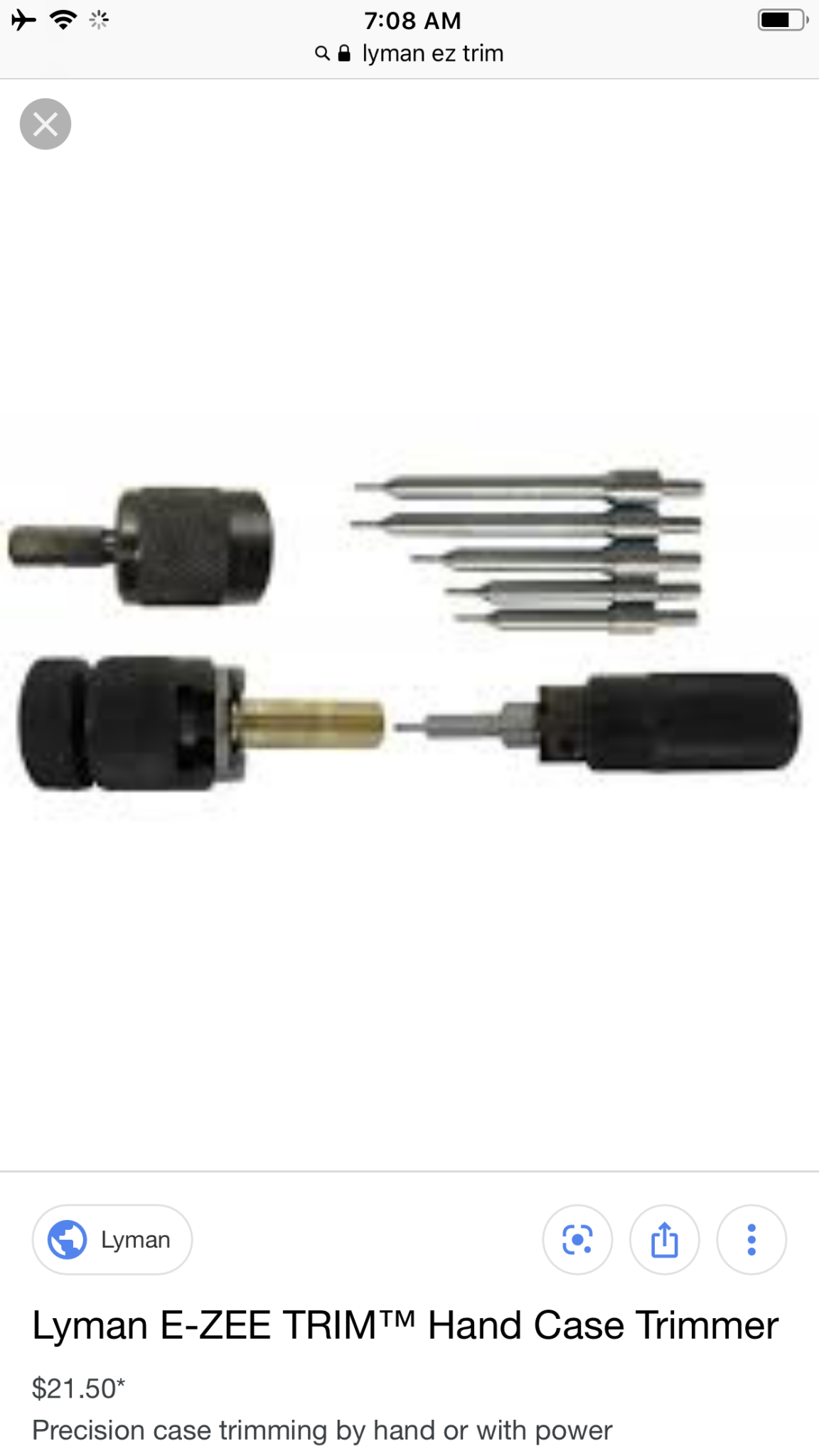

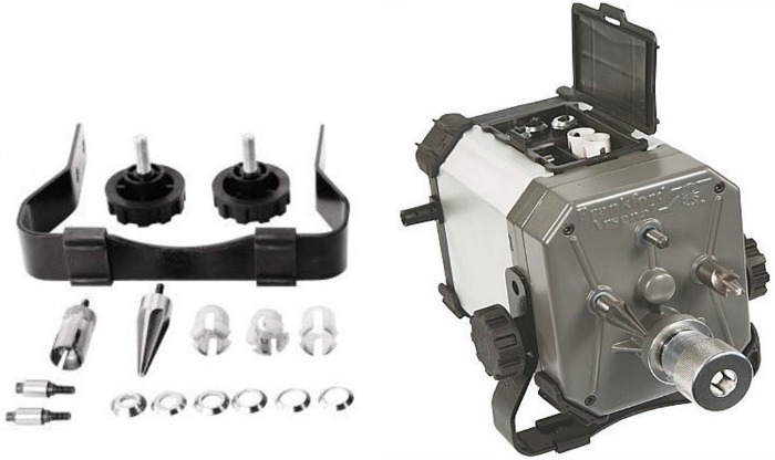

    If you have the manual lathe with the three way cutter already then I would just get the drill adaptor as well.

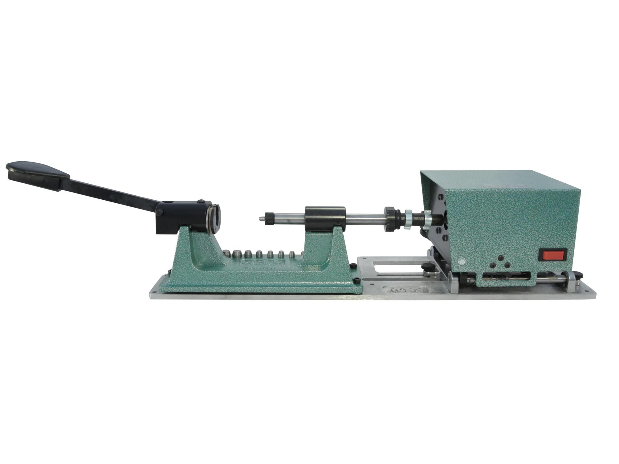

    I was considering setting it with some sorta driver or RCBS's Motor, but yeah, for some reason I'm not into their Trimmer Station. It's not the Trim Pro 2, it's the original.........

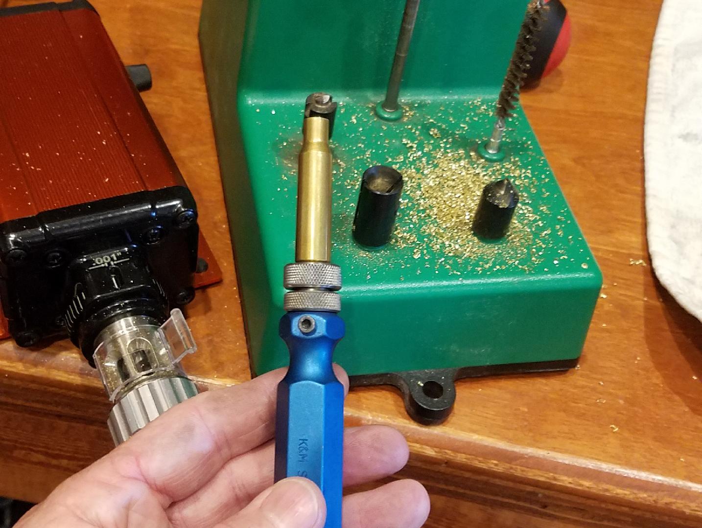

    Gonna resurrect this, I recently purchased the Lyman powered trimmer,but after using my fingers to push the brass against the hard ass springs and bushing a hundred times or more in a sitting ,I'm getting gnarly blisters even with gloves on.
    The trimmer does a decent job but goddamn it takes some force to push the brass in and make contact with the cutter.
    I see you have a handheld shell holder setup that would probably eliminate all the problems I'm having.
    Is that something that can be bought or did you custom make it?

    I think the blue handle and shell holder is from K & M tool. I have a number of their products and they’re the cats ass.........
    Reactions: Pilotscrappy
    Yep, it's the K&M handle with case holder. Works like a champ as long as you slide the rim all the way into the shell holder.
    I set mine up where the opening is up so that gravity slides the case all the way in. 1/8 of a turn and it's locked into place.
    Trim away.
    You can even leave the case in the holder to chamfer and deburr.
    If you are doing flash holes and primer pockets, the case has to come out, of course.
    Note: you will get more consistent trim length if you slightly rotate the case after the initial cut. It forces the case mouth to square up.
