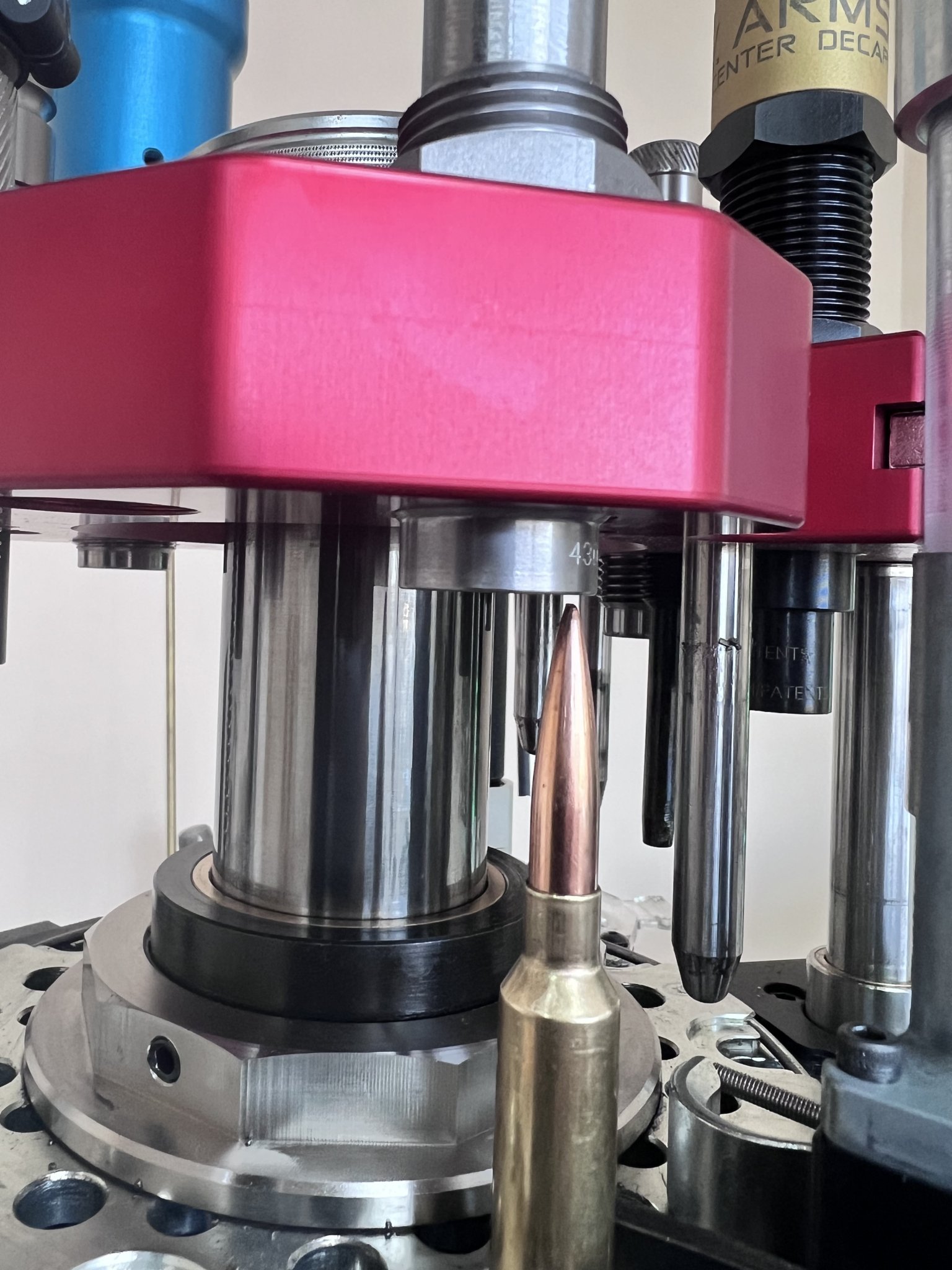

What's the actual max coal you can load on the mark 7? All the info just says 308, which is not helpful
2.800” is spec per M7, but M7 has loaded 6.5 Swede and there’s a guy on YT loading 7.62x54. I tested for max COAL using a Lyman Pro Seater and got 130smk out to 3.000” without issue (could probably go out to 3.050” if I backed my seater out another rev). Any seater with a sliding collar will be much shorter though. The shell plate begins cycling before the tool head has reached “TDC”

wow, that’s a close fit
That cartridge is loaded to 3.000", any short action cartridge will have plenty of clearance with the proper seating die
