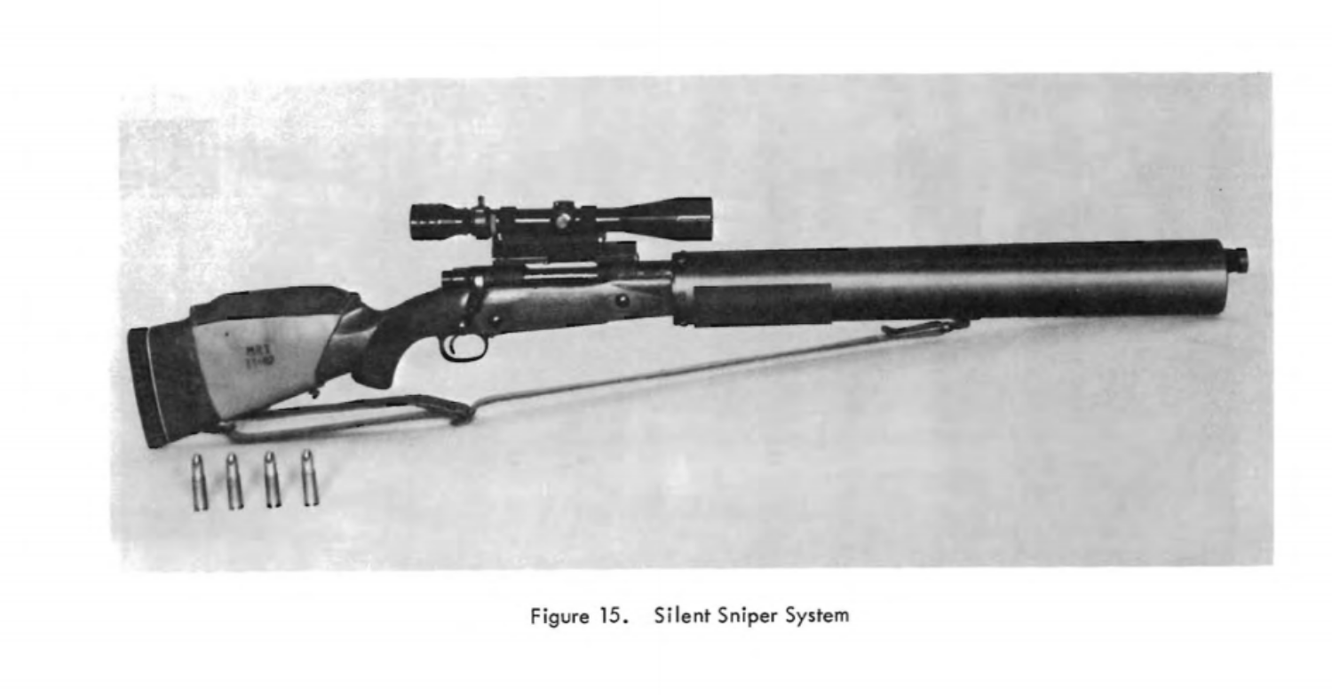

MTF...the weapon your dad might be talking about appears on page 76 of the book "Quiet Killers" by J. David Truby. On page 76 there is a picture of a suppressed model 70 that was sent to Vietnam for testing. I couldn't find a picture on the internet, but the photo is captioned as follows:
"A mighty sniping weapon (above), this Winchester Model 70 in .458 caliber was fitted with an APG silencer, and shipped to Vietnam for testing. Results from the field remain classified."
The weapon is huge, with about a 5" diameter shroud type suppressor the entire length of the barrel from rifle stock for-end to muzzle. It has an ART II scope.
MAC (Military Armaments Corporation) provided many one-off special mission weapons to SF. Page 47 of "Quiet Killers" shows a photo of a bolt rifle I can't positively identify, with a Sionics suppressor, being tested by a 5th Gp soldier.
The suppressed weapon i remember the "Sneaky Pete" types fielding the most was the Swedish K. Seemed to be a fair number of them around. A suppressed Hi-Standard would have been handy as pockets on a shirt. That would have been an outstanding rat killer.
[IMG2=JSON]{"data-align":"none","data-size":"full","src":"https:\/\/i.imgur.com\/Msq1Rltm.jpg"}[/IMG2]
MTF...the weapon your dad might be talking about appears on page 76 of the book "Quiet Killers" by J. David Truby. On page 70 there is a picture of a suppressed model 70 that was sent to Vietnam for testing. I couldn't find a picture on the internet, but the photo is captioned as follows:
A mighty sniping weapon (above), this Winchester Model 70 in .458 caliber was fitted with an APG silencer, and shipped to Vietnam for testing. Result from the field remain classified.

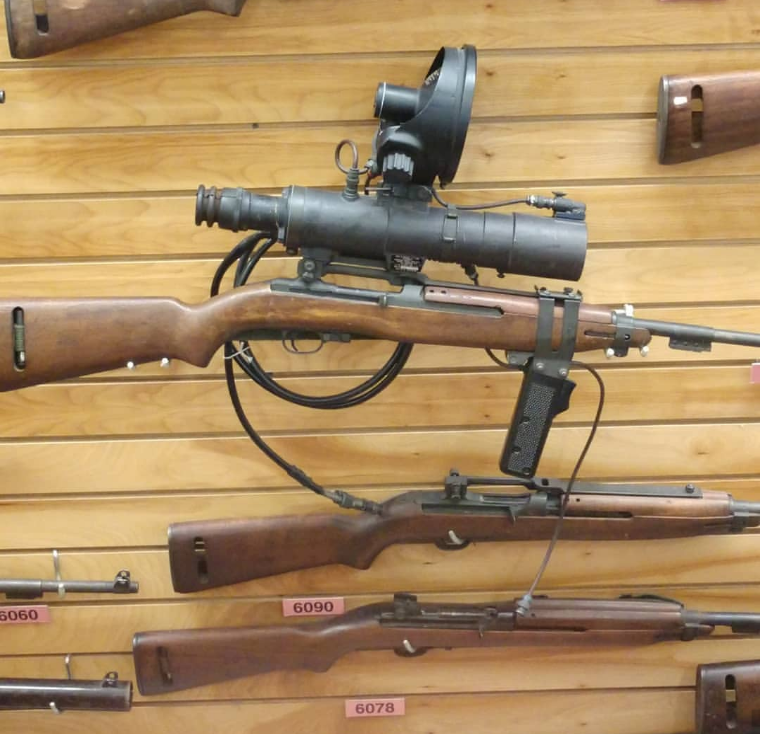

I thought the starlight deserved a pic in this thread:

The AN/PVS 1 was the same IR set up that was used on the M3 carbine. There were a few but not that many, the AN/PVS 2 was much better an much smaller as well. The clarity sucked in the 1 an was not much better in the 2, the 3 was light years beyond both. Tanks an PC's had the same IR capability, an you could drive off a cliff an not know it until it was to late as there was no depth perception at all. M3's/AN/PVS 1's were just a shade better than nothing, but not by much.

The PVS-1 and the PVS-2 are almost identical in size and weight. The main differences were that the
PVS-1 had internal axis/azimuth adjustments on the crosshairs. The PVS-2 had adjustments that
required that the whole scope had to be moved up down left right . Both were mounted to the left of the centerline of the rifle. An awkward arrangement for most troops. Both are still excellent night vision with the penalty of a lot of weight. They used a cascade tube arrangement that fed 3 Gen I tubes off one another to produce exceptional gain(brightness) and definition(lpi). The PVS-2 still sells well today.

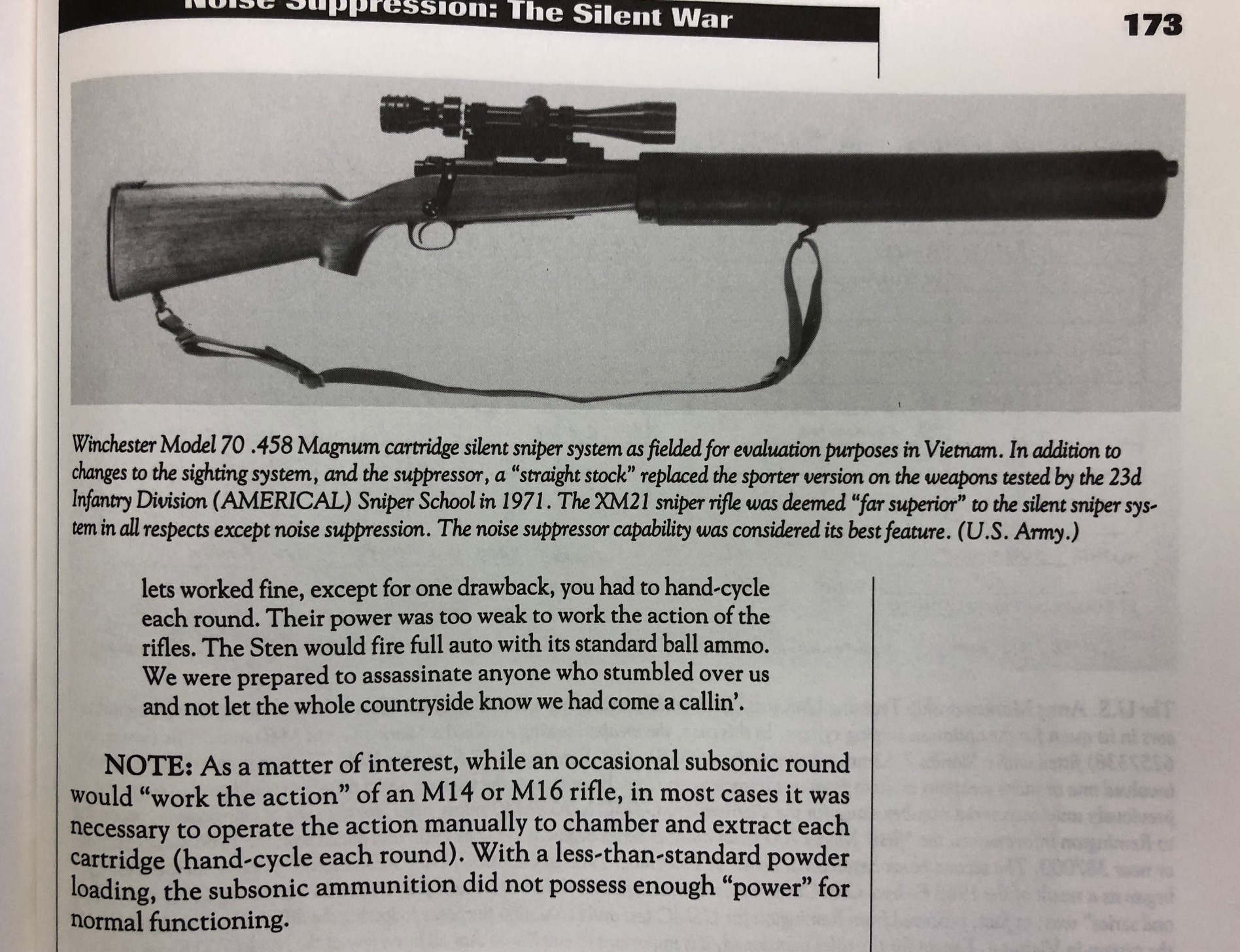

I found several thousand pages of classified sniper docs from Vietnam at the Archives. Both for the Army and USMC.
Everything in the classified Army documents on fitting night vision and the Suppressor by Sonics were on the XM21.
For the USMC, it details all testing was on the M40.
Really after 1967 I never see any mentions of the Model 70 with either the Army or Marines in any of the official documents.

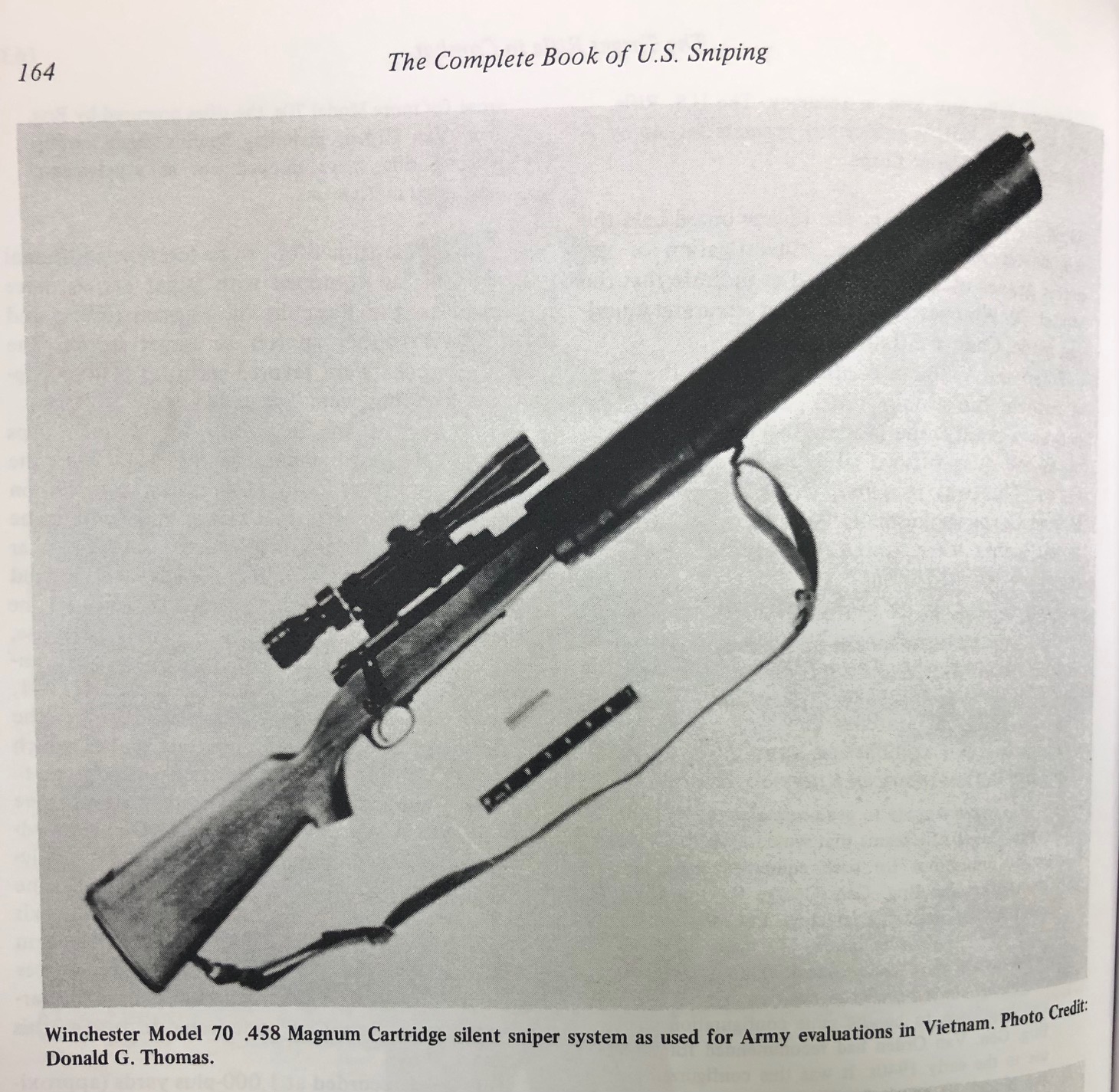

any idea on providence or caliber?
Peter Senich's book has a picture of one (attached). The Complete Book of U.S. Sniping. His book notes that 5 of these rifles were built by the US Army Limited Warfare Laboratory (USALWL) and tested in 1971 in Vietnam. The ammo was specially designed, a shortened 458 case that prevented use of the full size cartridge "for safety reasons.". It was designed to be subsonic. Two of the five rifles were tested in the field/combat in the spring, and it was determined that the XM21 was a superior sniper rifle in all regards, except noise suppression. That's about all I have ever seen re that bizarre rifle.
Peter Senich's book as a picture of one (attached). The Complete Book of U.S. Sniping. His book notes that 5 of these rifles were built by the US Army Limited Warfare Laboratory (USALWL) and tested in 1971 in Vietnam. The ammo was specially designed, a shortened 458 case that prevented use of the full size cartridge "for safety reasons.". It was designed to be subsonic. Two of the five rifles were tested in the field/combat in the spring, and it was determined that the XM21 was a superior sniper rifle in all regards, except noise suppression. That's about all I have ever seen re that bizarre rifle.

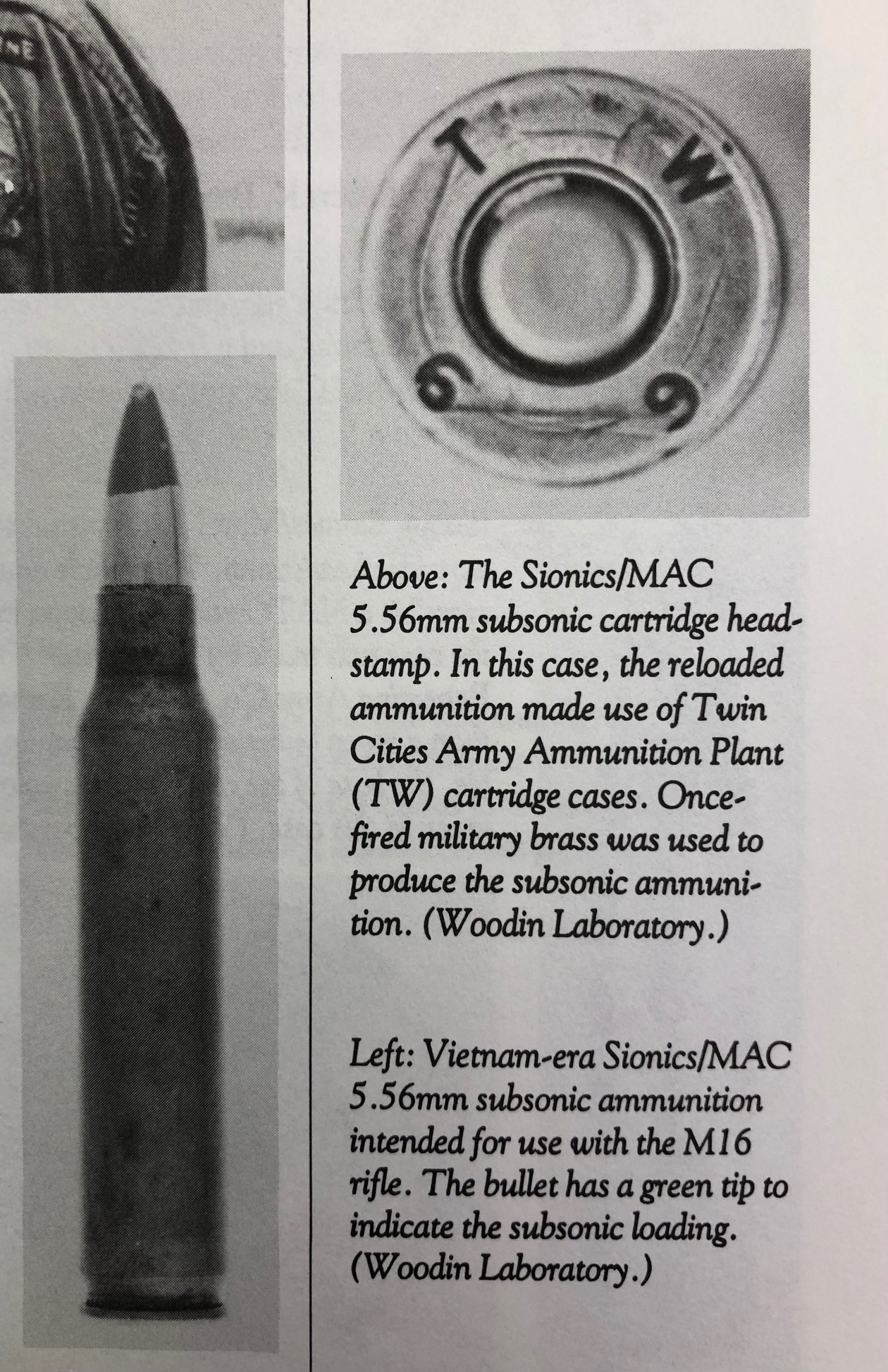

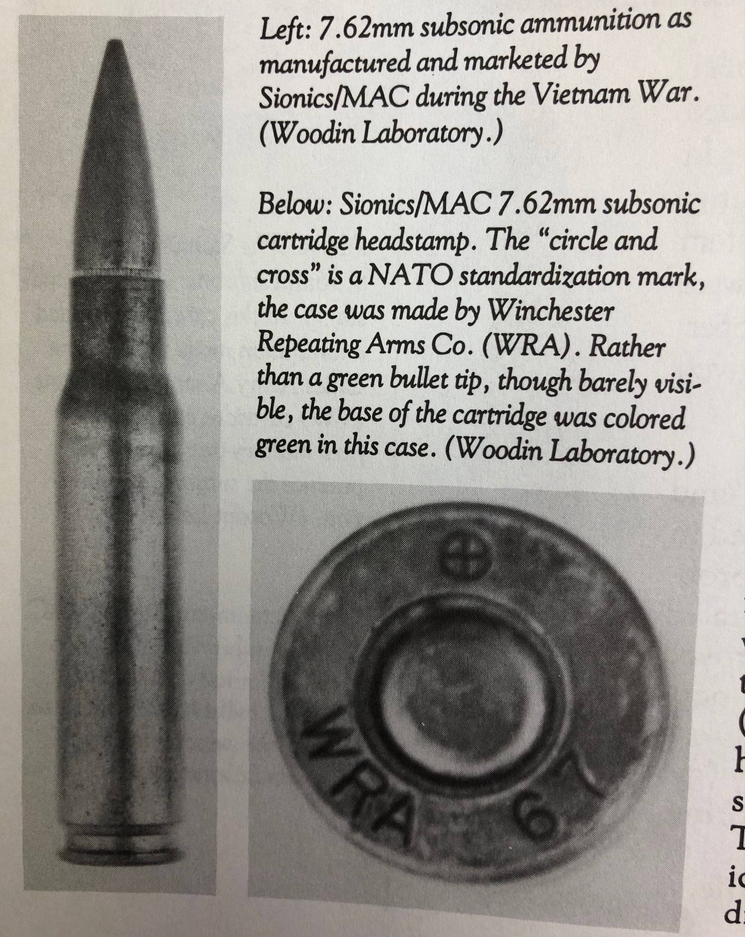

A true story. One of the things that absolutely pisses me off is while testing new and groundbreaking equipment, it gets canned because of some REMF who doesn't understand the needs of why the new equipment is being tested. The XM-21 was tested in a standard battelfield environement, where, YEAH, it's gonna win. But, the point is the 'new' equipment beat it in the one category that was really needed. Taking out a sentry at 200m is quite doable with either rifle. But, the XM-21 is gonna fail because it has supersonic ammo and that will negate taking out a sentry and not raising alarm. The subsonic .458 can reach out to 500m and still kill. But it's going to take a lot of trajectory. So, the testers say it can't be done... It can, it just needs sight modifications.
The other part that pisses me off is the people who can it because they don't understand (worse: do understand and don't like it) are the ones writing the after-action reports that are as false as me being 6 1/2' tall aaaaannnnd good looking. Not true. But, they publish those reports like they are real and big Army stumbles over it's own ass again.
I stand corrected, as I knew I had seen more about that rifle, and sure enough, Peter Senich's excellent book, The Long-Range War (1996) has a bit more info (see attached pics). I think the rifle was 14.5 lbs and 45 inches long, so that's a bit of a drawback, and according to one old-timer, the suppressor technology of the 1960s-1970s-80s was immature and accuracy suffered quite a bit until new designs came out in the 1990s. He said they were really only good for "close-in work" - but he didn't specify what range limitations were.
Two things, per Peter Senich's book, a good amount of subsonic ammo in 5.56 and 7.62 was used in Vietnam by "US Army Rangers, Special Forces, SEALS, Recons, and LRPs." The regular Army and Marines didn't really use it, but it was indeed used by certain soldiers/units. The problem was cycling in the M14 and M16 was an issue (see last 2 attachments of ammo made by Sonics Inc and provided with their suppressors in Vietnam). The innovative 'pressure relief valve' on the Sonics M14 suppressor was supposed to allow for variances in ammo type (and allow full-auto fire too, if needed), but even then I suspect manual cycling was often required with the 7.62 subsonic ammo used in Vietnam. A lot of experimentation occurred, included some suppressed M40s as well (but not used by the USMC). My understanding is that large POI shifts and a drop in accuracy were persistent challanges.
As for the Vietnam era experimental 458 subsonic round (low velocity with a 500 grain bullet), my guess is it had to be aimed like an artillery piece once you went past 100 meters - if that. I'm sure its ballistic trajectory profile was rather poor, and as the old timer noted re suppressors of that era, probably only good for "close-in work". Accuracy or range data is not found in Senich's book re the .458, but apparently the suppressed XM21 was more accurate.
If I understand the history correctly, it wasn't until Knights Armament and Crane partnered up in the mid-1990s to test and develop sound suppressors that were really suitable for a semi-auto sniper rifle by allowing 1 MOA precision - even with a suppressor. (The result was the sound suppressor on the Mk 11 Mod 0 rifle, which took several years to develop, and was later used on SOCOM's 300 WinMag bolt action sniper rifles). During this same era of the mid-1990s, I think Phil Seberger and Ron Allen developed various Ops Inc sound suppressors that also worked well for accurized 5.56mm M16s, and were adopted around the year 2000 by Crane for the SOCOM SPR Mk 12 rifles, etc. Prior to the advancements in the 1990s, huge POI shifts were common and precision accuracy more or less went out the window....
So, there weren't any accurate 500 meter capable suppressed sniper rifles in the 1960-70s (and probably 1980s too). Sound suppressors have come a long way in the 21st century, but back in the 20th century they didn't work esp well for a sniper rifle, the XM21 being perhaps the best compromise, but it still doesn't compare to today's technology, at least that is what a retired 1st SFG SOTIC instructor implied when we corresponded over this topic.

I've had a PVS-1 for a while, finally finished an M16A1 clone to go with it. The unit still functions and came with a battery insert to run something more common (I have no idea what, still need to figure that out). I keep it on display in my basement bar with the humidors, seems like a good place for it:
