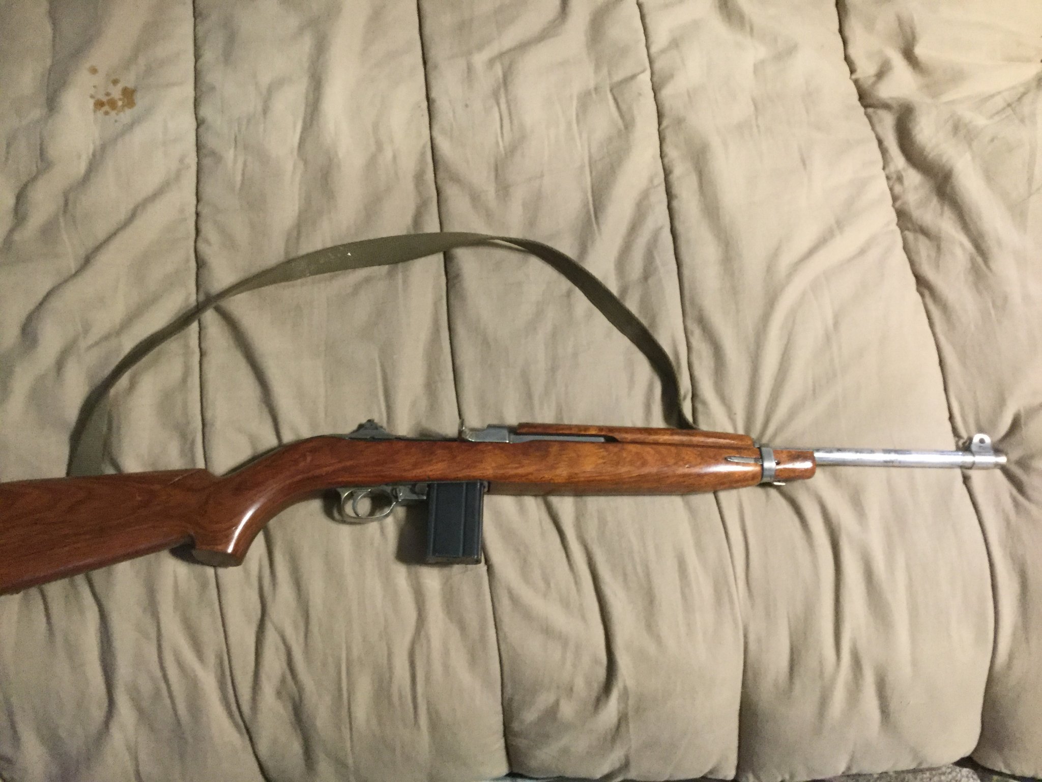

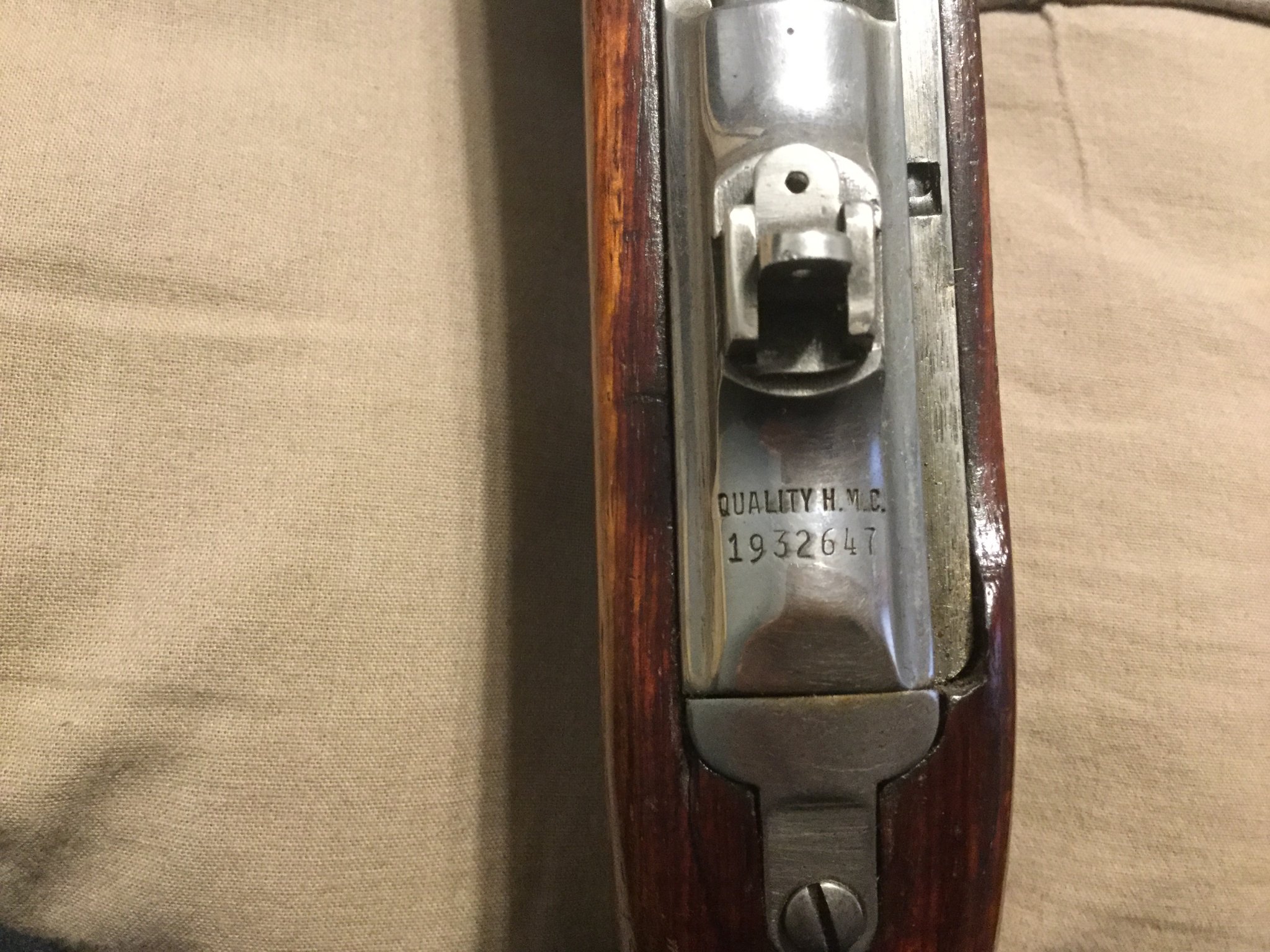

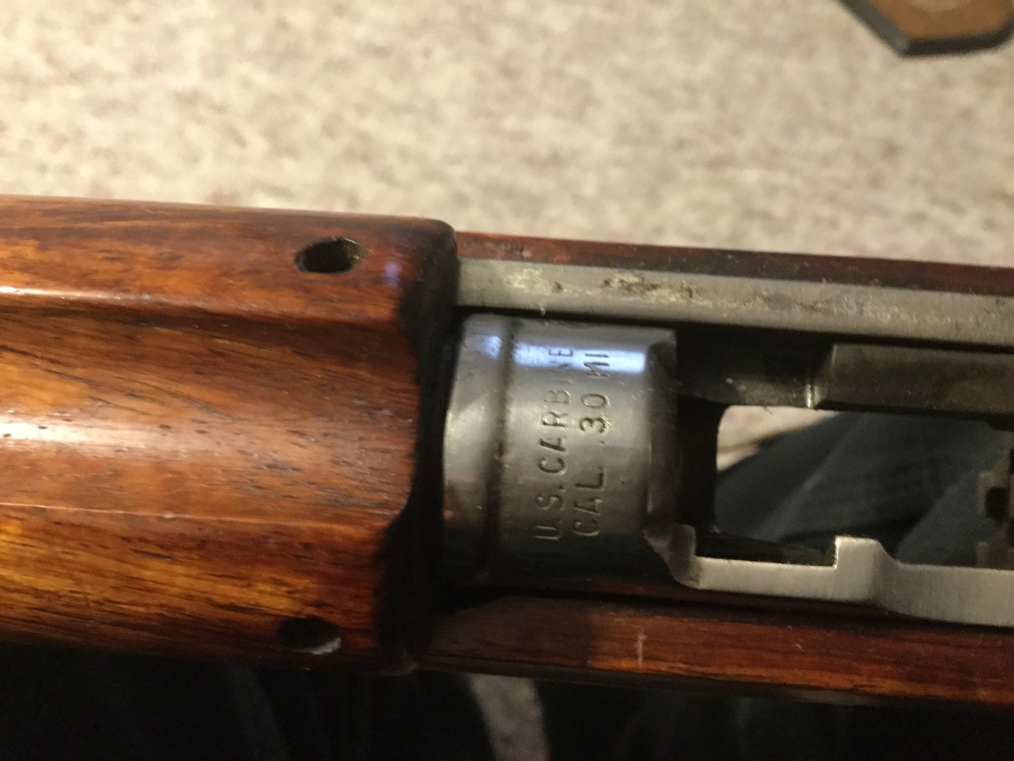

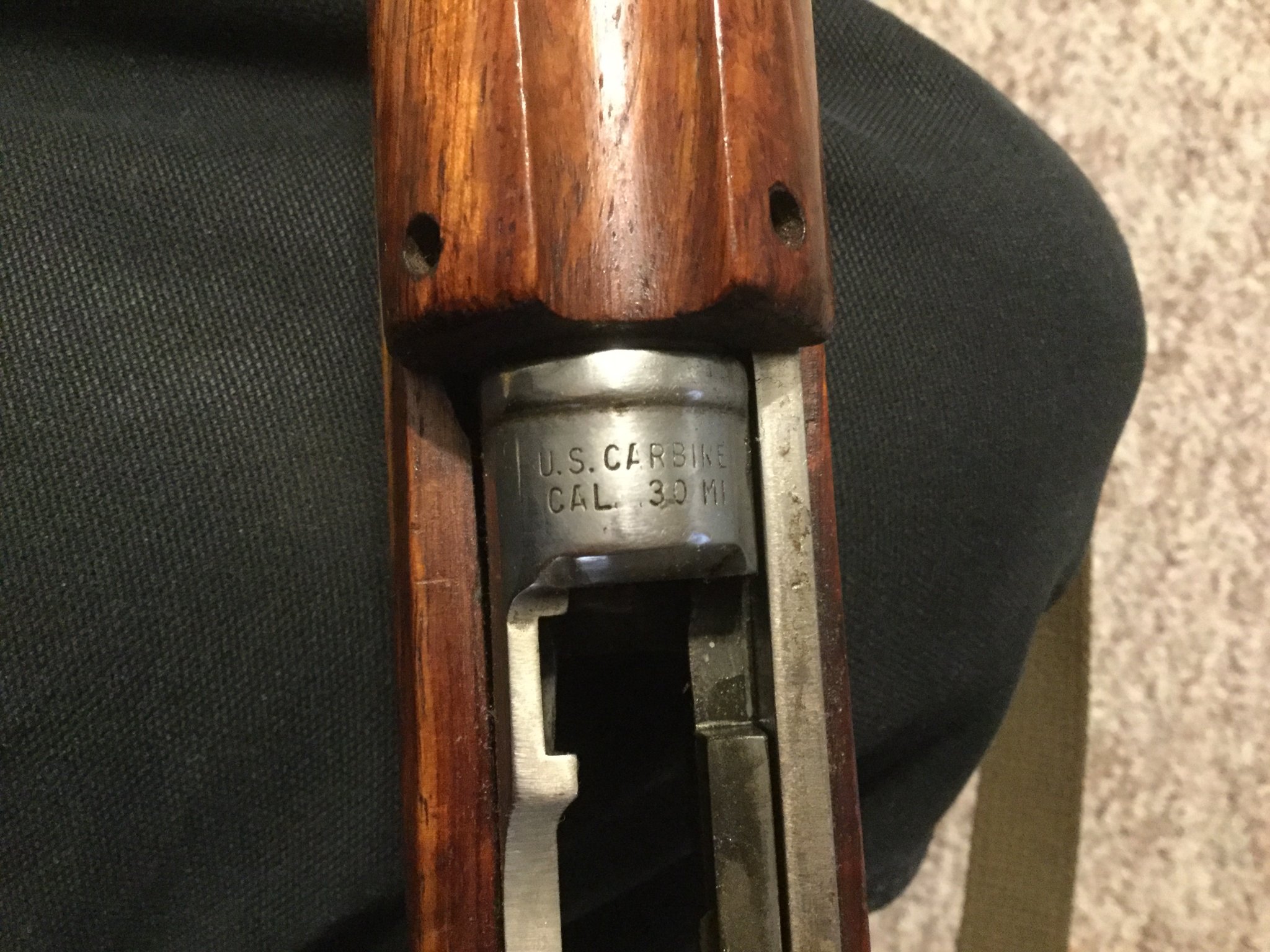

I'm doing a restoration on an M1 Carbine (I know, I know...); a Plainfield. It's got some nice looking wood, and will be getting the oil finish treatment; but first, I'm cleaning up and reblueing the metal.
The Trigger housing and front sight look like they have some entrenched surface rust. But on closer inspection, they look like it's some sort of copper wash underneath the metal finish (Blue?).
Not sure what I'm looking at here. Can anyone enlighten me?
Greg
Been here 19 years, and I've never done pictures...
But I do thank you for taking the interest.
After applying the Brownell's 44/40 Cold Blue, the finish is getting darker. So, I think the question is becoming moot.
Greg
Reactions: Foul Mike
Greg, I have a Plainfield M1 "paratrooper" carbine and on it there are places on the trigger housing where the copper brazing is pretty obvious, but I don't see anything like you describe on the front sight. Maybe just some sloppy workmanship from Plainfield or different parts lots? Earlier ones used a mix of Plainfield and USGI and later ones were all Plainfield IIRC.
I've seen the copper brazing on M1 Garand parts before. The lower ferrule on the front of the stock, and in other places around the trigger guard. I haven't inspected my carbine close enough to remember seeing it on that rifle, though.
Yes, the brazing is visible; it's not what I'm talking about. The entire trigger housing and front sight wraparound/wings appears to have a deposition of something similar looking to copper wash, underneath the black/blue finish.
As I said above, the question is probably moot. The 44/40 Blue is covering, and the resulting finish is acceptable. This work is being done for a friend at no cost, and I'm not gonna let it get me knotted up.
Greg
Greg
Heat treated parts are sometimes wrapped in copper foil during heat treating. During the process, some copper can end up deposited on the surface of the heat treated parts. Could that be what is going on??
Cheers, Sirhr

BTW, the Carbine in question is waiting for the final coat of Tru-Oil finish to cure. There are some sundry small bits that will receive a coat of blueing (Brownell's 44/40 Cream), and the major parts will get a second one.
Greg
...Aaaand..., PS:
Someone broke a screen trying to get into the house today at 6AM. It's repairable. It was raining hard.
Good thing for them, they failed.
New lights are going up today. It's for their own good; wouldn't want a trespasser to trip, or anything....
Thank you. That was back around '95, FWIW. Been plenty more under that bridge since...

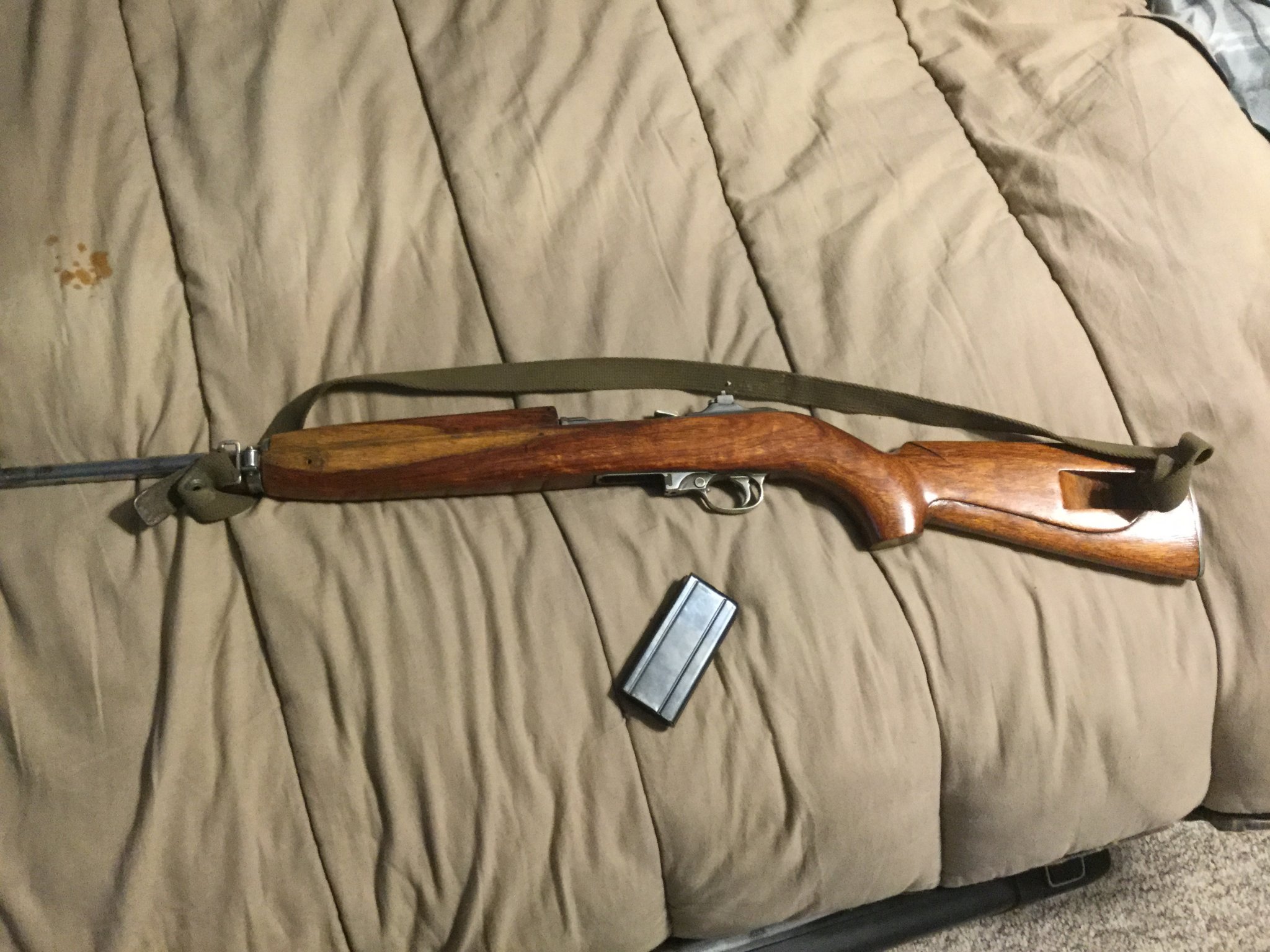

As of this moment, the blueing is done, all of the stock metal except the band retainer leaf spring is reinstalled, and final assembly is simply waiting for the Tru-Oil to harden up.
It's going to be a nice one.
Greg
The carbine is done. The 'last coat' wasn't. I cut everything back on down to the wood with #3, #0, and #0000.
One drop of oil applied in four places on the stock, palm rubbed out until it was even, dry to the touch. There is no grain visible in the reflection of light off the wood, the finish is a soft, satiny sheen.
Aside from the four drops, there is practically no oil on the wood; all the other remaining oil is in the wood.
Rifle is reassembled; it will sit out overnight to harden.
She done...!
Greg

On the subject of the m1 carbine...i have one that is chrome plated with a mahogany stock. Ive done a search online or two, and never seen one like it. I wonder what the backstory is. Anyone ever seen anything similar?
Does it have anything like a medallion inletted into The stock?
Iirc in the late 70s or early ‘80s Universal made a nickel plated carbine.
Or was just some gunsmithing lark or even a ceremonial or parade gun. Third world armies had plenty of palace guards or ceremonial troops who would stand outside doors with chrome rifles. One could easily have been reimported.
Cheers, Sirhr
Many guns for marine use were nickel plated for corrosion resistance in the past. I have seen a few ”kits” for marine usage containing 1911’s, Colt Woodsman’s, Winchester Mod. 97’s and Mod. 12’s. One even had a pair of Thompsons.
Oddly, I have seldom seen much written about these kits. Some wee obviously factory down to the sea going containers.
Pics? Is the action heel stamped?
I’ll get that information and pictures tonight when i get home.
No medallions. If i remember correctly, the internals are all done as well. I’m one of those still working today......people lose their minds if their naked-lady-machines dont work. Telephone can be out for months on end, and no one cares anymore. But heaven forbid they are not getting their full 40meg and they are not able to download their porn fast enough. Lol.
Lol. Ironically, I’m trying to call and figure out what my COVID-19 results are and my cell network has no open lines. So I just called through my VOIP through my secure VPN to work. Internet is working just fine!
Check the heel of the action, behind the rear sight, or under the rear sight assembly if Type II.

Any import marks under the barrel? If not... can you repark a chromed rifle?!
You can reverse-electroplate it off. There are undoubtedly metal specialists who can do that, and probably gunsmiths/refinishers too. Most chrome finishes seem to be done over a nickel base, and nickel oughta be relatively easy to strip but should be done professionally.
chances are i’ll never fire it. shot it when i was a kid a few times. i do not foresee me ever shooting it again. it’ll sit as is with the ridiculous finish on it.
the backstory on it is, my dad had it. one would think that all i’d have to do is ask him for the origins of it, but that isnt so easy anymore. i do appreciate the insight. even though it is a silly gun....kinda like something i’d expect to see the joker using in a movie.
Note the cheekpiece someone tried to carve into it.... not deep enough to function. But at a distance...
I'd say someone was practicing gunsmithing on a cheap surplus carbine... and didn't do half bad!

I do like that cheekpiece.
I wouldn't worry about it being chromed. If it shoots, shoot it. Don't bury it in the back of the safe. I don't know how much .30 carbine you've shot, but they are a ton of fun.

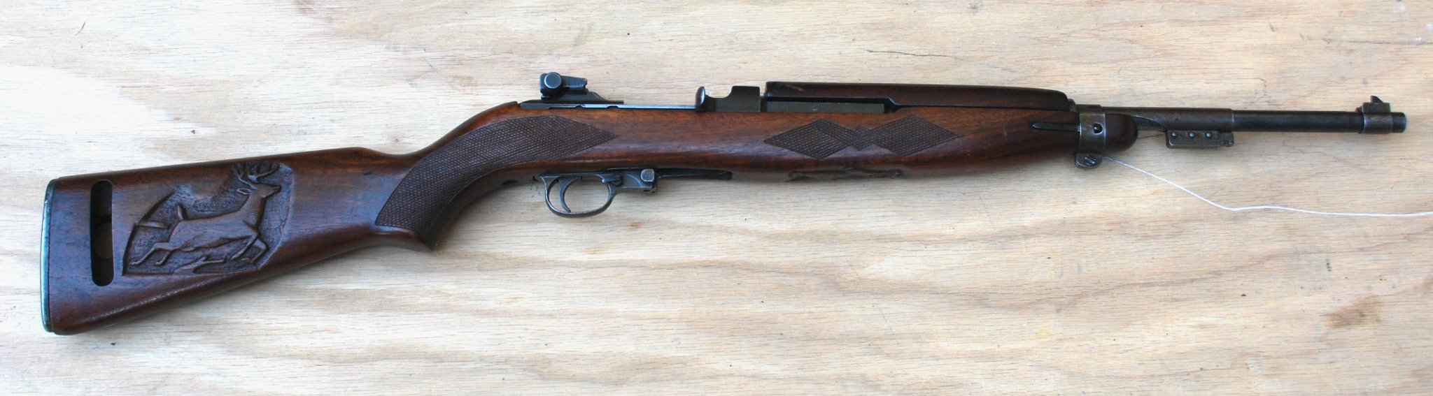

That re-finished Carbine reminded me of one that a deceased relative of mine had. I saved this picture from his estate that shows a hand-carved deer on the buttstock, checkering, and some sort of animal on the bottom forend too. I think back in the 1960s-1970s when M1 Carbines were super cheap and available, folks customized them like this. Given today's value of these items, folks don't do this anymore...

That is a WW2
That serial number is from June of 1943 to October 1943.
