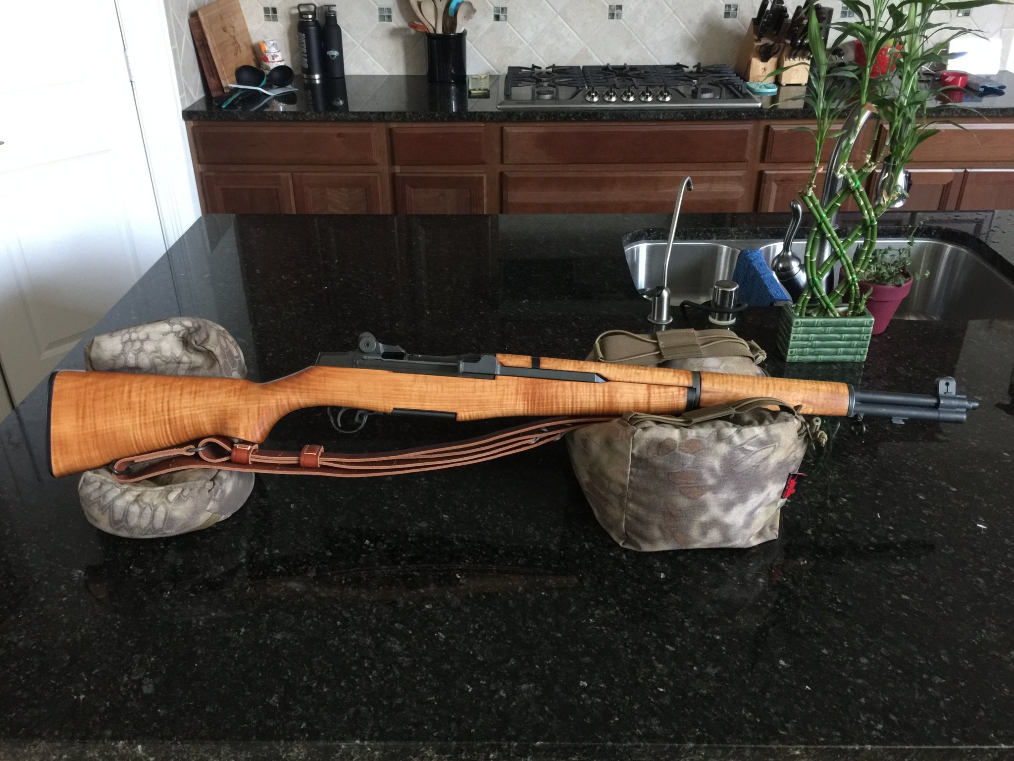

    For those interested, here she is. I realize the light maple is not authentic, but it's different and I like it.

    It could be a number of things, I admit. However, this is a CMP service grade Special on an H&R receiver that has less than 100 rounds down the criterion barrel. I need to pull the stock and confirm the op rod is not binding- I suspect it is. I can strip the rest down and post any pics you think might help. That said, and it's been a few years, the rifle functioned without issue in the CMP walnut stock. The clip latch spring is cheap and easy if it is a fix, however.

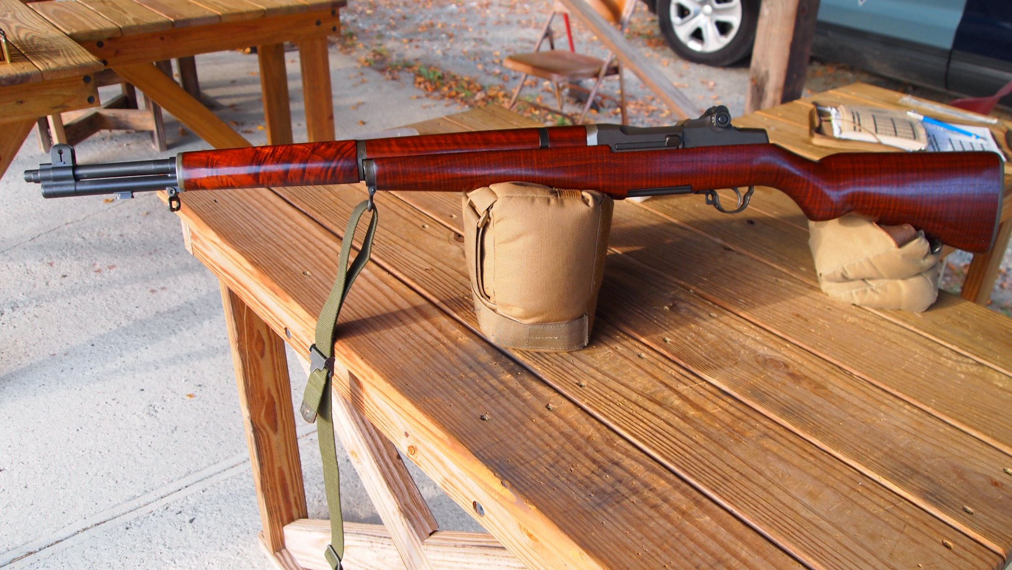

    My Brutha from anotha Mutha...........
    Nice maple stock, I think I have its fraternal twin...(but with a odd-ball match front sight). My nickname for this Italian/PB M1 is "blondie."
