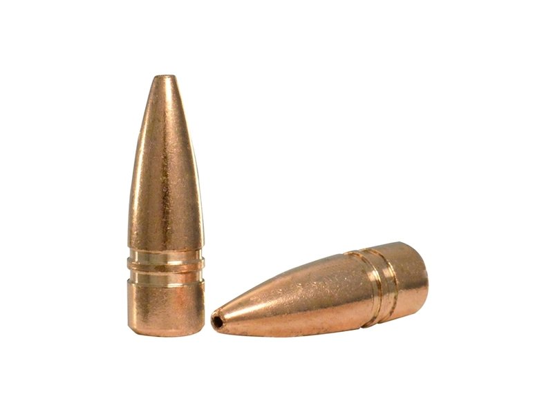

I have some of the 7.62x51mm NATO MK319 MOD 0 SOST I want to work up for a lighter, low recoil load. I caught them cheap at Midway a couple years back.
https://www.midwayusa.com/product/1...grain-open-tip-match-box-of-250-bulk-packaged
