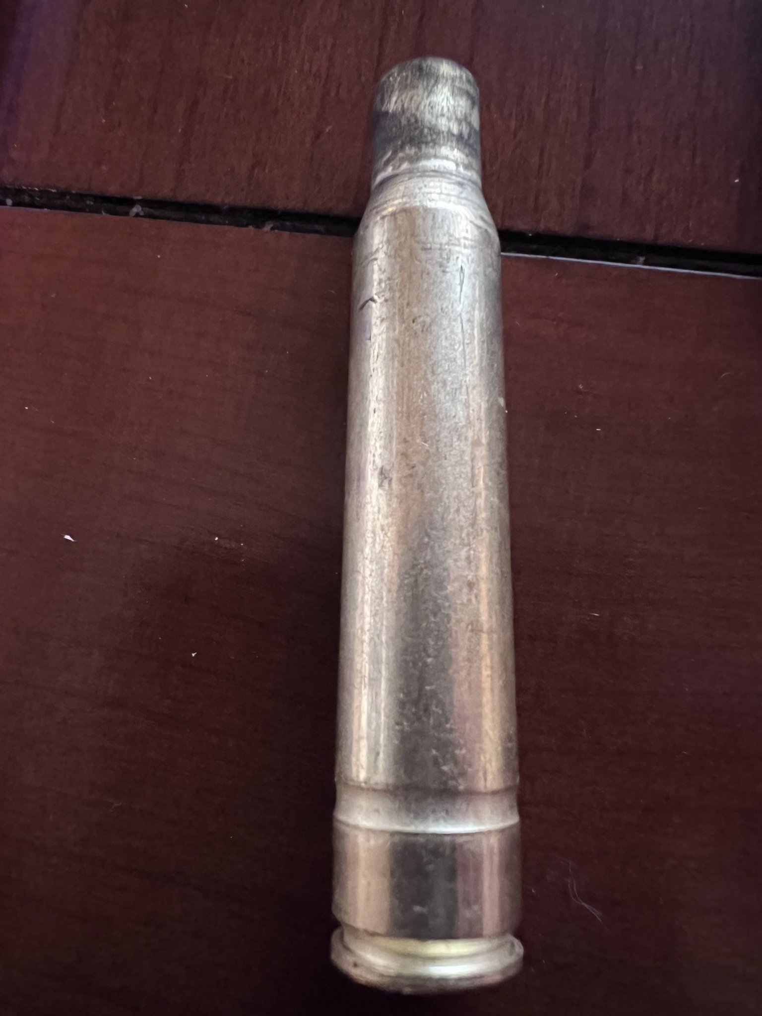

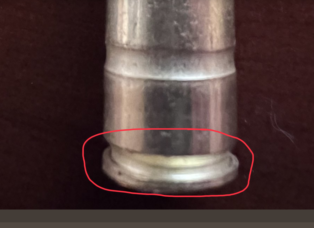

Just shot my dad's M1 Grand for the first time. Case came out with thinned out ring around it. What would cause this?

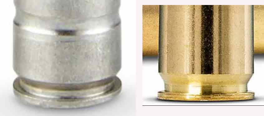

My guess is the groove is needed with some Russian tooling to roll form the case to final dimensions.
It's Berdan primed so it's once and done.
More better American tooling doesn't need the groove to keep the case in position.
Maybe, maybe not.
That Russian ammo may or may not be suitable for an M1 Garand, I don't know. The Garand's design make it sensitive to excessive gas port pressures, excessive gas port pressure, besides beating the action unnecessarily, can cause a bent operating rod, which you don't want. The Garand was designed around powders like IMR 4895 and IMR 4064 and in particular, slower powders will have higher port pressures. I have shot Garands in High Power competition until I switched to the AR platform in the mid 2000s, and I had good results with IMR 4064 and 168 gr. and 175 gr. Sierra Match Kings.

Took Dad's Garand out to shoot, bought a cheap box of .30-06, shot the box.
Picked up the brass and noticed the ring.

@dmfinley chalk it up to education.
BUT, I probably wouldn't shoot any more of it in a Garand.
