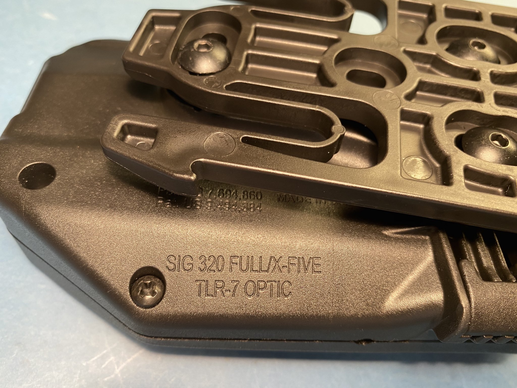

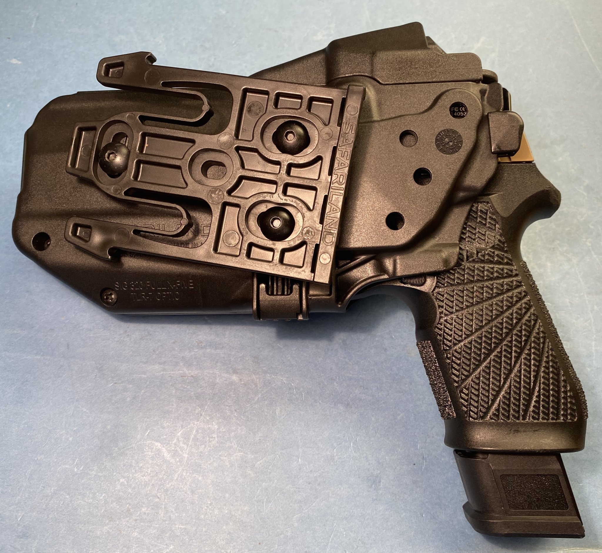

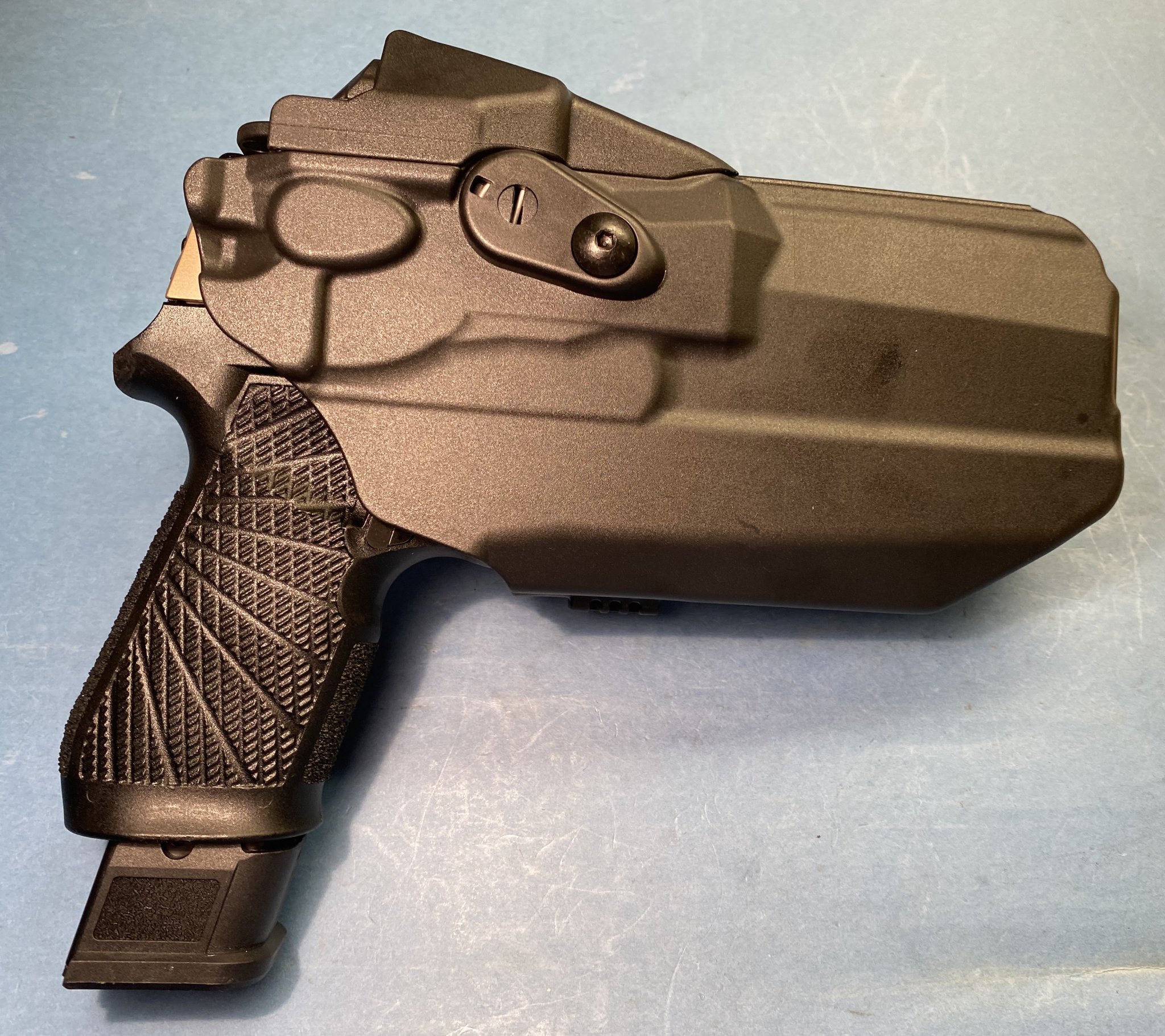

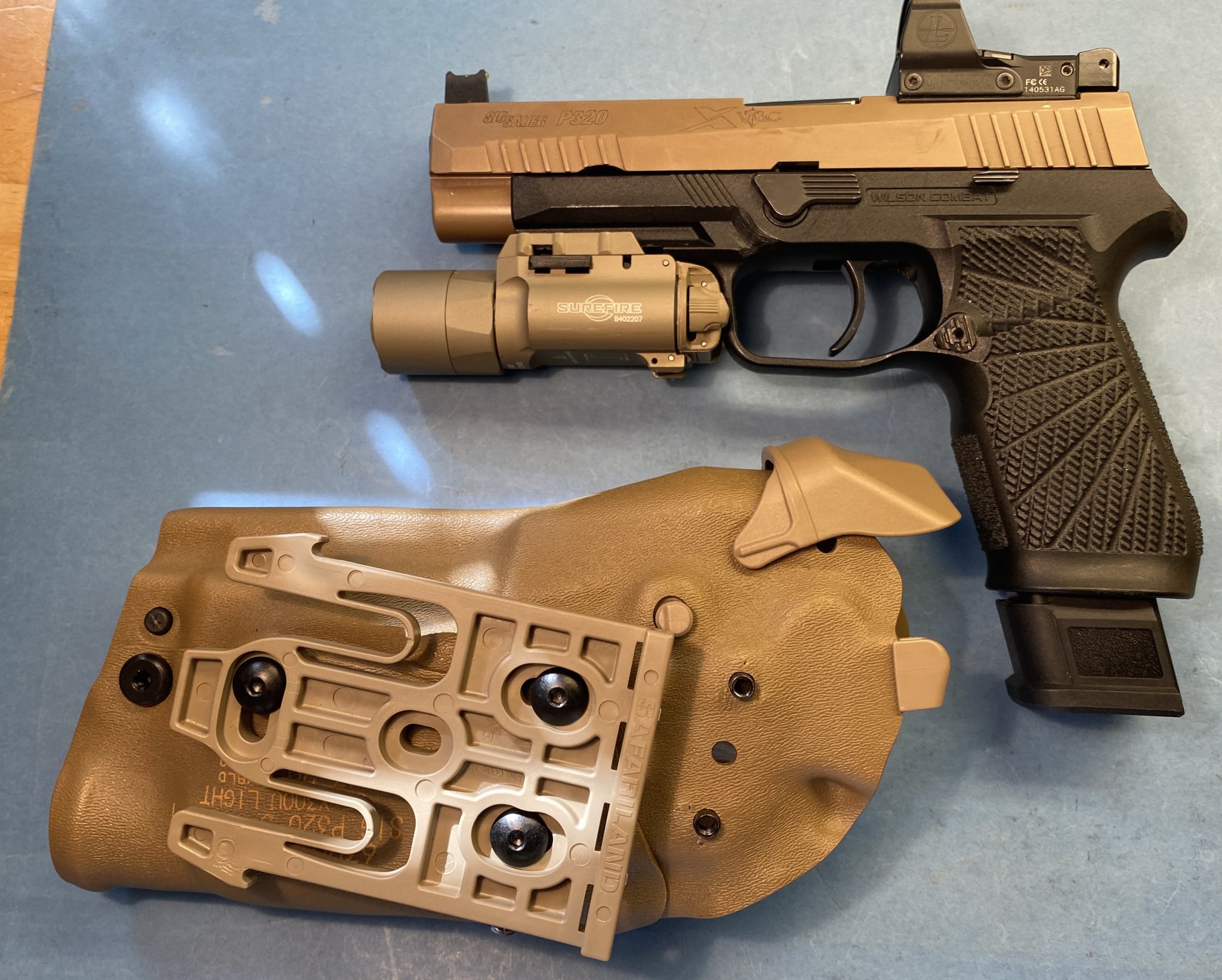

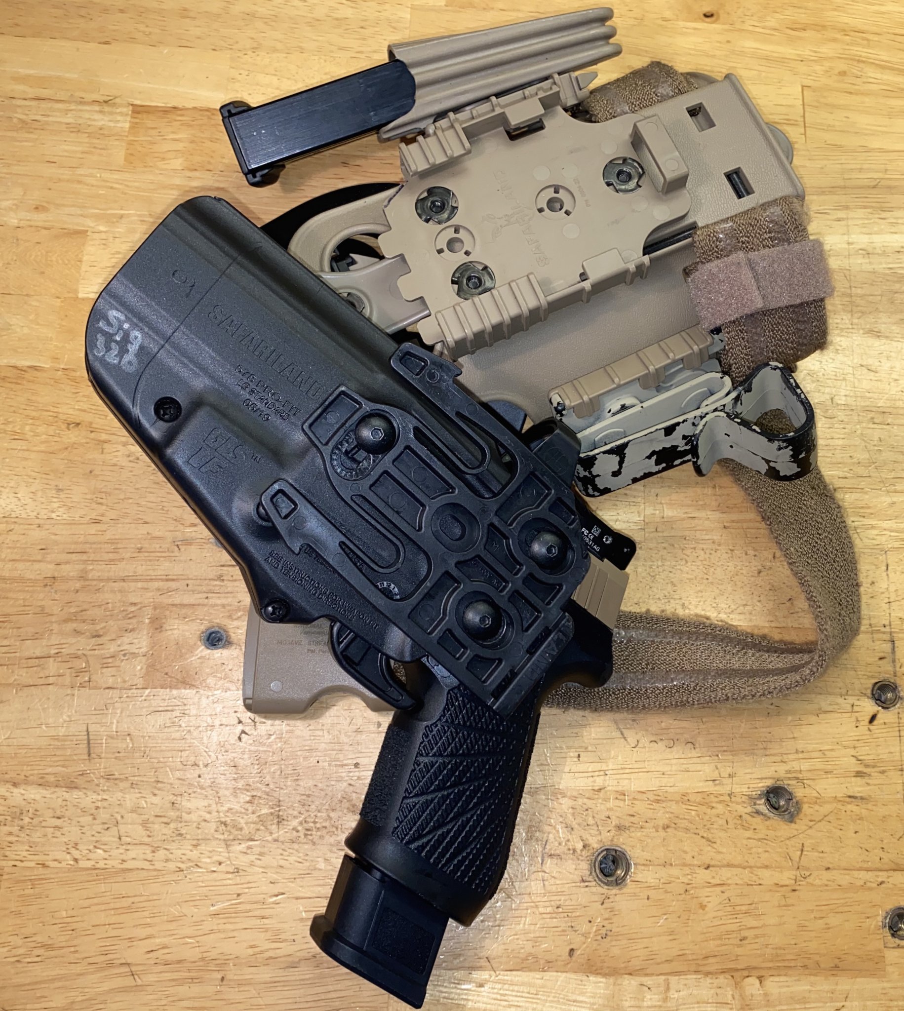

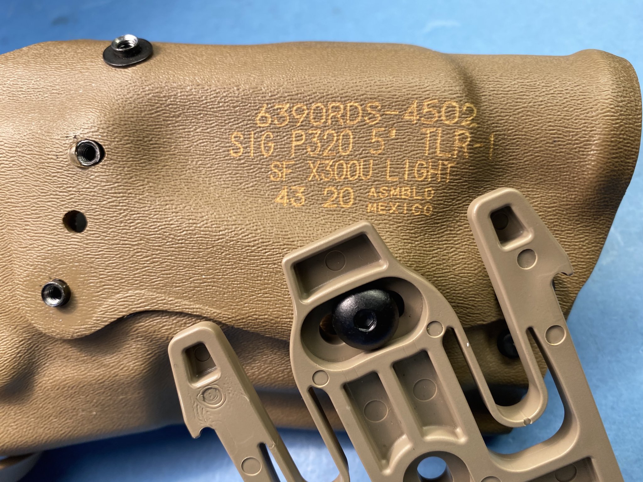

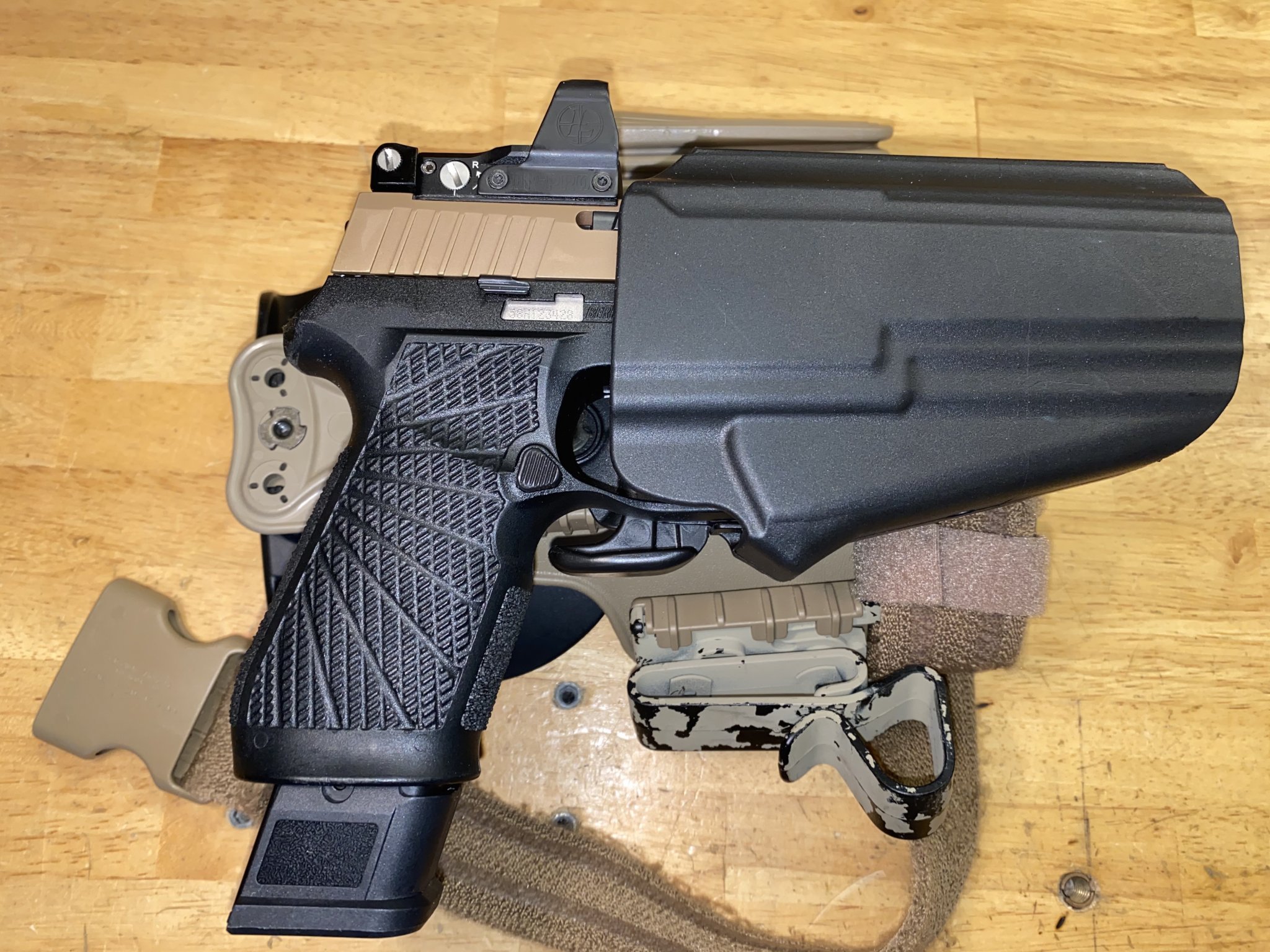

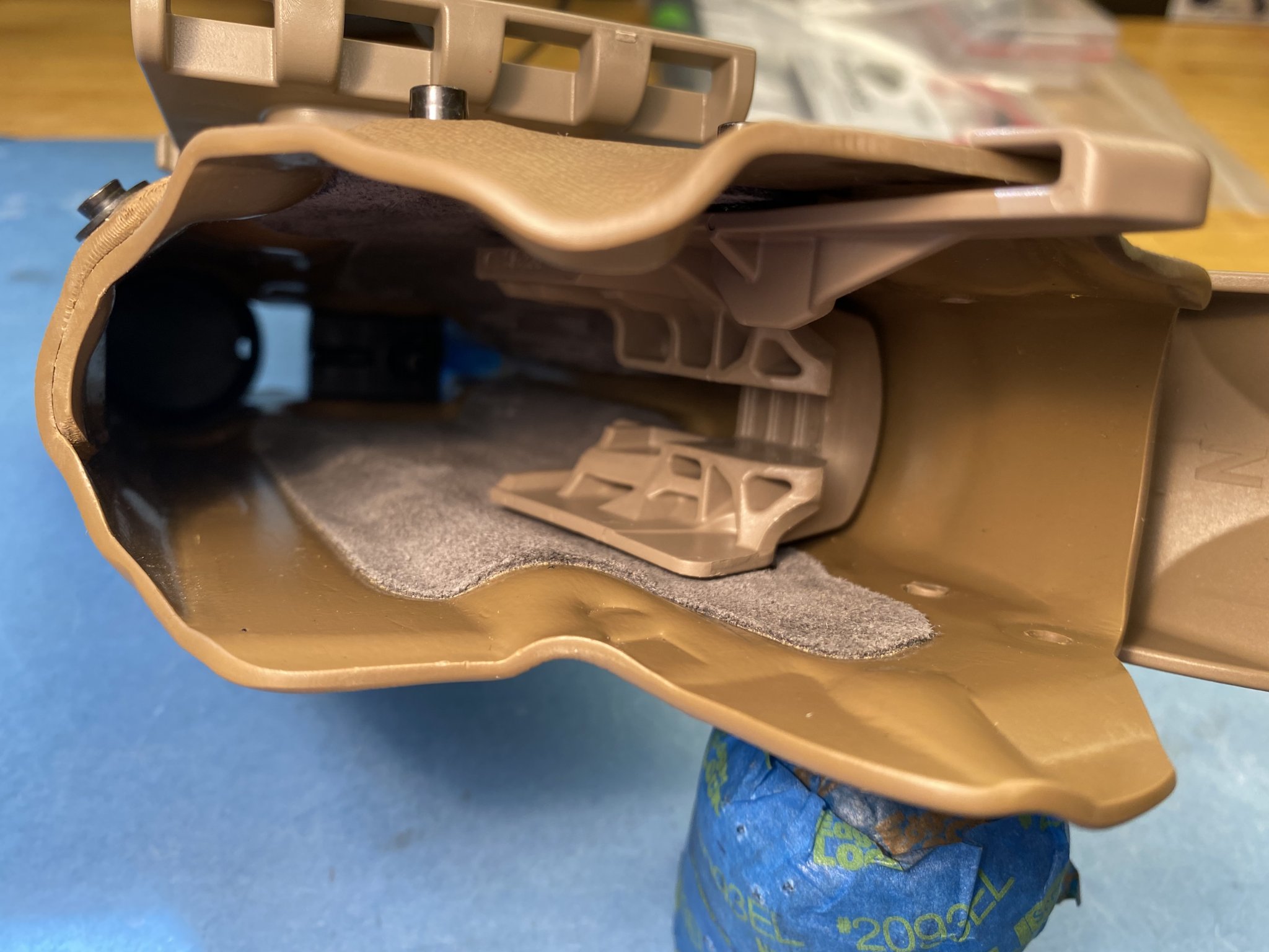

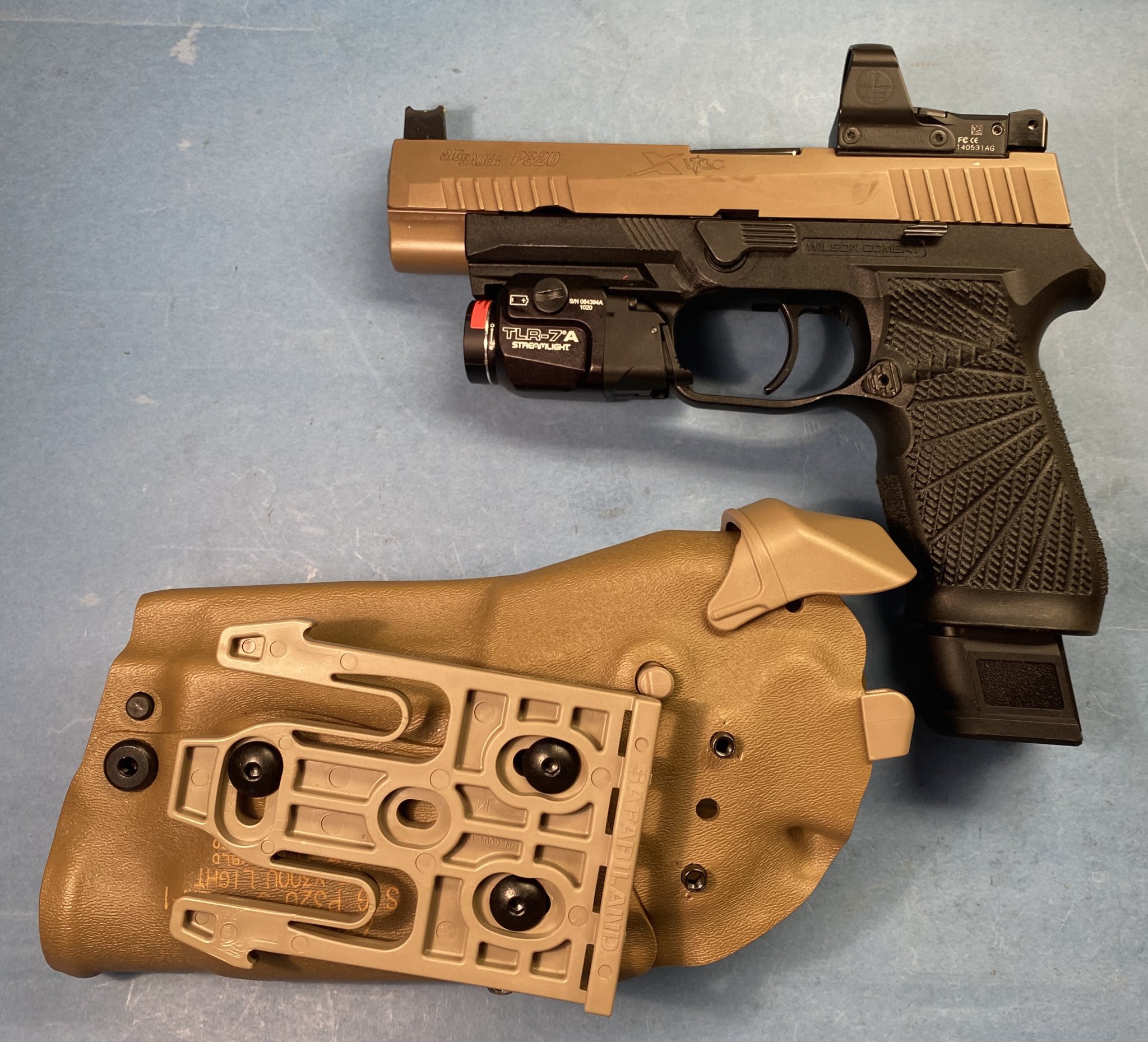

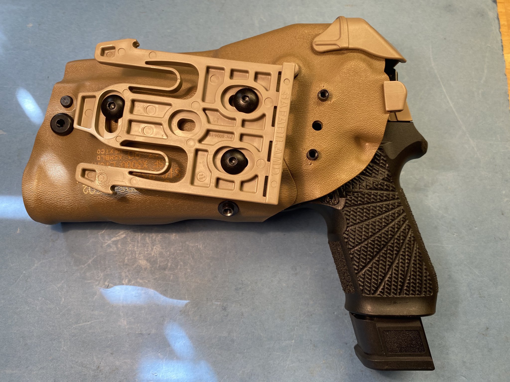

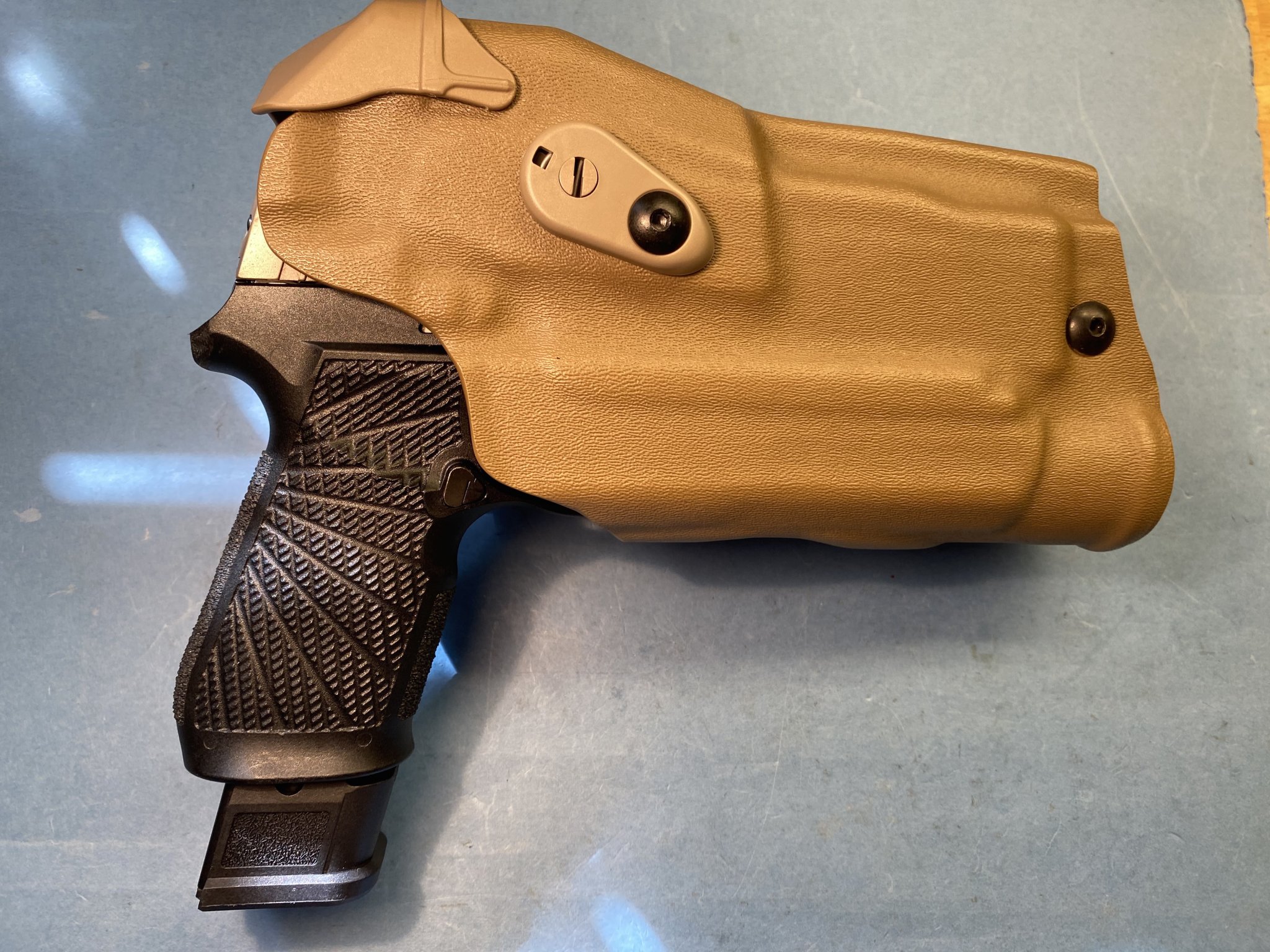

A few different Safariland setups I use for the P320. The FDE holster is a fairly new model but mfg. with thermo-laminate molding (to fit specific combinations of firearm/optic/light )which has a partial suede lining for two reasons, noise discipline when holstering / drawing as well as the kydex used is / can be abrasive to some firearm finishes. The Black holster is mfg. using Sarariland 7 kydex and fabricated with injection molding methods allowing it to be better fitted, stronger, lighter etc.; Safari-7 kydex is not at all abrasive to firearm finishes so no need to have suede linings and any scuffs on the holster are brushed off with a micro fiber cloth. The Safariland GLS works well when no light option needed, but also optic is not protected. The big holsters both come with SLS hoolds /ALS Level 3. The same holsters can be combined with a belt-hip mount but way to bulky to be practical for me.

@strikeeagle1 ,
thank you, that’s exactly what I’m looking for. I like the ranger green denim on the outside but this will work. I appreciate you going the extra mile and moving the clip over so I can see the model number.
Huge thank you!

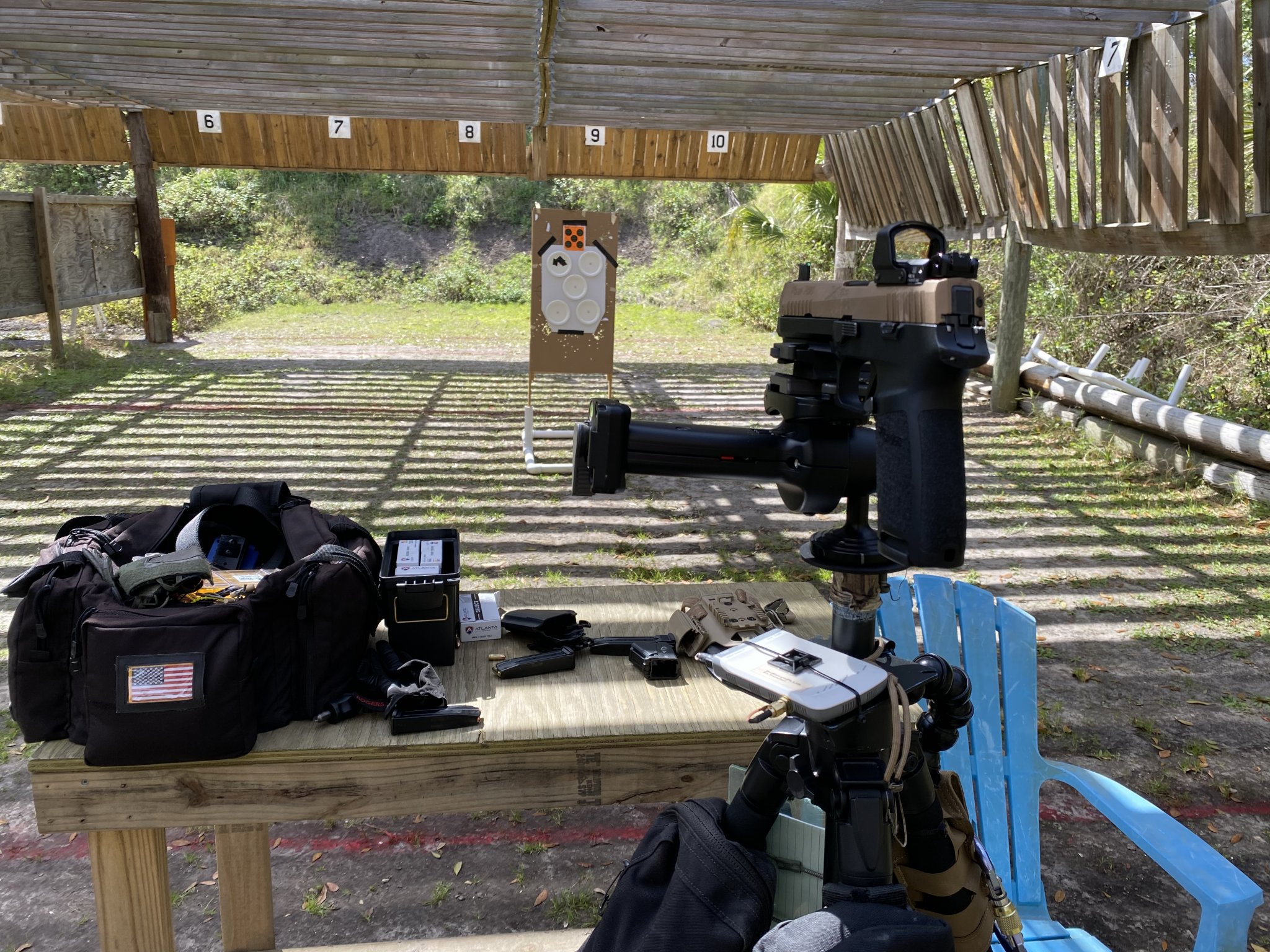

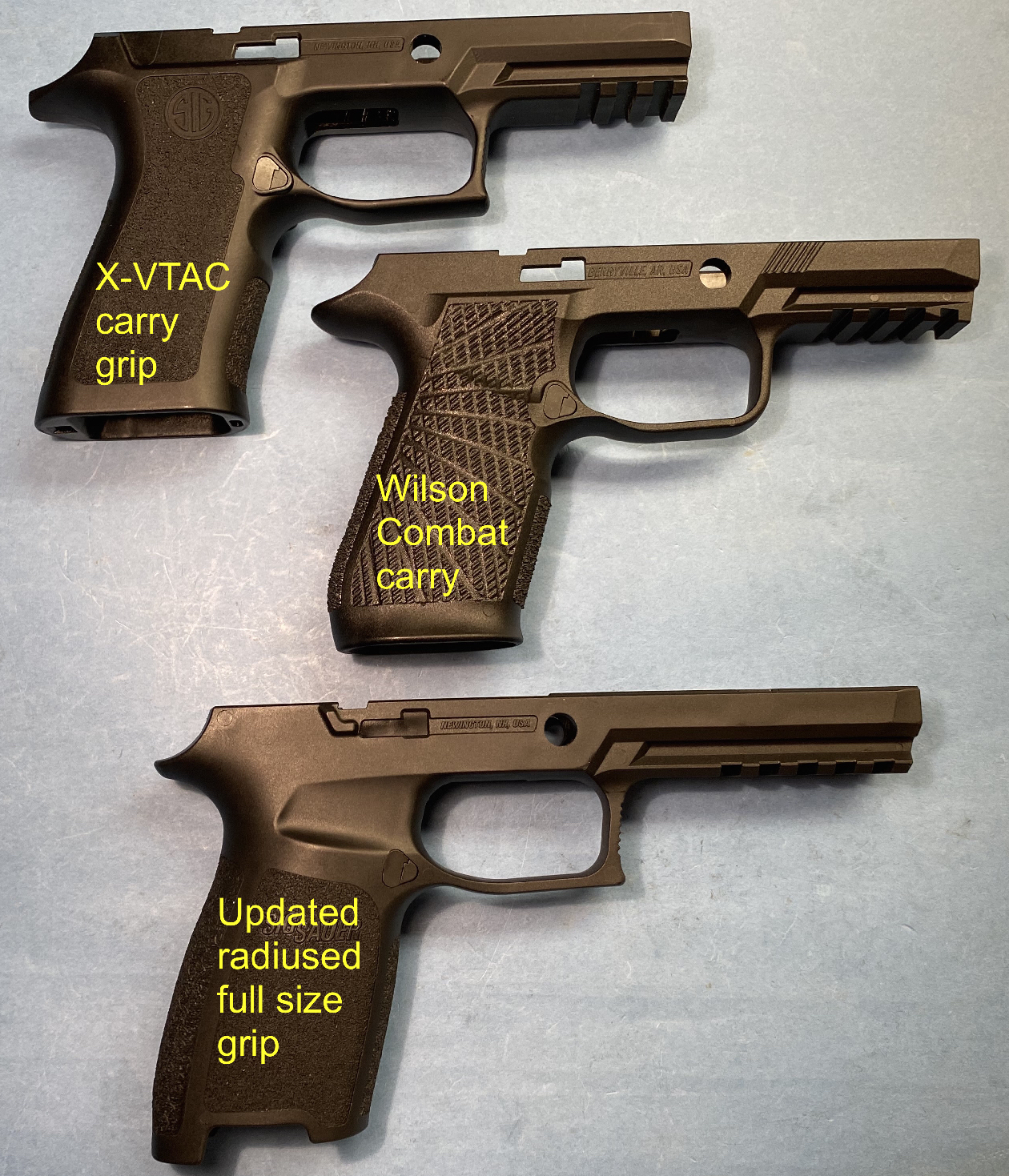

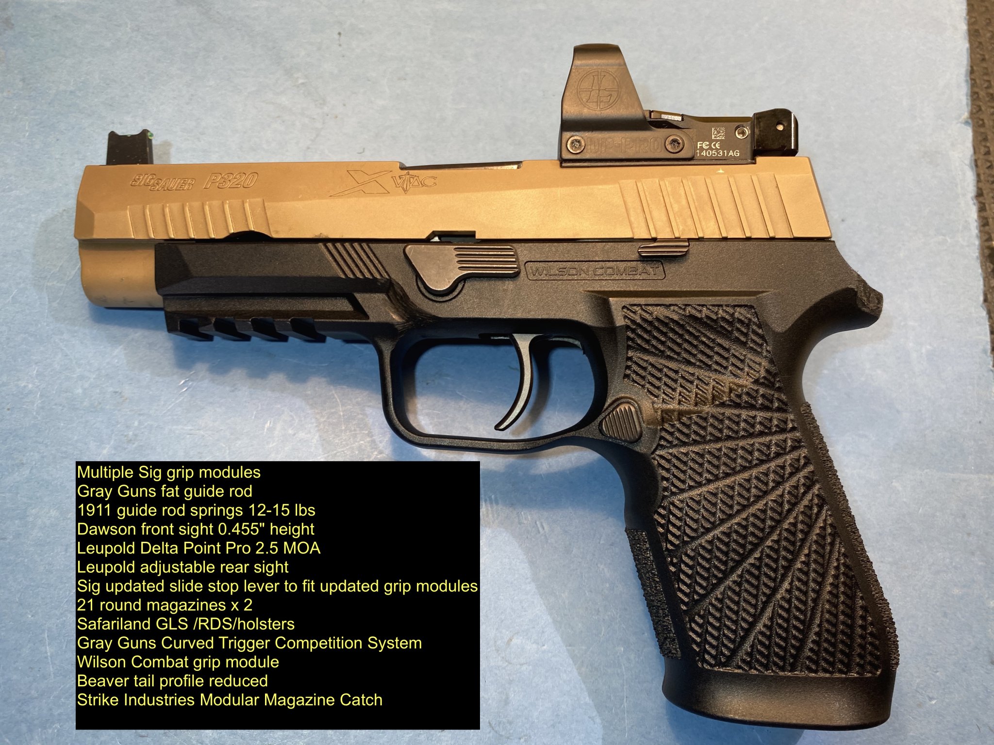

I started the P320 journey last Fall foolishly believing starting with the V-TAC I would be good to go, just add the optic. The factory 7 lb flat trigger was not suitable for fast support hand only shooting in my world; tried every variant of Sig grip modules, to blocky and I own every P series pistol. The V-TAC sights were too low, thus useless with Leupold DDP optic. The standard sig grip modules beaver tail were surf board sized making rapid indexing on the grip from the holster unworkable for me. I have a lot of WC 1911's in .45 / 9mm so I gave it a go; it only comes in one size=Medium; now available in FDE, only black available when I ordered mine. Here's the current 320 build list.

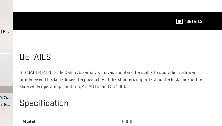

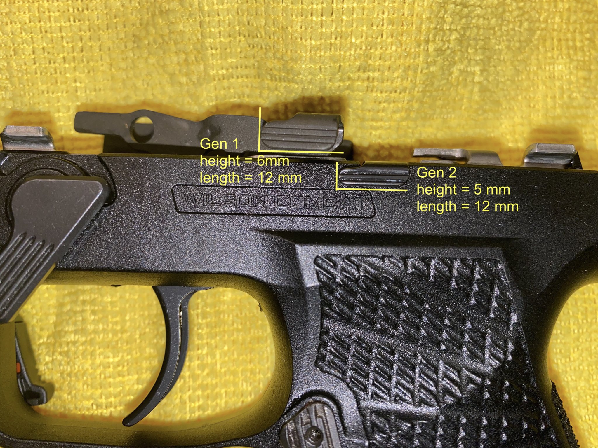

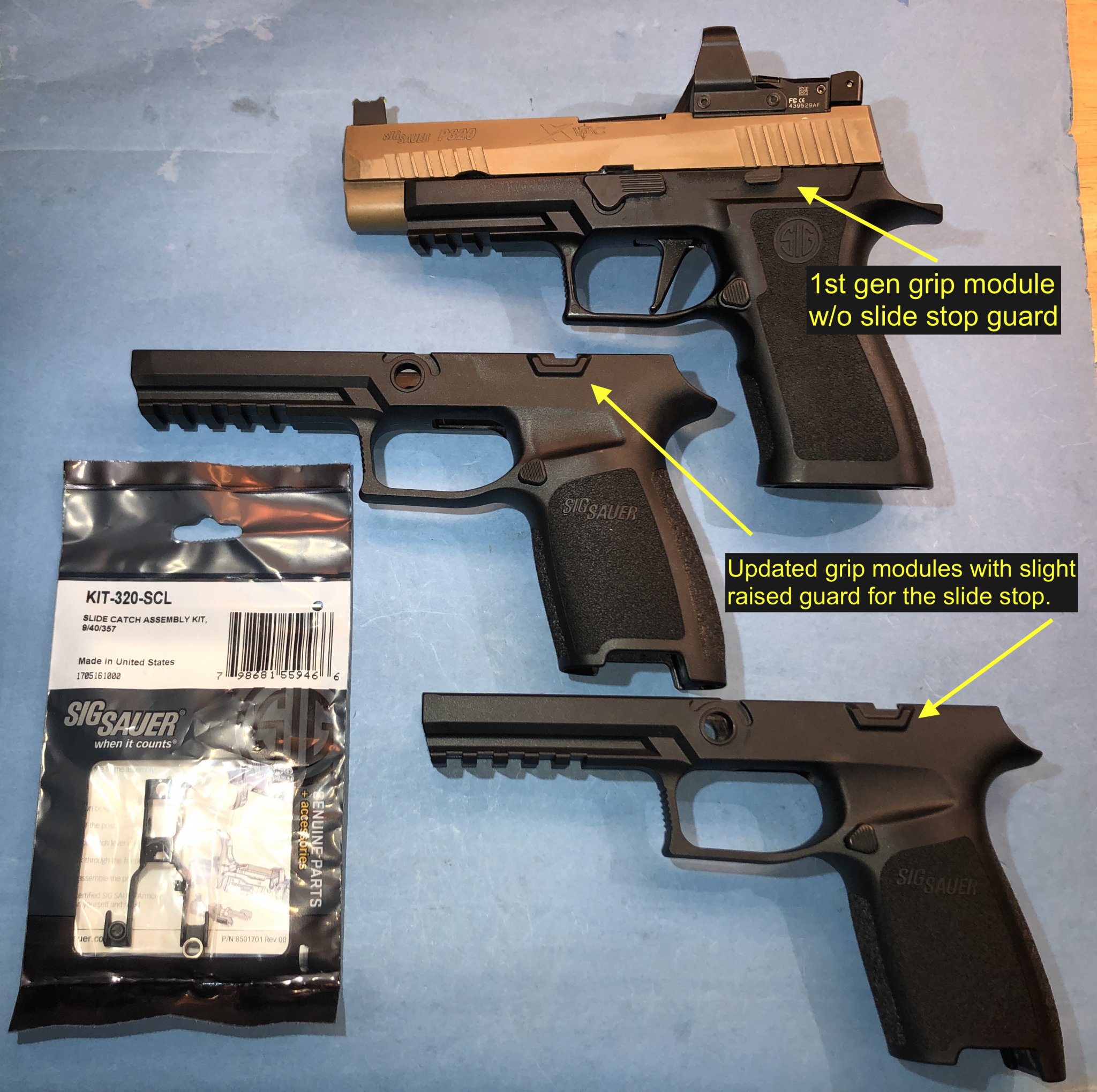

The M17 kit came in record time. Looks good, doesn’t fit. Seems Sig changed the lower in the P320 after mine was purchased and the slide release is shorter on the new ones so my slide won’t fit over the slide release. Looks to be pretty easy to fix, $20 part plus probably $12 shipping but for fucks sake, list that shit in the description on the website so a MoFo doesn’t get his hopes up to shoot the shit the weekend only to find out he needs more $.12 stamped metal....
At this point, I should have just bought a Police turn in Gen4 G17. (Found some 2 days after Ordered this) Would have been less expensive and I already have the damn holster.
Customer service guy was nice and immediately knew what was up.
if you’re thinking of doing an M17 kit maybe call first.
One would think to just have the operator learn to keep their friggin support thumb away from the slide stop since its location is similar
in virtually every modern auto pistol. Contacting the slide stop during shooting is the #1 cause of shooter-induced malfunctions during training drills at the Rogers Shooting School.
Sig P320 Slide Catch Assembly Update for New Style Grip Modules  Dec 2019IMG_4445 copy.JPG
PSA - the only difference in Sig P320 slide stop assemblies, Gen1 v. Gen2, is the external vertical height profile of the mechanism. The Gen1's are 1 mm too tall to fit within the updated grip modules polymer "berm" about the contact point, so third party grip modules e.g. Wilson Combat have apparently elected not to have such a polymer "berm" in order that their offering does not exclude fire control units from Gen 1 FCU's being mounted in their grips. Long ago Chesterfield cigarettes marketed a "101" cigarette that was 101 millimeters long, exactly "1" millimeter longer than standard length cigarettes.......they sold a bunch for that last one mm toke advantage. That's what we have here. That is all.
