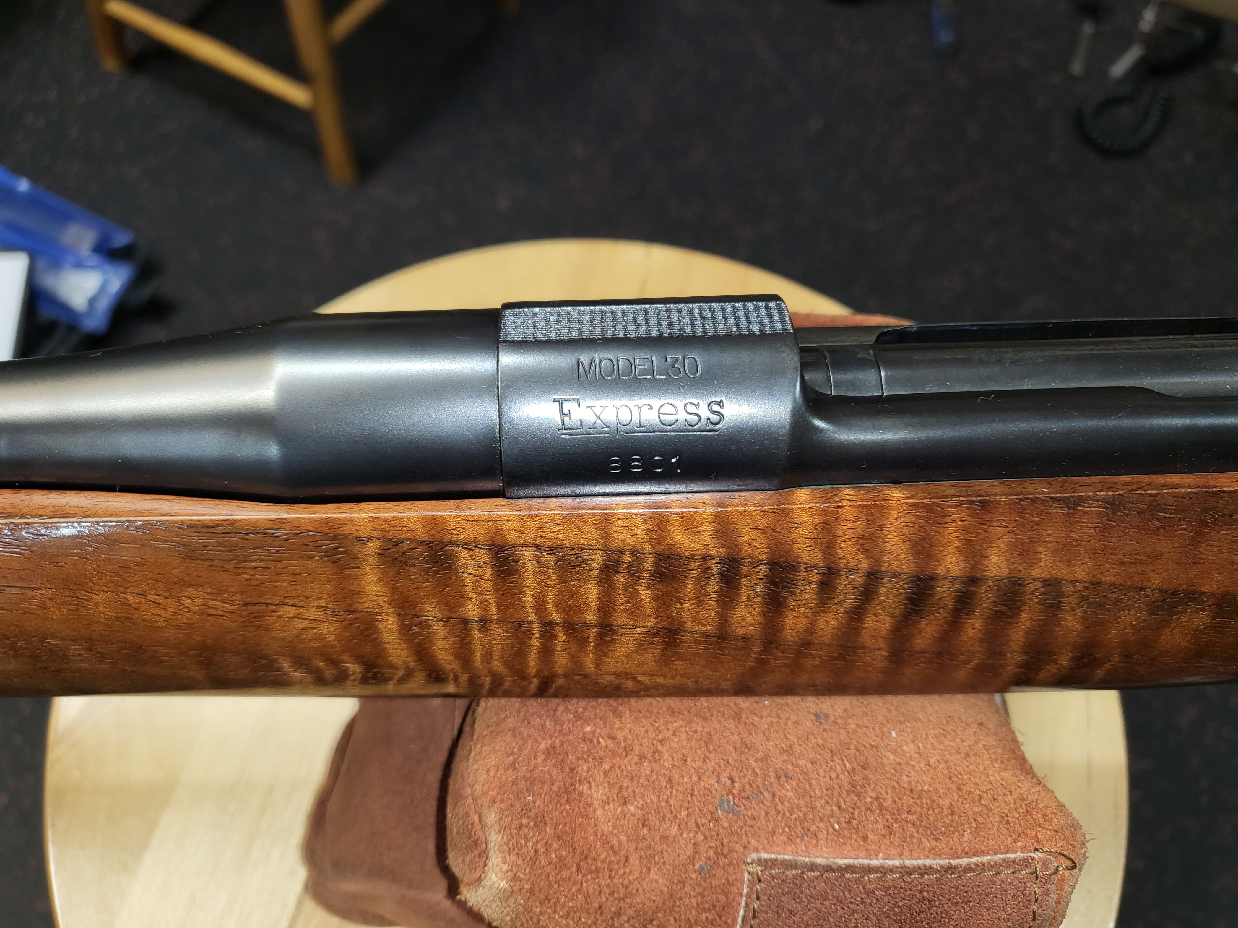

1917's and early Remington 30 Express rifles are cock on closing when you rack the bolt. Later 30 Express rifles where done at Remington to cock on opening. Is one system better than the other? I'll say no. In terms of speed to manipulate the bolt... I'll say no. It's what your use to.

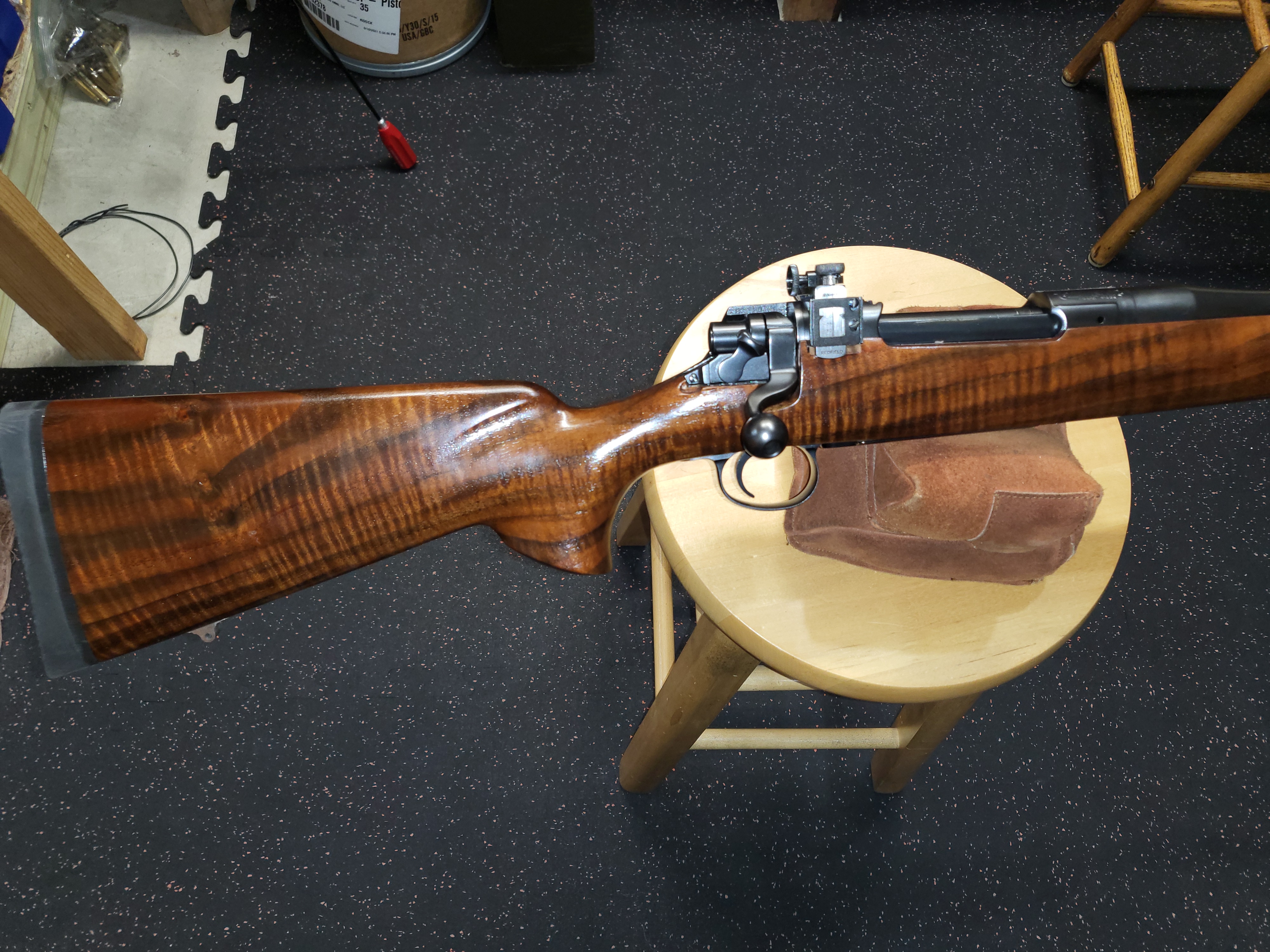

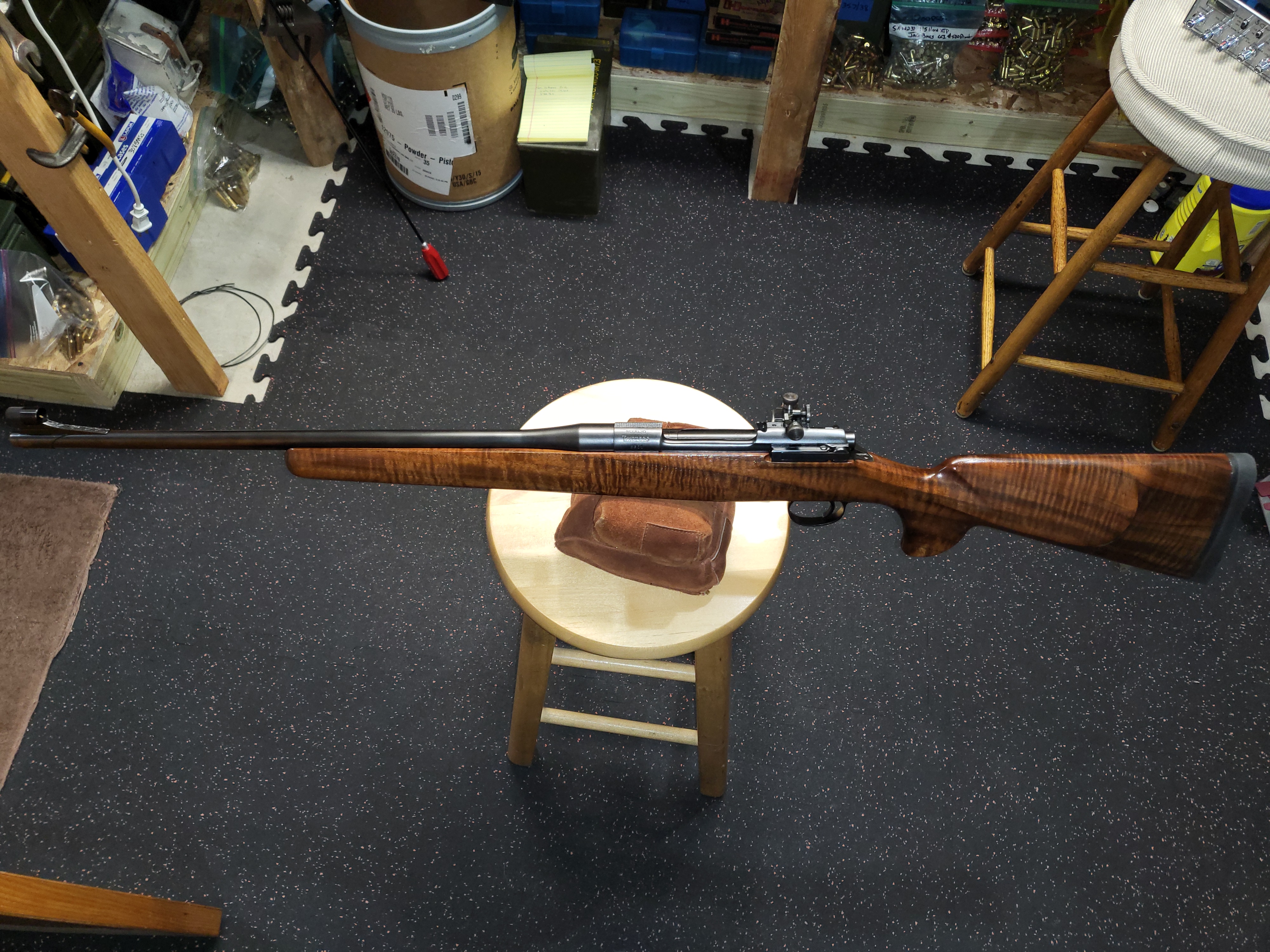

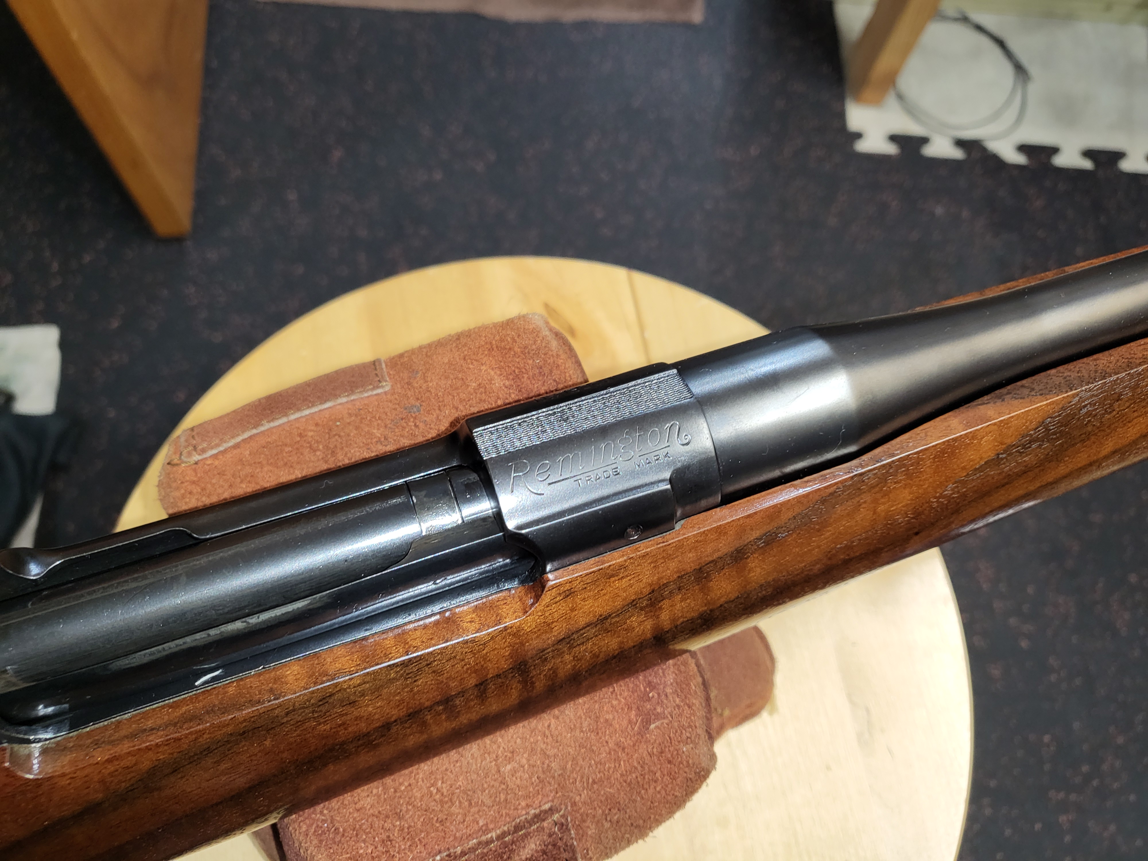

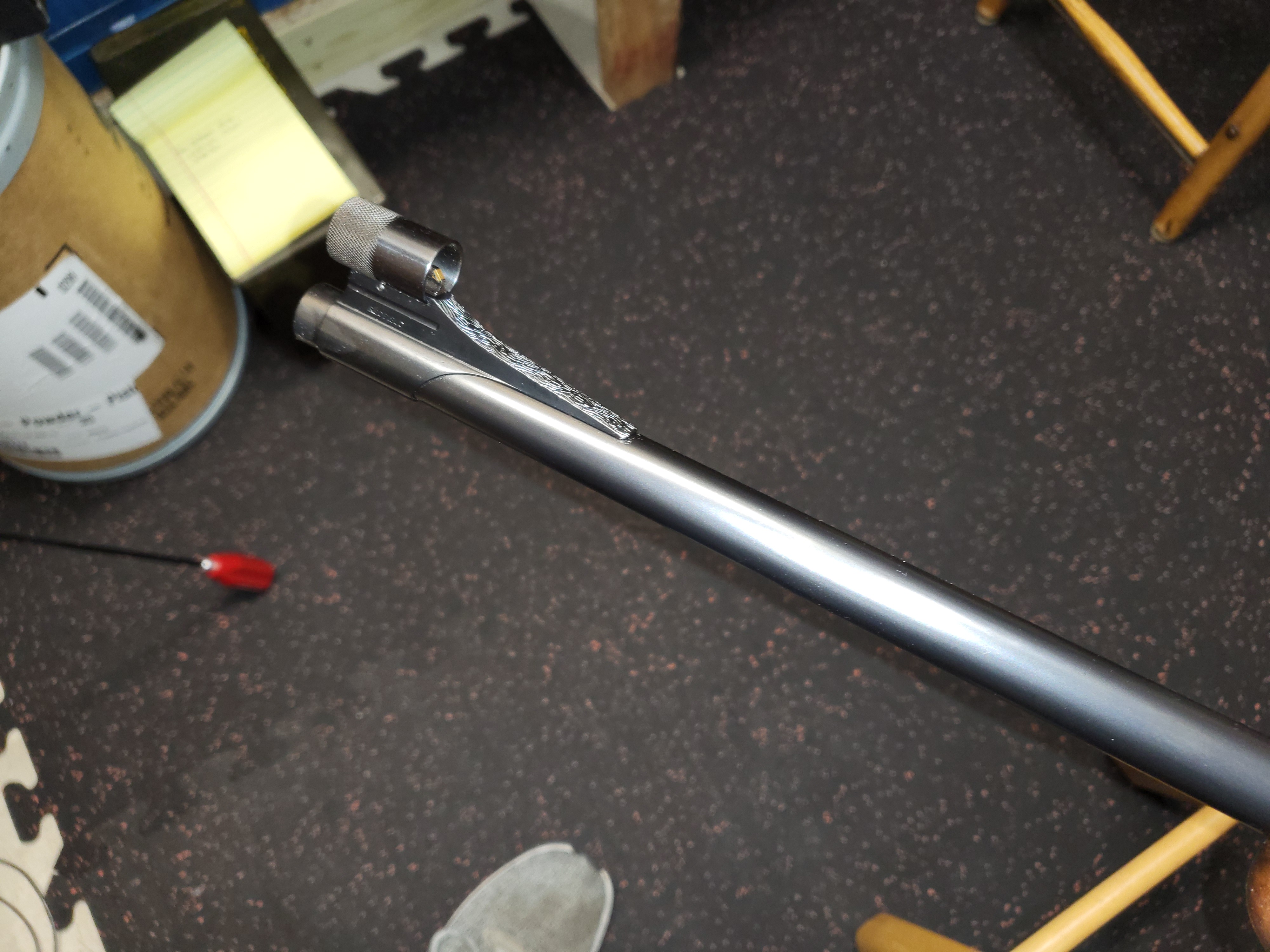

Here is a pic of my Rem. 30 Express that I've been working on a rebuild with a custom stock. This is a factory cock on opening gun. After putting a new barrel on it in 30-06 (22" finish length) I sent the barreled action out and had it re rust blued which is period correct for the gun. Not hot blued.

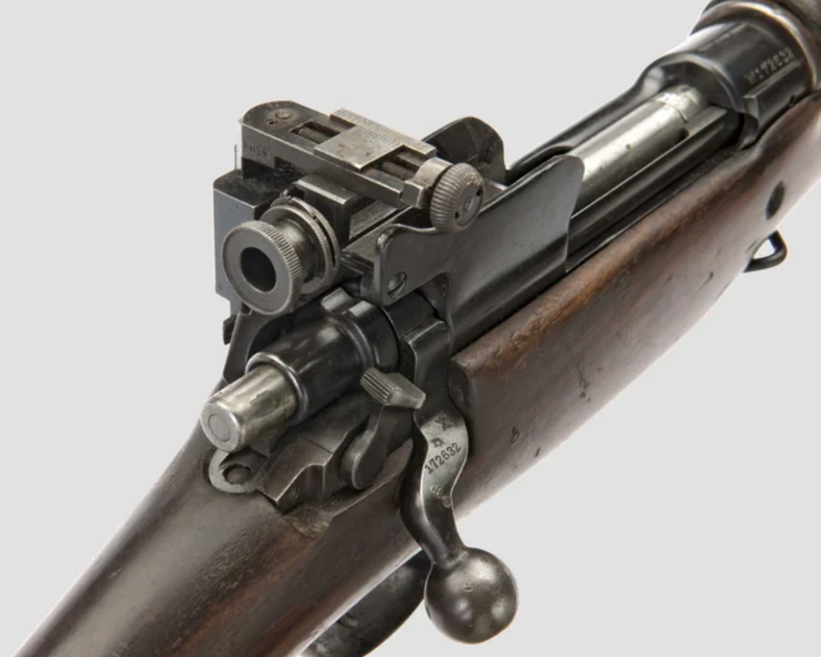

M1917s rear sight lacked windage adjustments.
M1903s rear sight had windage adjustments.
If you want to actually win rifle matches with 10-ring scores, you need to be able to make precise windage adjustments - in real time - to accommodate changes in wind deflection. It’s really that simple. (The National Matches at Camp Perry can get windy too…)
(PS: the M1917 has a 26” barrel and a somewhat longer sight picture than a M1903 w/ its 24” barrel, so at least theoretically the M1917 would have some advantages in the accuracy department. However, in reality the complete lack of any precise windage adjustment w/ the rear sight seriously outweighs those other advantages and really negated its usefulness as a match rifle when compared to the M1903.)

Can we get a full pic of that Rem 30? That baby is gorgeous!!
Sorry but the best I can do for you right now. Barrel is finished at 22" or 23". Can't remember which. I bought the stock unfinished (rough inletted) off of Ebay for a $100. Alex Sitman at Master Class stocks did the final inlet, semi sanded it and bedded it for me. I'm doing the finish stock work and did the sight install. Glen Rock Blue in Wy did the rust blue work. Also has a Timney trigger in it. Front sight is a old NOS Redfield band sight. Rear sight is a Redfield as well.

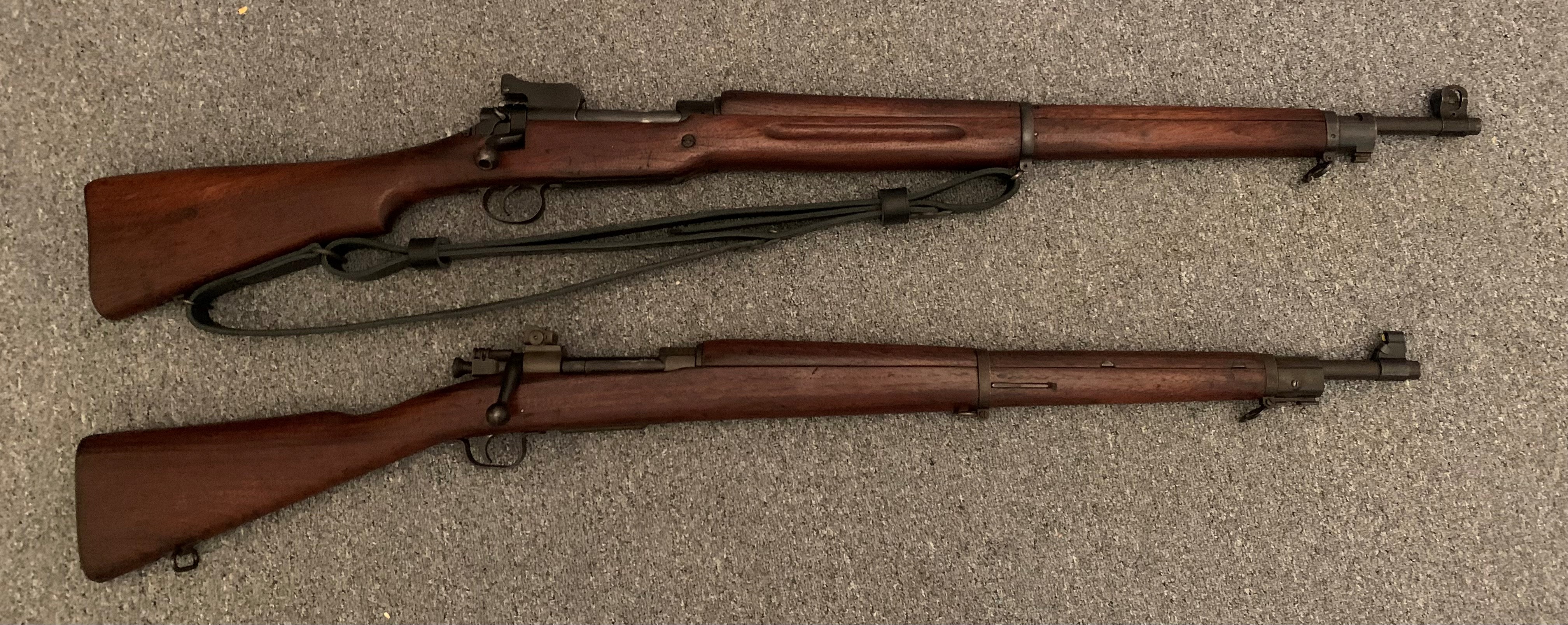

These 2 were mine:
I realise that we are talking 1903 and 1903A3 , however I think still relevant:
IMHO;
The M1917 has a better front sight width and the fixed front sight protector is better as it can't get lost.
The 03 is much handier. The small amount of extra length on the 1917 isn't a problem it's all the extra wood and steel making it just feel heavier and bulkier.
The action on the 1903 is heaps smoother, i've owned a few 1917's and P14's and they have nice , solid actions but the cock on close is clunkier in my opinion.
The safety on the 1917 might be better than the 1903 in its positioning but i like the 3 positions on the 1903.
Triggers are much the same.
The 1903A3 sights I wont compare as it's a different rifle, other than to say I think it's a really good sight for a battle rifle, nice and simple.
My experience with the 1917 is that it's let down by lack of windage adjustment.
The 1903 sight is good but overly complicated in my opinion for a battle rifle.
