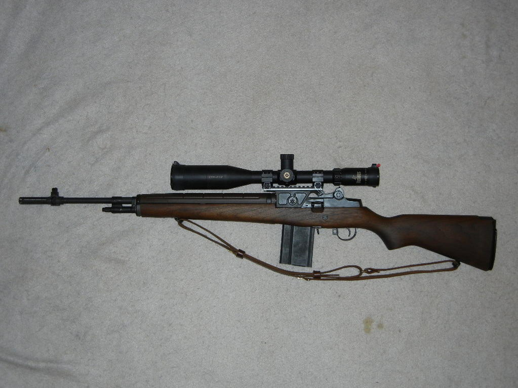

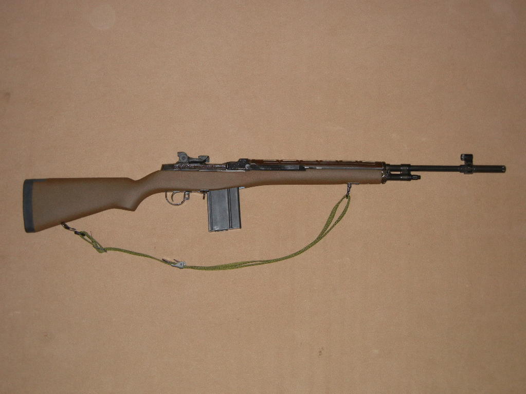

I have several M1A's, The Brand New Stainless/Walnut National Match by Springfield was a disappointment. I was so proud when I showed to the retired Marine that built my others, he told me as soon as he touched it that don't worry if it doesn't shoot he could fix it, I thought he was kidding but I guess Marines don't kid. All of his M1A rifles for me shoot 1/4-1/2 MOA and the Factory Stainless/Walnut National Match with 8-different loads and ammo shot 2-5/16 to 3-1/8" five shot groups from a sled at in indoor range with no wind. All of my AK's and SKS' shooting Tech Sights- iron sights will do better than that. And that was with a Sadlack Airborne Mount ( professionally installed), lapped tactical 6-screw low rings and a 2.5-10x50mm scope on 10x out of a lead sled. What a POS. I asked him what was wrong and he said their bedding job would have to be redone, they had way-way too much tension at the front of the stock to the barrel band. I'm 6'-6" and almost 300lbs and with one hand squeezing that point I could barely budge it. I have started checking new ones at gun shops and they're all like that. I asked how they had gotten the bedding job that perfect looking and he would not say but another gunsmith told me they bed them and then cut them out with a CNC machine, so to me that's not bedded with a release agent to your rifle. I guess it speeds up production but when I pay that much for a rifle I want it done right. I asked Bud what could I try and he reminded me he had done an extra reinforced GI fiberglass stock for my open sight competition rifle. You are not supposed to interchange them but I asked if he carefully put it in that stock would it hurt the bedding? We did that and he said it might take 25 rounds or so for the stock to settle in. That was a Springfield factory Woodland Camo GI Fiberglass stock made back I think in the 1980's I found NOS. In all the GI stocks he fiberglass's a .220 Titanium rod full length on each side inside the lip. When I shot the rifle in that stock in the sled to verify, it 5/8"- 3/4" 5-shot groups, I took my time and shot 6-groups. And when all the stupid pressure was released from the factory walnut bedded stock the rifle shot 3-3/8" high at a 100-yards. Bud said after some more rounds down range he thinks it will eventually get better. All my rifles have been fire-lapped with Tubbs Final Finish so I don't think that one will get much better. I am camoing it up to use for a hunting rifle since it's my least accurate M1A. I love my M1-A's but was thoroughly disappointed with Springfield on their National Match. My other M1A's that shoot circles around that one are all loaded models that Bud starts with. He said there's no sense in wasting the extra money on a National Match because the only up grade we use is the rear hooded sight. We do not use their front sight I use an Alley Globe sight with Lee Shavers inserts, sell their stocks and bedding jobs on Gun Broker and he has to redo the barrel/hand guard float, and his amazing trigger job. I don't know if ya'll are fortunate enough to have a Retired Marine around that can fix yours, but if prepared right they will shoot with a Bull Barreled Bolt Gun. After a Rifle Match Bud was showing some new shooters how to shoot offhand and on one leg went 8 out of 10 on orange clay pigeons on the 100-yard berm offhand with his open sight M1A on a windy day. It was a humbling experience, I just hope I'm still alive at 75 much less kicking everybody's bu** at the rifle range.

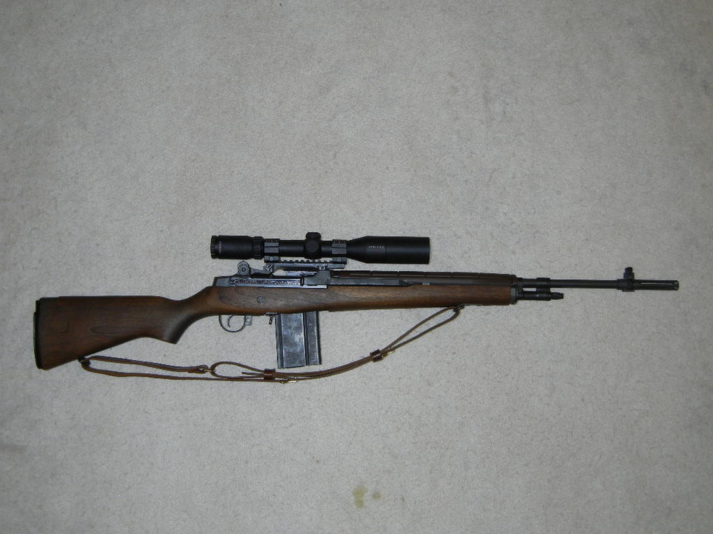

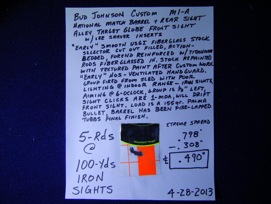

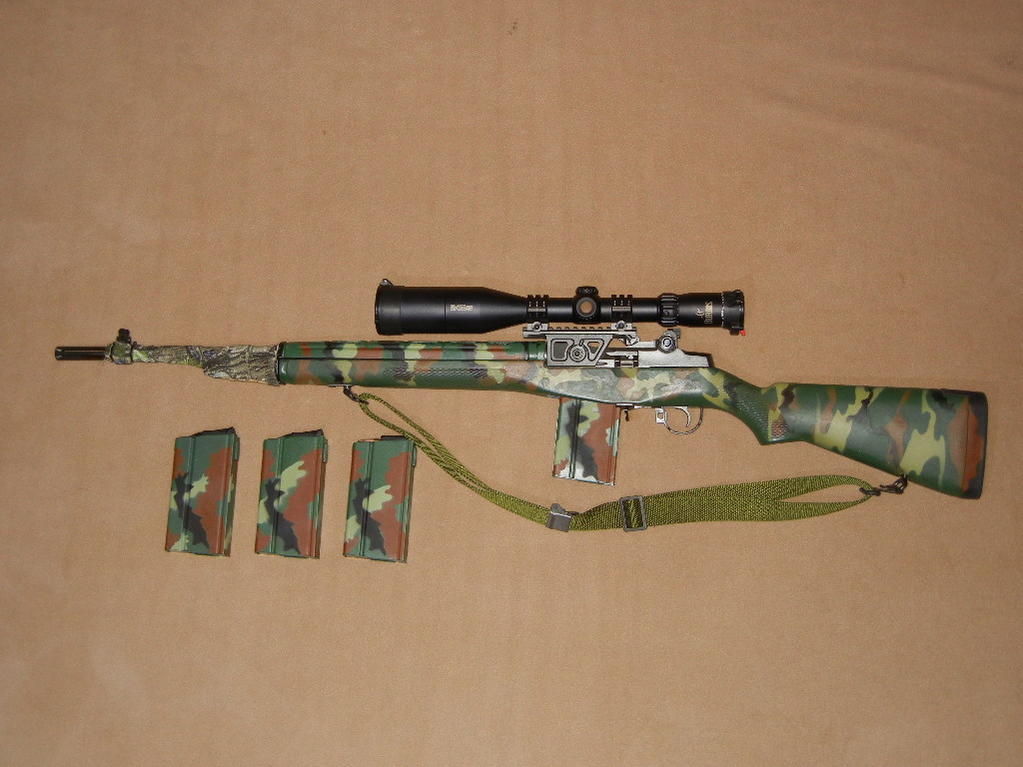

Here's a couple more including the National Match. The camo stock was a NOS factory Springfield M14 fiberglass stock from years ago that I added one of their pads to. It came with a matching solid handguard, we shoot a lot so I matched the camo job on a NOS early issue ventilated handguard and also painted up some mags for it. A camo gun sock is covering the stainless barrel. Since I'm not sure it's going to stay like this I have not installed the camo scope skin kit on the Sadlack Airborne mount and scope. The scope is a NOS Burris Black Diamond 3-12x50 mm Illuminated E1 Holdover Reticle. The other custom built Loaded has a steel Sadlack Mount and a Burris XTR 3-12x50 mm Illuminated Ballistic MilDot.
