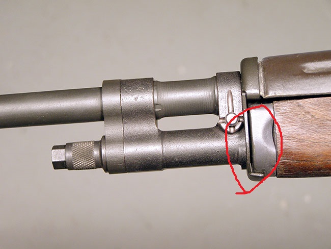

Does it fit tightly in the stock and is there clearance up front between the gas cylinder and the stock?
You may have to help me with "clearance up front between the gas cylinder and the stock" (I have no idea how much is good/bad--vaguely aware of gas cyclinder) I'll have to do some research/learning.
The front part of the stock that bumps up against the gas cylinder should have a tiny bit of space.
