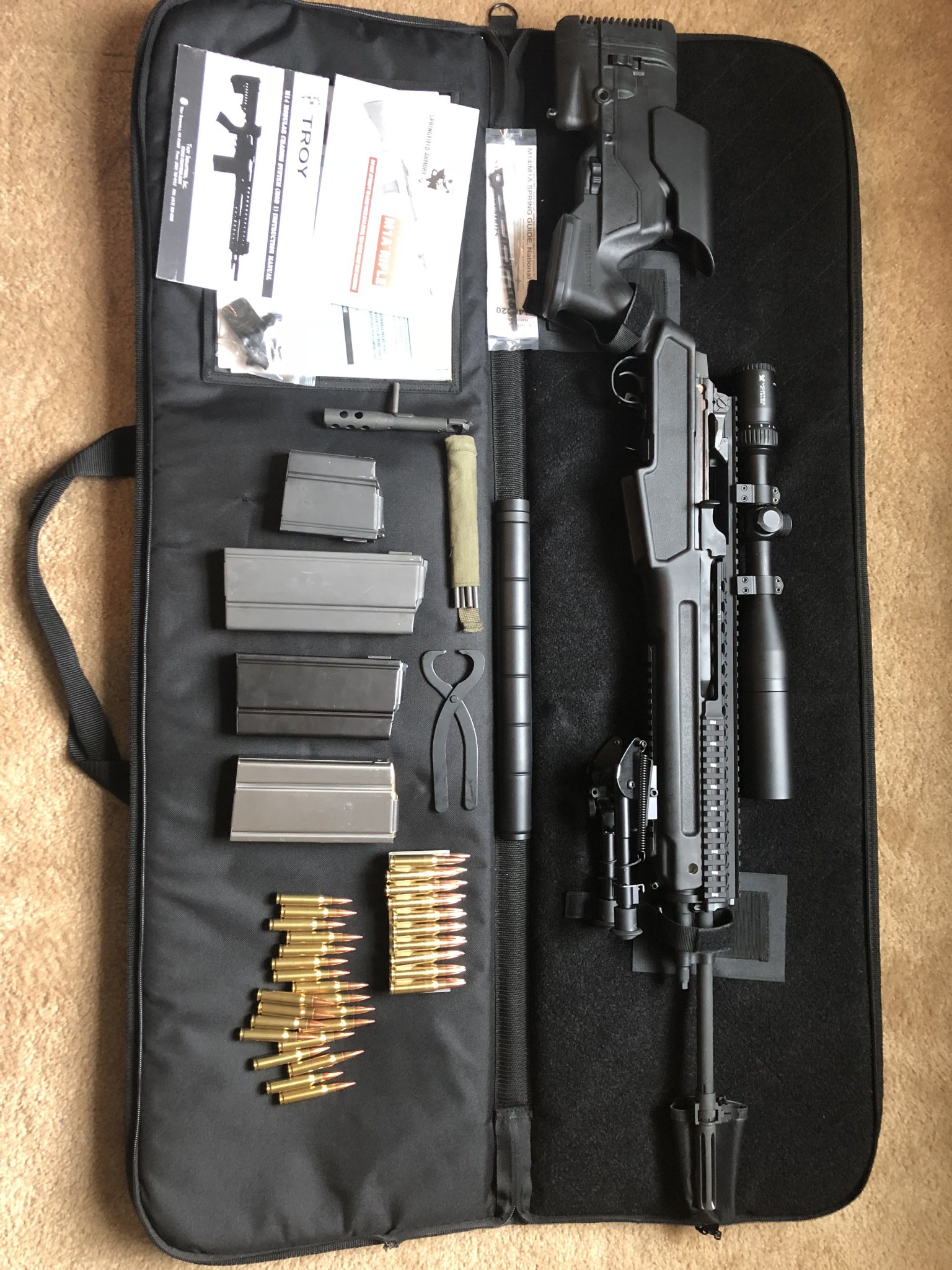

This rifle was set up for long range precision shooting.
-22"; Twist 1 In 11"; RH; 6-Groove National Match Med. Wt. Premium Air Gauged Carbon Steel Barrel
-National Match two stage trigger
-Sadlak National Match guide rod
-ArchAngel Adjustable Precision stock
-Troy Industries M14 BattleRail
-CVLife 6-9in Bipod
-Vortex Diamondback HP 3-12x on Warne Scope rings
Suggestions on next upgrades or modifications for better accuracy and efficiency? Should I just sell and get the 6.5 Creedmoor M1A Loaded?

M1A rifles are lot of fun to shoot but if you are going down the precision world (depending on your version of precision) you are shooting it for purposes it was not intended for. If you are good with 2 MOA average, you are good to go, but if not, than it will take lots of money to get it down into the 1 MOA range. I have been there and spent the money to tell the tale. It wasn't worth it in the end. An AR10 platform can use a lot less money to get better than M1A results.
I’ll dissent here. I have two M1A’s setup for long range and both are capable of sub MOA performance should the idiot behind the gun do things correctly. They can be very humbling should one slack off on whole “marksmanship” thing....... One of mine is a SAI loaded dropped in a Sage EBR and with handloads it has done some very tight groups during load development and it is very consistent out to 830 yards. All I did to that was USGI extractor/spring, op rod guide/spring along with the Sage. My other is a full custom build on a Fulton Armory receiver with a Kreiger barrel. It is a hammer as well. They are two of my favorite rifles and I hunt with them during deer season regularly. The M14 system is pretty damn reliable and when setup properly they can be very accurate. I considered a 6.5 CM M1A but as hard on brass as my two are I’m sticking with 308 in that platform. Will they ever be as accurate as my bolt rifles? No. But that’s not their purpose either... Stick with the rifle, sounds like you have put time and effort into it, just my $0.02....
What other semiautomatic non -AR rifles have long range MOA accuracy and are battle proven? I had been a fan of the M1A for a long time and The 6.5 Creedmoor loaded version came shortly after I purchased mine (wish I would have waited). I know they won’t be as accurate as bolt, that’s why I have a DTA SRS, but I want the best in semiauto long range which is why I went M1A.
Do you find that the Sage EBR chassis improves the rifles performance as in accuracy, weight, etc more than the Archangel Precision stock? I see a lot of people went that route. What are the advantages of it?
I had the M1a Loaded stainless, and it shot very nicely at 300yd with a scope and handloads. Scope mounts were an issue, but that's not so much true these days. About all I did to it was glass bed it. Aside from mounts that kept loosening; I liked it a lot but when I needed money, it was the first to go. It simply wasn't reliably accurate while the mounts were the issue.
Later, I got introduced to the AR platform, and it's pretty much about the barrel. Good ones shoot pretty nicely. For beyond 600yd, I use a .260 bolt gun.

Errrr.... you have fired it ? .. right ?... What kind of groups are you getting now ?
My M21 shoots .308 very well. Yes they can be fussy... ( IMHO, that depends on a lot of things, quality of parts and build matters )
The question boils down to... will / can an M1A utilize the 6.5CM potential ?
Sure... but I thing the .308 is a perfect match for a rifle made to be a battle rifle, and tuned to a match rifle.
You can say the same for a AR... but tuning a AR can be less frustrating.

Why can't it be an AR? A 1500$ AR10 will outshoot a 3000$ M1A group-wise.
That being said chuck the archangel stock, chuck the rail, get a mcmillan stock and a sadlak or basset scope mount and have the gas system unitized.

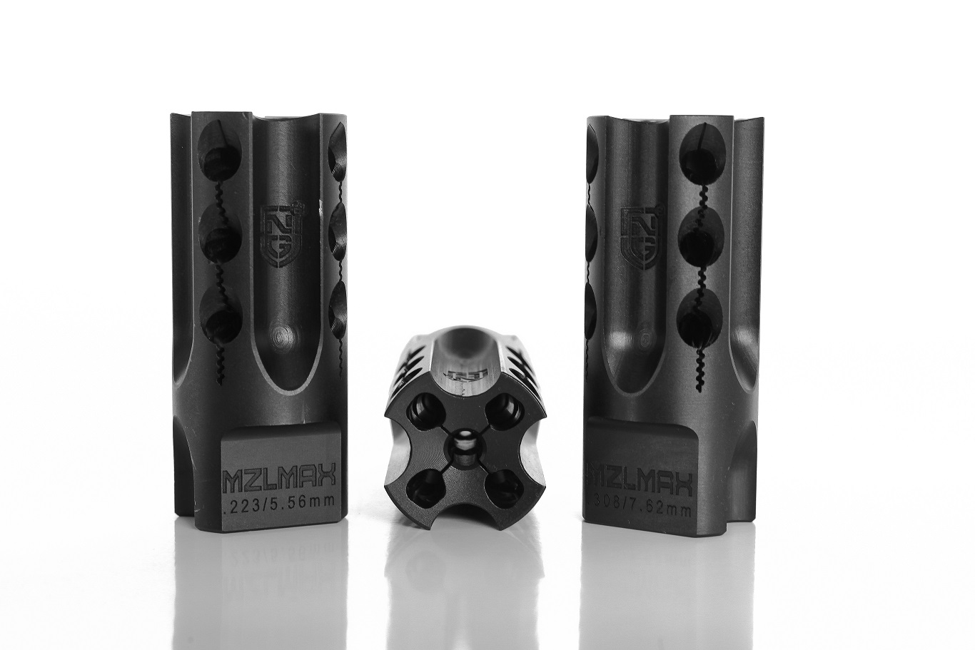

What’s the best Muzzle break for the M1A? Has anyone tried using an adapter and non M1A muzzle break? I was thinking of getting the NG2 MZLMAX (works as muzzle break and flash hider) and fitting with an adapter vs the regular M1A muzzle break.

Best brake is their factory brake. It's reamed to NM specs. If you have a flash hider that is NM then just keep that. Unless you have some special need like a certain suppressor attachment just leave it alone.
