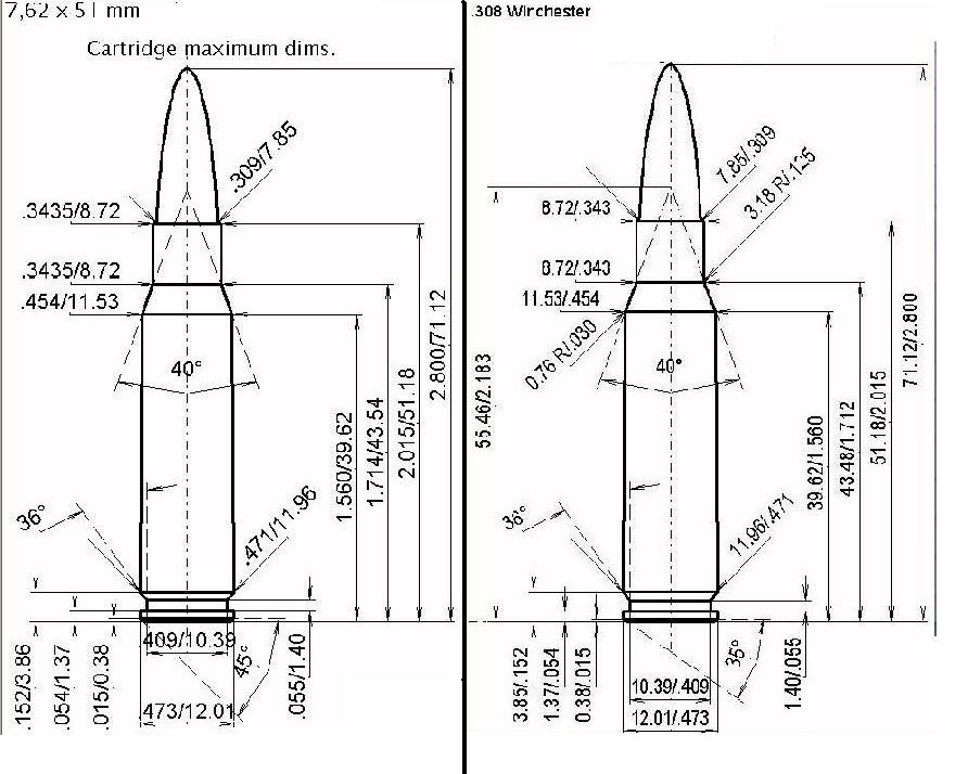

Show me on this chart where they are different dimensionally. Chambers may vary slightly, and yes, the pressures are slightly different as well as case thickness, but externally the cases are the same.
I could have specifically said "chambers." But, the "chambers" are dimensionally different enough that I have two .308 win rifles that won't even begin to chamber a 7.62x51 NATO round. And, the difference in pressure is enough that my HK-91 will blow primers out of their pockets if you try to shoot .308 win in it. They are different. And, the difference is probably why the two M1A's that I've fired shot tighter groups with 7.62x51 than they did with .308 win.
