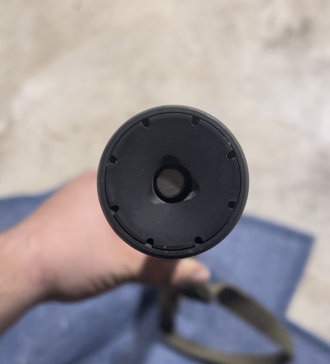

Hello everyone I’m looking for some answers here I’m lost.
I bought an M1a and I’ve been on a mission to suppress it. I got an adjustable gas plug, and a smith enterprise thread adapter. I also have a keymo adapter for my sandman L.
I timed everything it seems solid I went to fire it through my suppressor and now we have a problem. Unsuppressed my groups are tight. Suppressed my rifle won’t group. Upon inspection it appears there is a glance on my end cap there is also copper flakes on my keymo adapter.
To be clear there are no markings or glances off my smith enterprise or my keymo muzzle brake. Just on my end cap.
Photos are attached.
Thanks

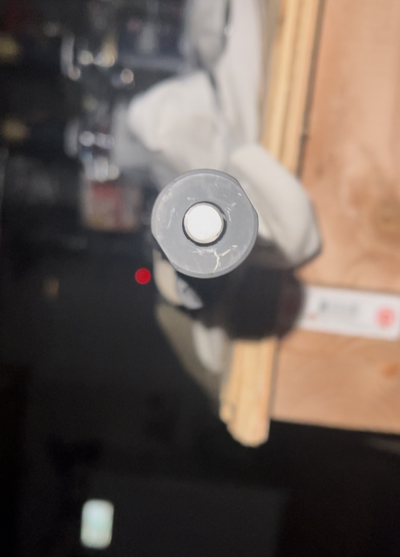

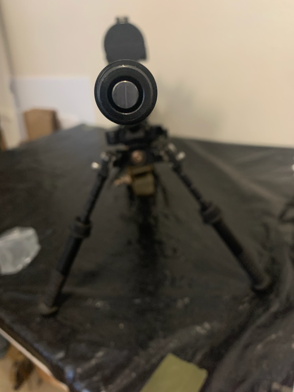

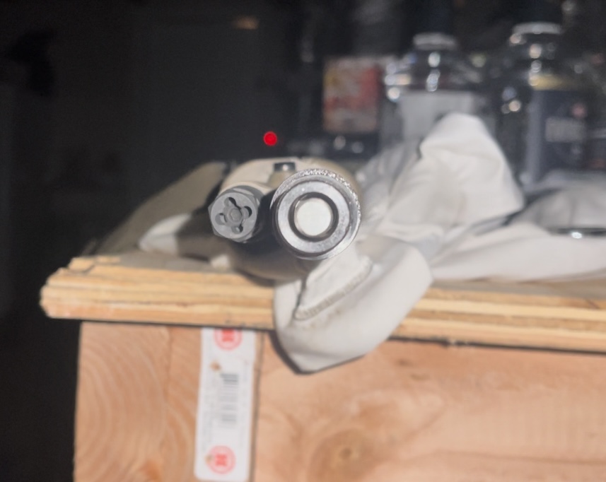

Alright guys the saga continues!!!!
Hughes adapter is a work of art wish I would’ve went this way off the get go.
This is beautiful and centered at least it looks that way to me. Yes I did buy the over priced alignment rod. But it is the perfect tool for the job. So here I’m excited and thinking all is well and I have been saved by Hughes precision but then….
This made me a little nervous with the dead air muzzle break……
This is the can on. This is what it looked like before when I got my end cap strike. Any thoughts?
My conclusion is that it is either a thread issue with Dead Airs brake, or it’s something wrong with the rifle itself. (Barrel cut incorrectly?threaded barrel is out of spec?) ?????

Alright guys for the conclusion of this rifle. It will have to go back to Springfield for the barrel to be recut. After switching every single part out and trying a whole different mount system. I’m still seeing the same issue. It appeared to be very close with the alignment rod. And after firing a round I received another light end-cap strike.
Thanks for all of your help.
