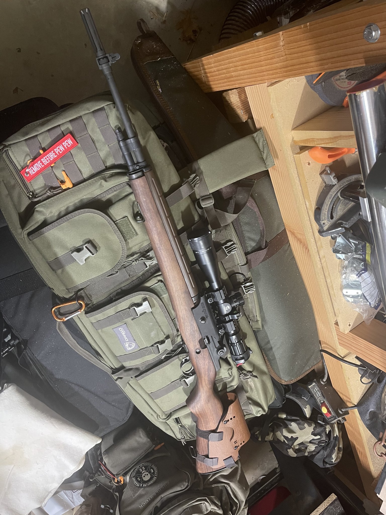

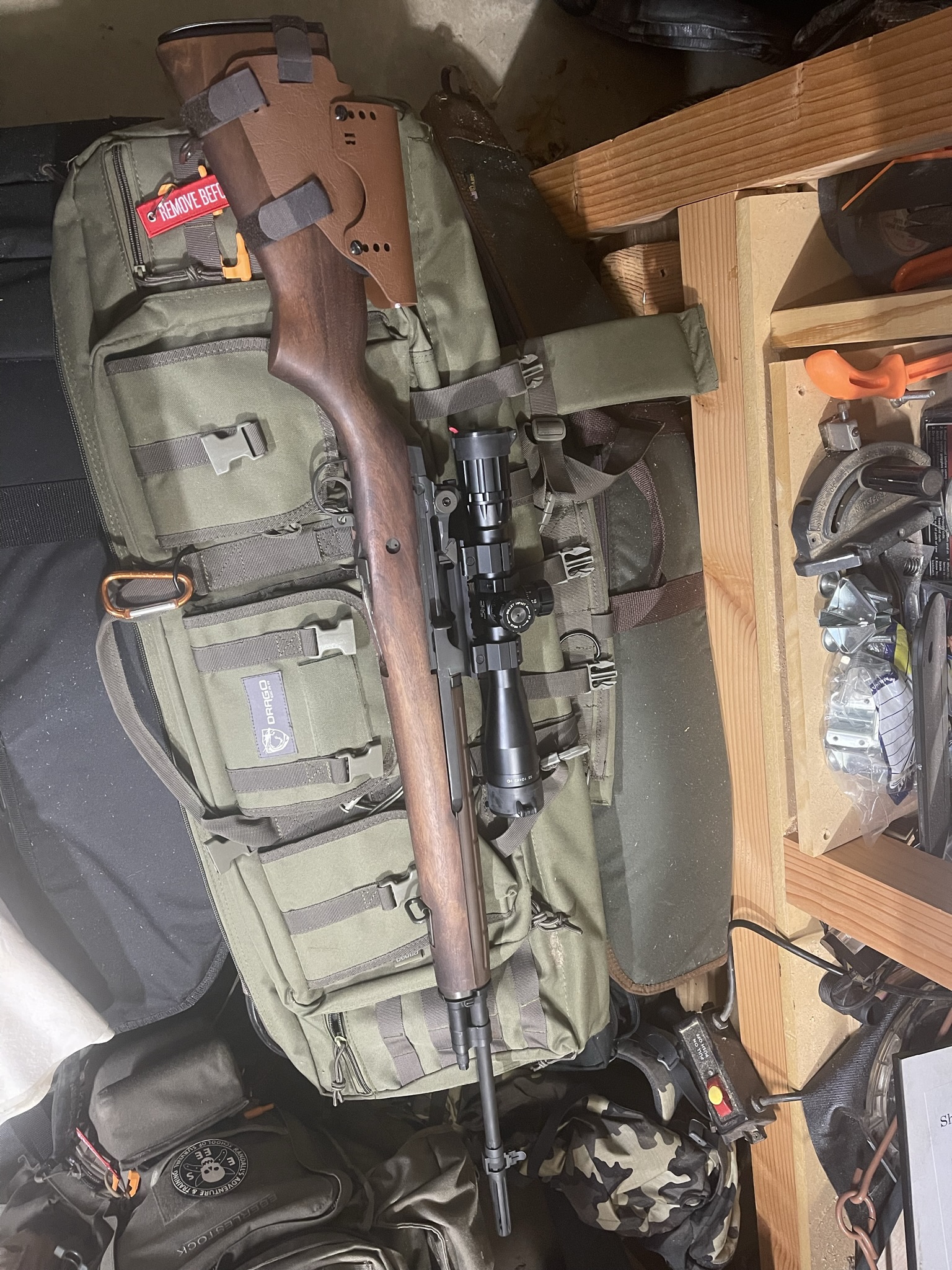

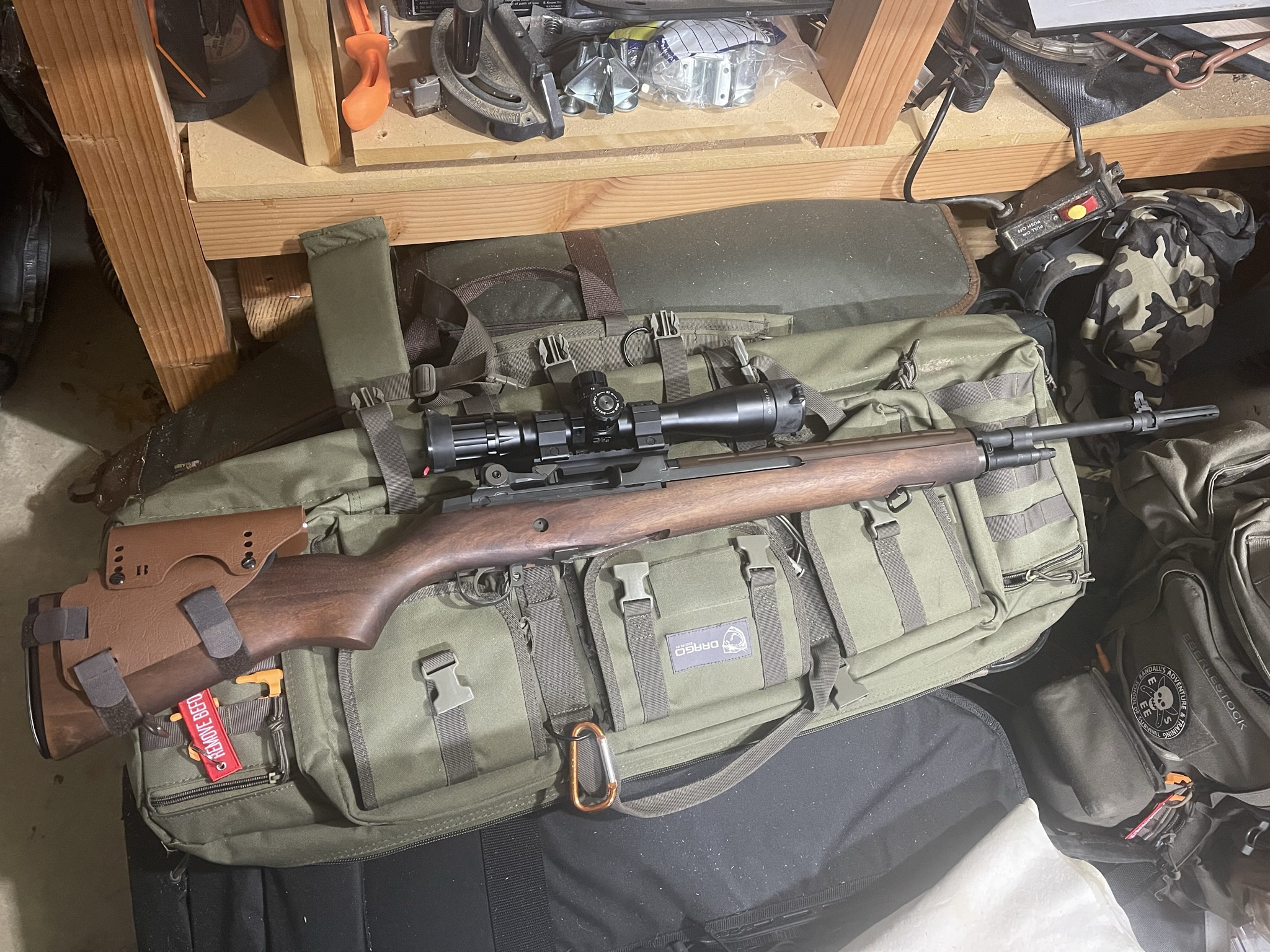

Bradley Adjustable cheek rest. As far as a scope that Viper would be decent, the Nightforce variable scopes in that range are pretty good too.
NY700,
What height and brand are those rings? I have a SWFA 12x and had to remove the entire rear sight assembly to clear the eyepiece.
NY700,
I’m pretty sure they are the Burris tactical rings I’m not positive on the height.
For years the SWFA 10x have been sitting in them and it’s my grab and go scope when ever a buddy needs to borrow a scope or I’m just messing around with some new rifle.

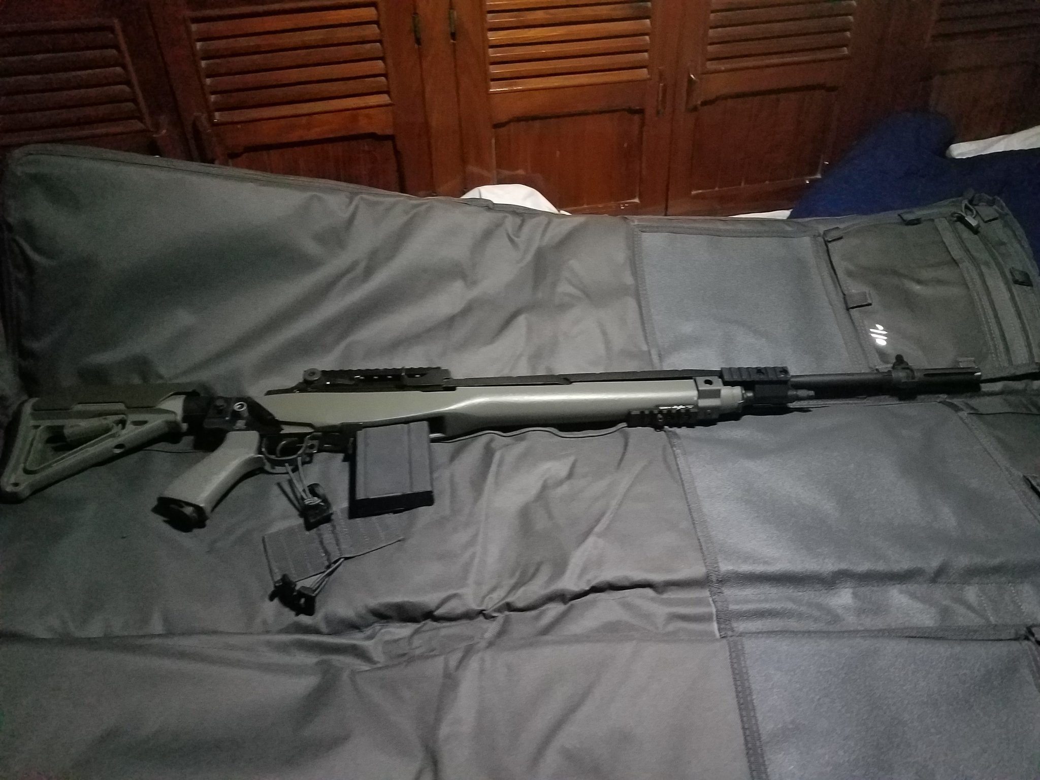

Just purchased an M1A Loaded with VLTOR Mod Stock.
Decided to take it out just to run some rounds through it. Due to an error in scope mount purchase, we stuck an old cheap ass scope off an air rifle on it and hit the range. Due to the height of the rail mount and the scope mount, took 20 rounds of Fiochi SMK 168 gr to even get the scope remotely dialled in at 100 yds. Then shot some Federal Premium grade 175's. Shot so so. Followed up with some of my buddy's hand loads also SMK 175's less so so.
Went back to my last 3 rounds of the Fiochi. 1 MOA with 2 of the 3 @ 1/2 moa. Basically same hole. Wonder what can this thing do with a decent scope
Looking at an Athlon Ares BTR 4.5-27x50 with APRL4 reticle with floating zero.
Impressed so far.
Reactions: deltawiskey
