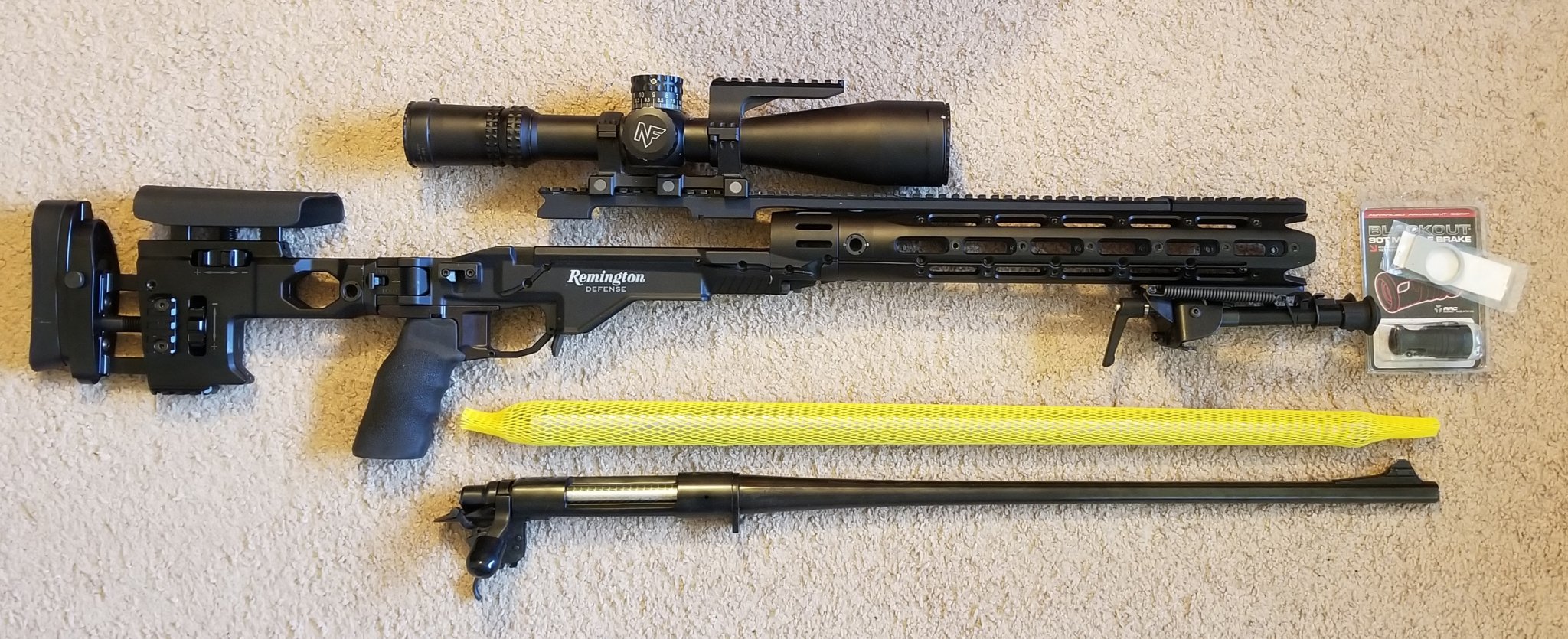

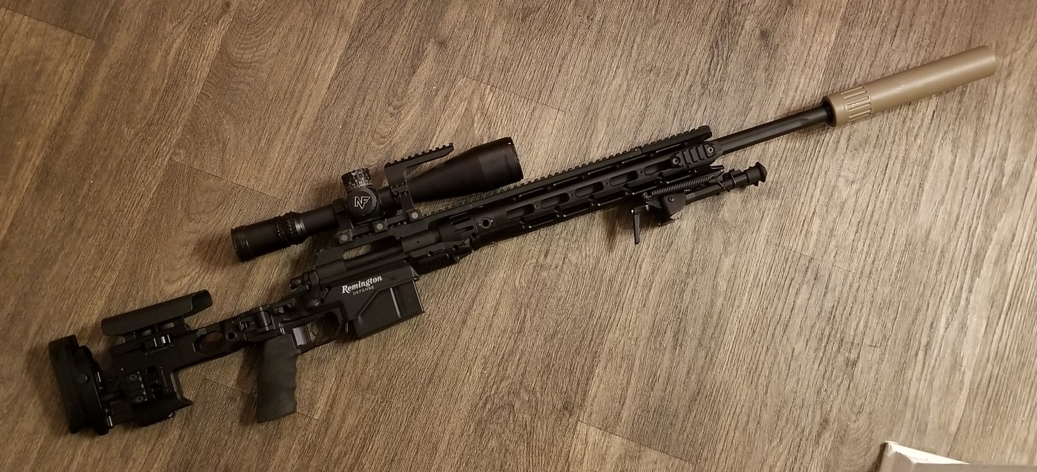

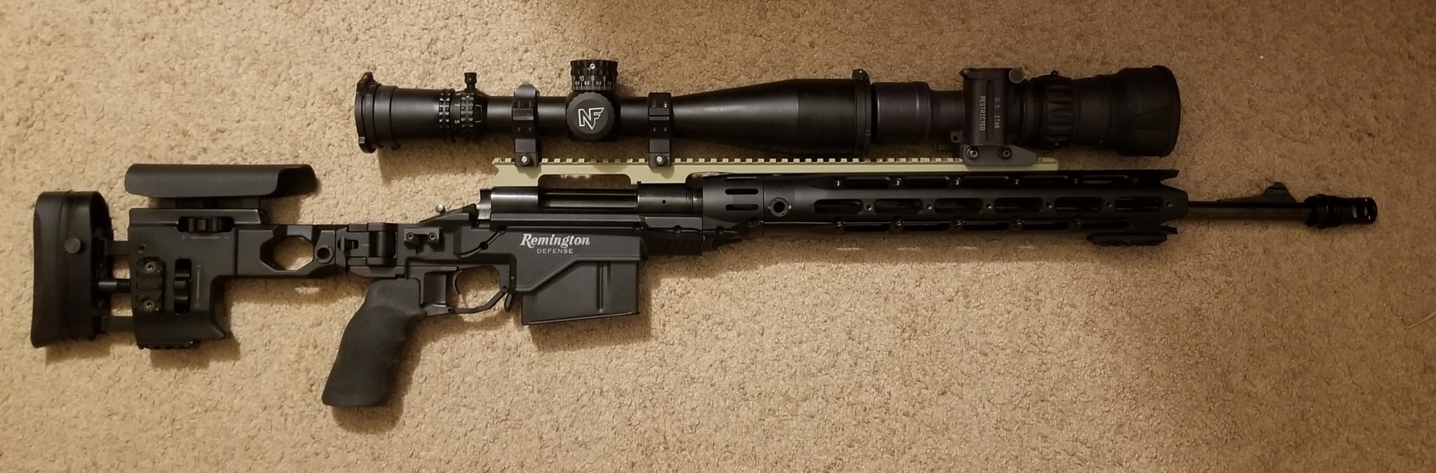

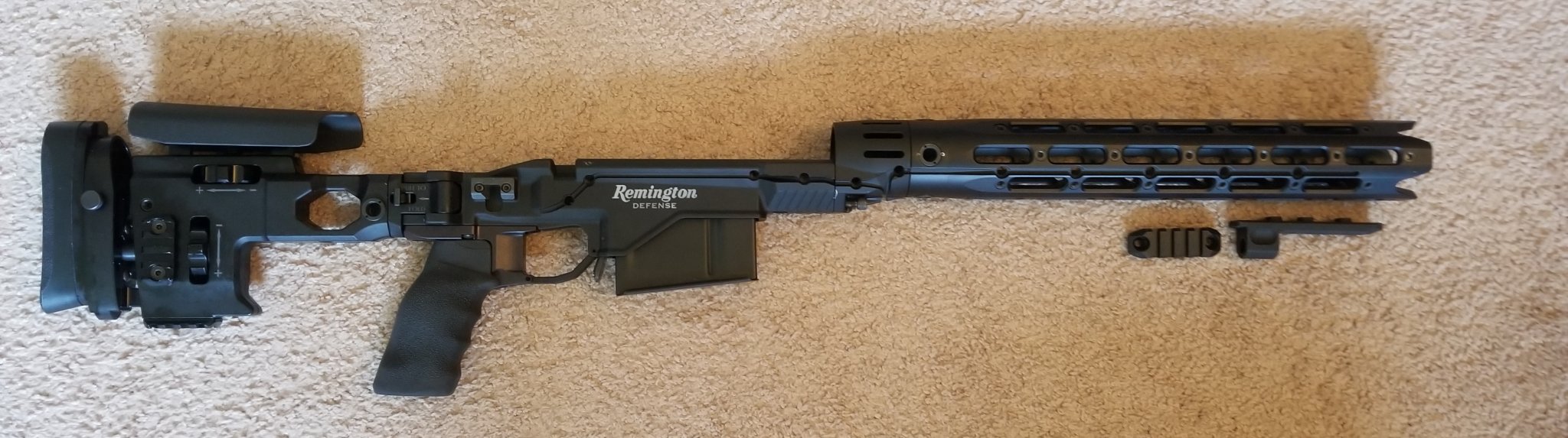

This probably won't be too popular due to scarcity of parts. That being said, any help would be appreciated. I have a RACS chassis on hand and C prefix 700 coming. I know it needs an m24 trigger, the only thing I can't figure out is the barrel contour. My guess is AMU, but my Google-fu is coming up short.
I haven't forgotten about this thread. Cadex was able to help me out with a hinge pin. Found a racs top rail that is a couple slots too short, still working out a solution there. Bartlein is spinning the barrel soon, and the aac titan QD is pending. It's coming along nicely though.

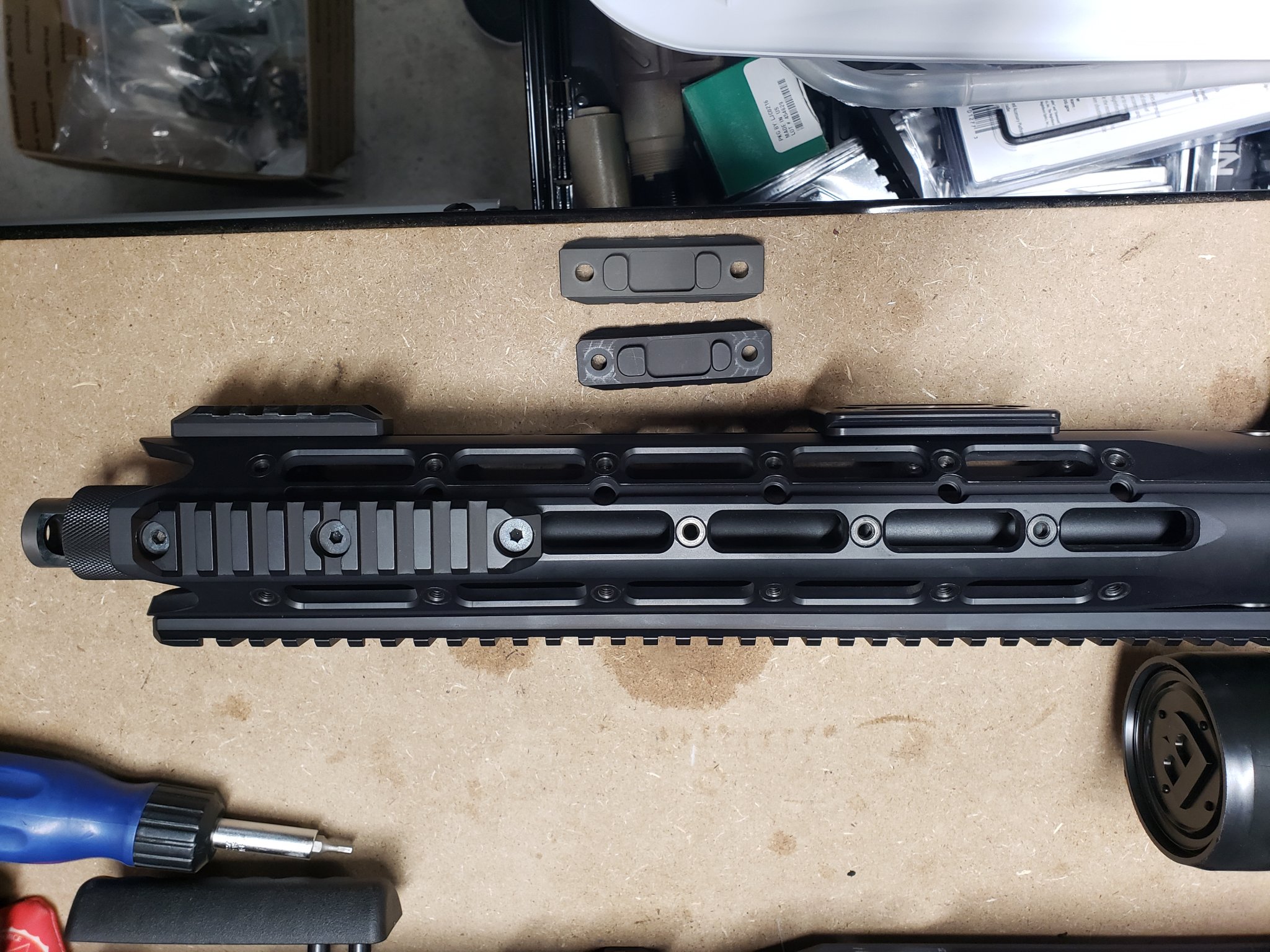

I’m trying to repair my M2010 and run into another issue. The two Allen head screws that hold the forehand together pulled the thread insert and stripped it. Now I’m not only needing a replacement rail but a new thread insert. Now with Remington out of the market I’ve got a $7k paperweight
Best bet would be to have them tapped for larger helicoils
