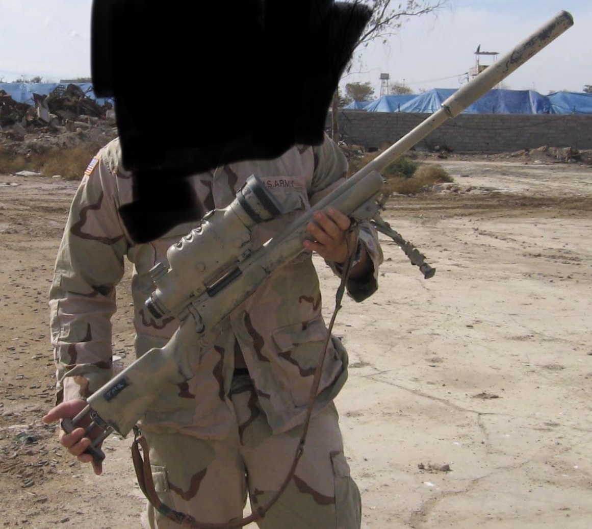

With the PVS 10 it was more manageble without. With a leupy a Stock pad with foam mat/puss pad underneath was best Depends on how you position your face. Chin vs high cheek I suppose
Puss pad and or green sock with greeen 100 mph tape. Was the move back in the day as mentioned above.
