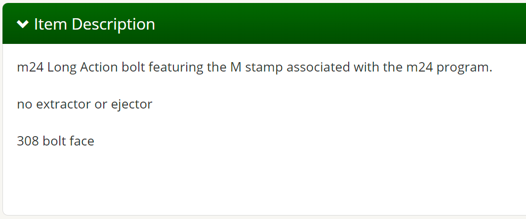

Nice! I figured I would be the only one bidding on that lol. Did you get an m24 bolt from them as well? They have a few.
Oh are you the bidder with 74 rates or the NR? I feel reluctant to get their bolt missing extractor and ejector. I would rather get the one from gunrepaircenter on eBay. They sell the same stuff on GB, but it charges way too much compared to eBay.
Haha I was the first bidder. Got to rich for my blood.
The bolts come complete. I’ve ordered 2 and they had everything. If you are throwing this together it needs an m24 bolt.

if this is what you are referring, this is their description:
The m stamping on the handle And the sandstorm coating (grey color) on the bolt body.
If you call JFE you can get the bolts for cheaper. That thing 100% needs that bolt. Might as well do it right.
OMG would the BA be cheaper if I called them instead? I think gunbroker does not allow that since the item is up for auction.
I guess this could also work. I would be too lazy to find an extra extractor and ejector for a $390+ bidding bolt, lol.
