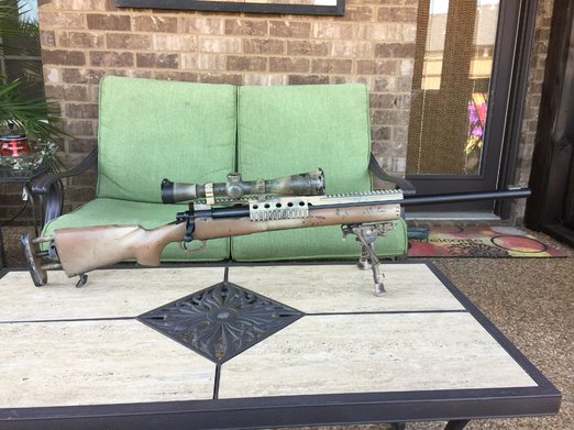

I hope no one minds but I have a few questions about the M24 myself. I have acquired the M24 SWS rebuild rifle for myself. I have also picked up the Ultra M3A for the rifle. I added the MIRS M24 Rail but not sure if I should keep it on there.
I have the rear site on order and I am looking for the front site that I understand to be the OK Weber sight. Any hints one where to find one?
Just for your opinions , here is my new stick.

Thanks you and will do. I have taken it out only to Zero the rifle. I found out my loads were too hot or my bullets were too long. I was out of 175 smk's and used TMK's. POI was about 1.5 to 2" high at 100 yards. Another trick is that I am shooting yards and not meters which is what the scope is set up for. I will say I had a 1" group at 200 yards it was just at the very top of the target... LOL
I am loading up some ammo now.
Federal GMM brass / 175 SMK's / 41.7gr IMR 4064 / OAL: 2.81-2.82
I will let ya know the results. I have a feeling I may still get too much speed. seeing this is a load I have seen in LC brass.
