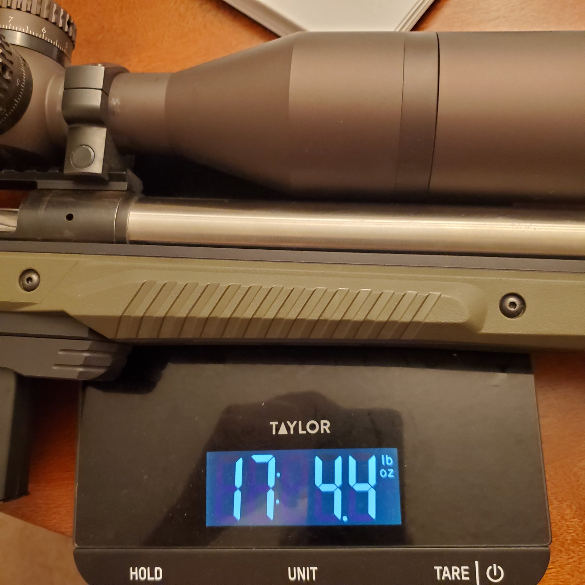

This is an M24 profile Bartlein 28" barrel, in an aluminum chassis over 17 lbs with everything mag, muzzle brake, and heavy 3 lb scope. It's in 6 Dasher and a pleasure to shoot. A shorter 24" M24 in 308 would be just a little lighter...this is about 14 lbs without the scope.
