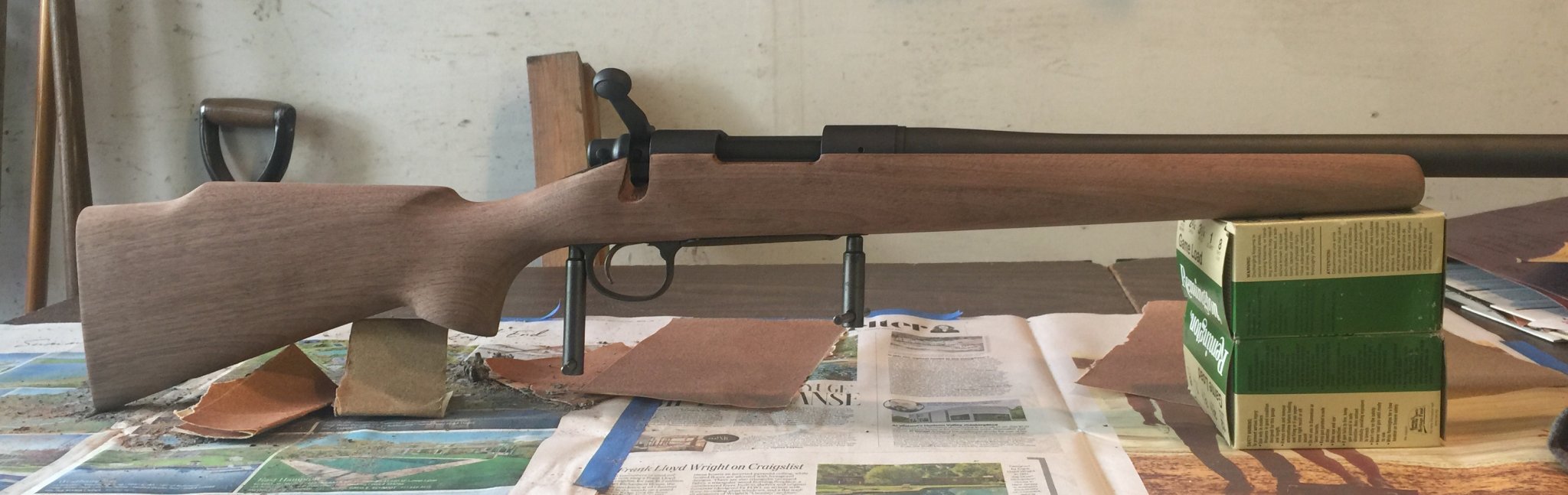

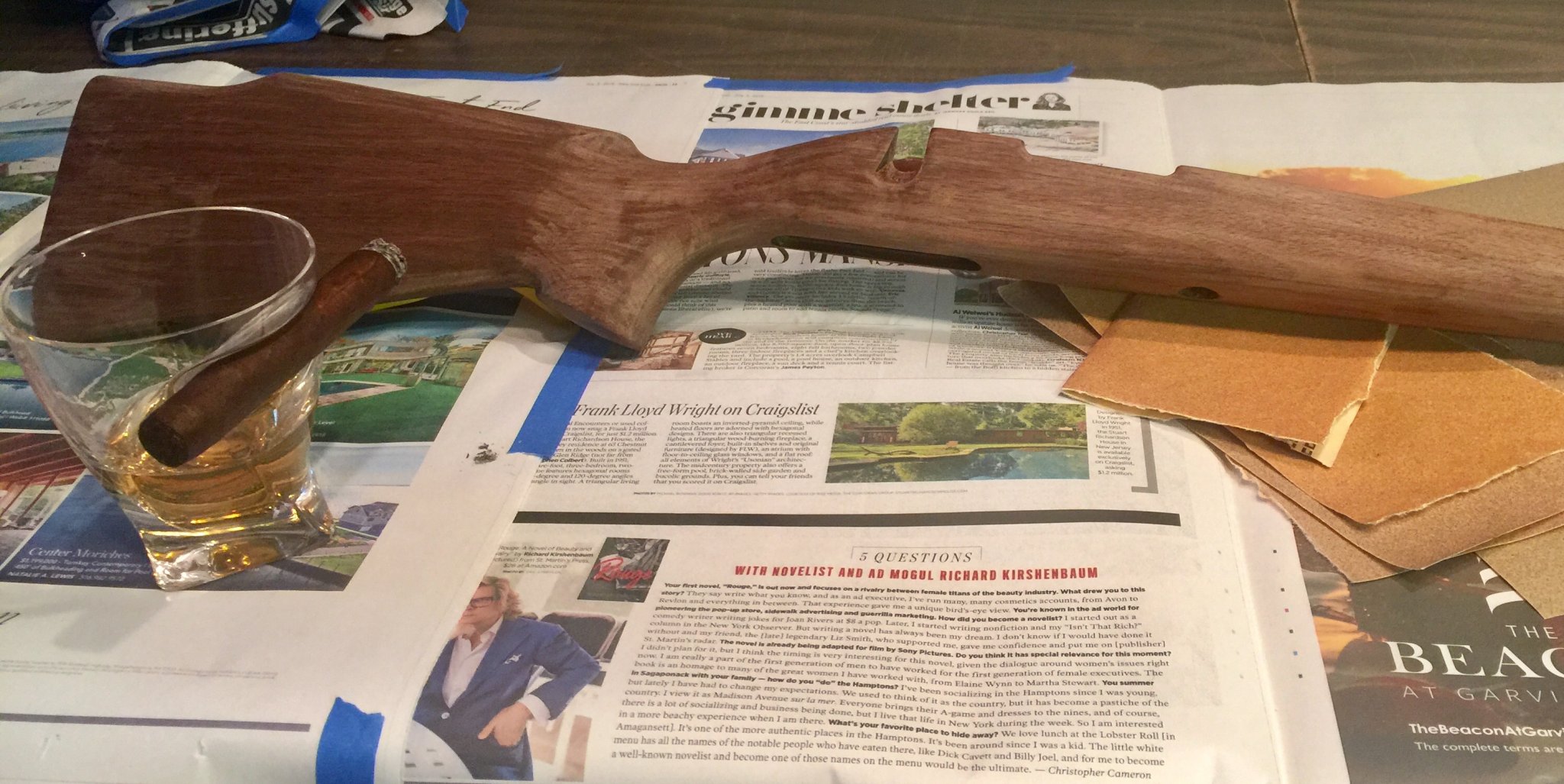

I started my M40 copy project finally. got an adl stock off ebay, had the bottom metal already, Badger mount, I have achoice in glass either a Leupold greenie, or a redfield 3x9 with the correct reticle. I got a 700 308 varmint from Field and Stream.

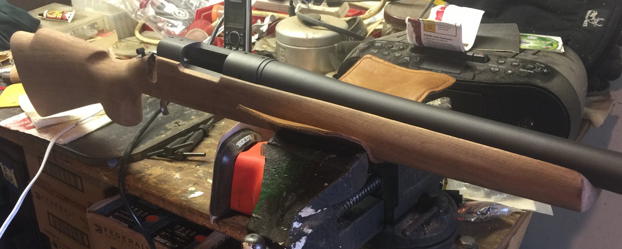

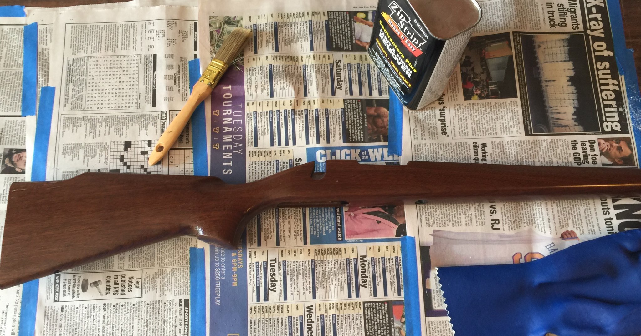

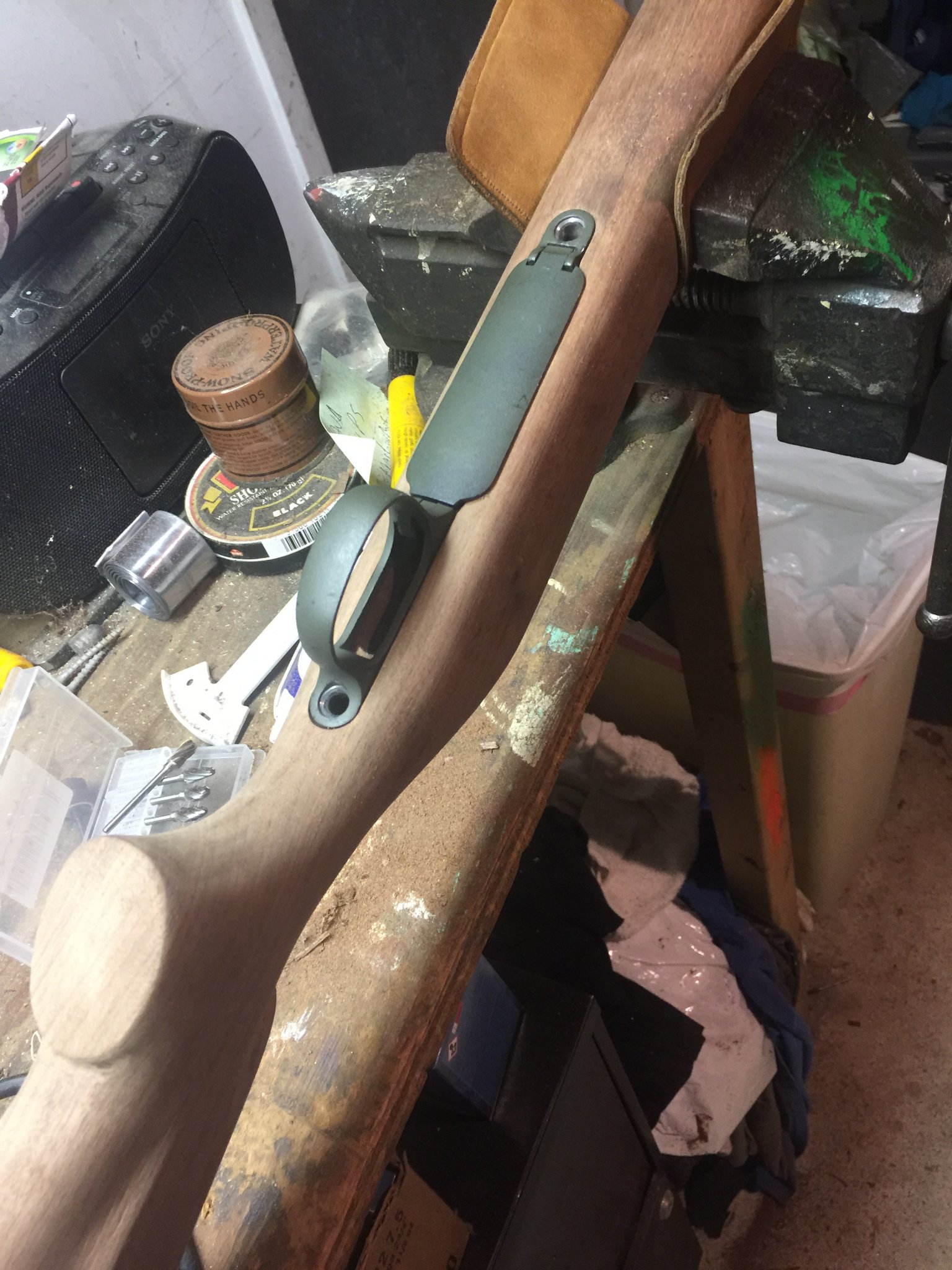

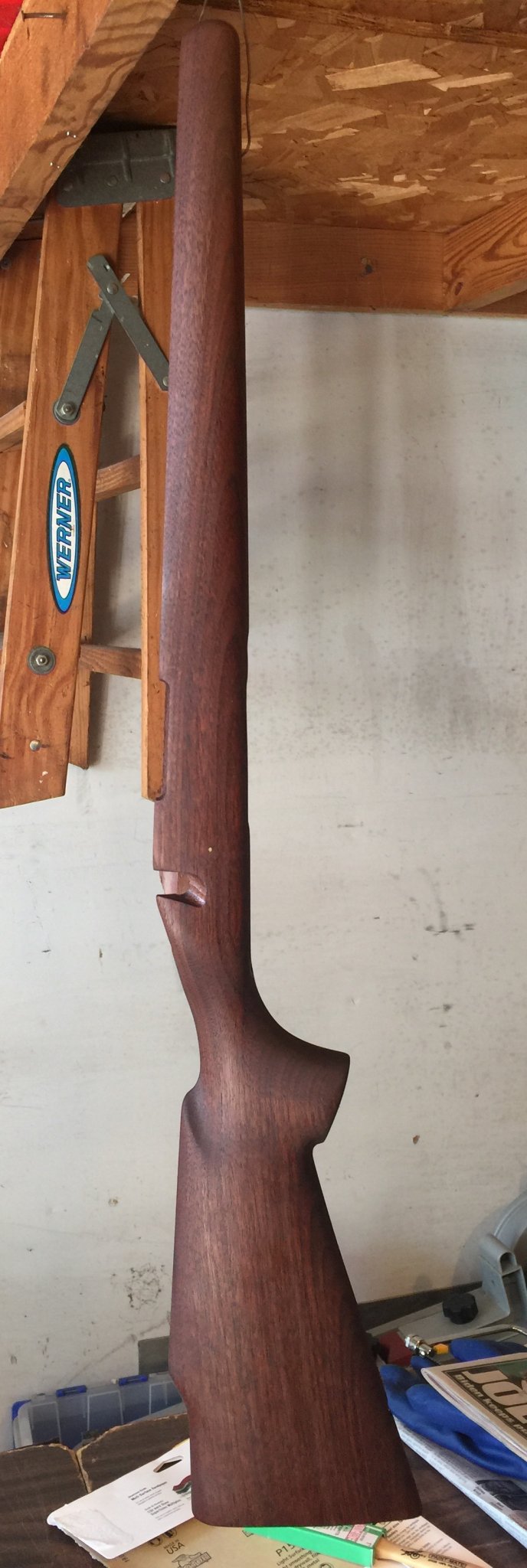

So it begins IMG_E3031.JPG stock is stripped and first sanding done, time to inlet the barrel,IMG_E3077.JPGI need to inlet the bottom metal , finish sand and oil,then get the barrel cut to 24" and parkerized. For now I'll have to go with the cheesy plastic buttplate. Good thing my landlord is at Camp Perry, his garage is awash in rifle parts, sandpaper, and sawdust.
Stripping that original Remington RKW finish is no easy task.

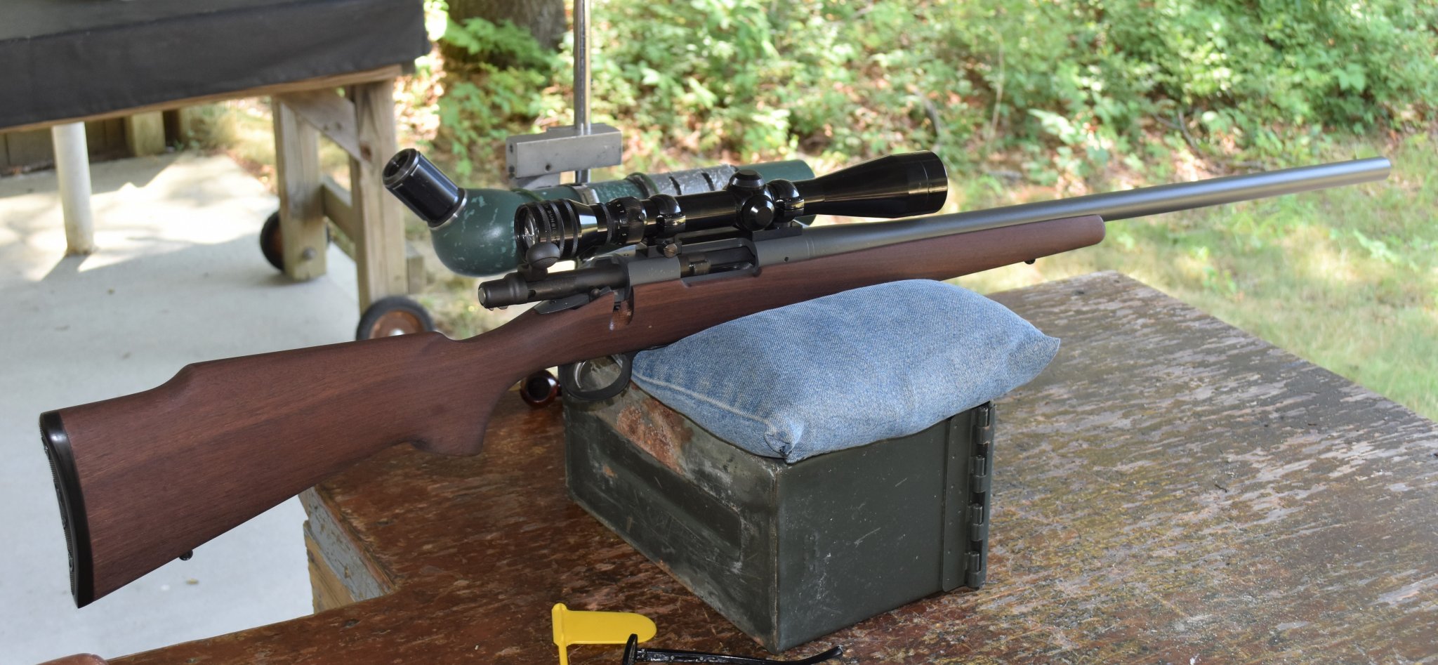

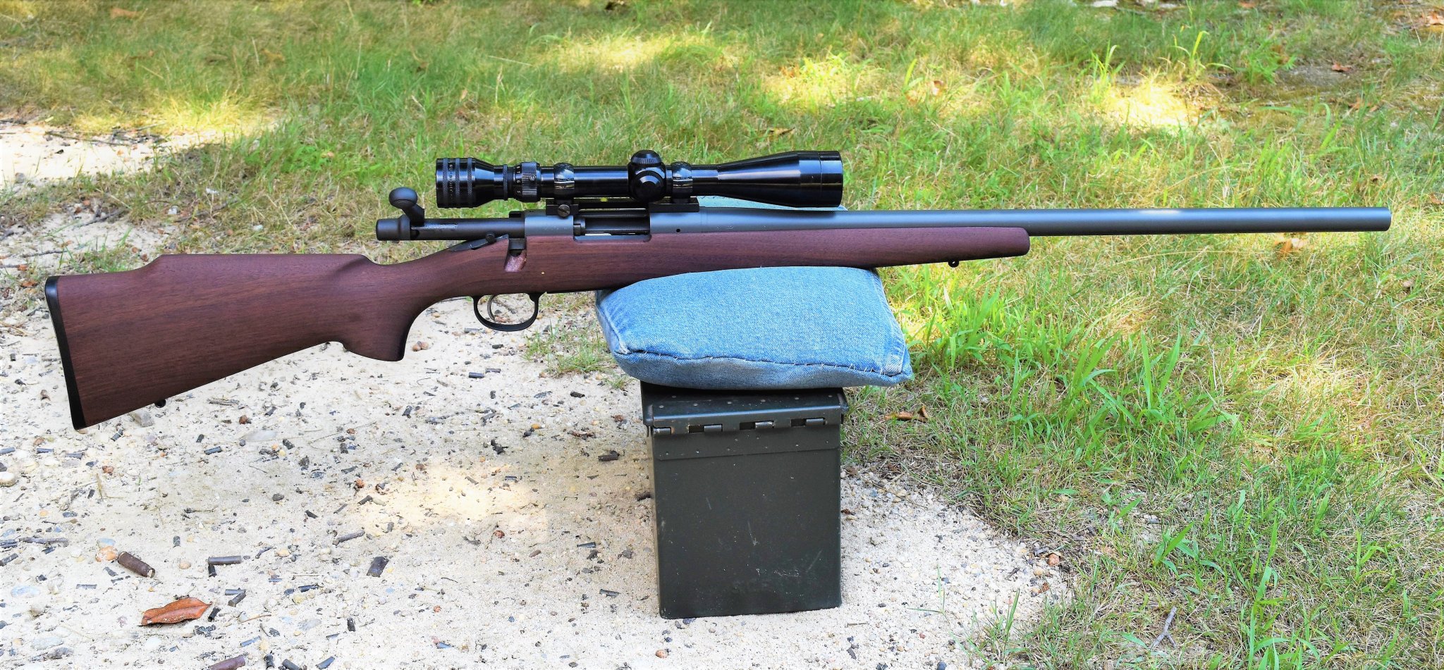

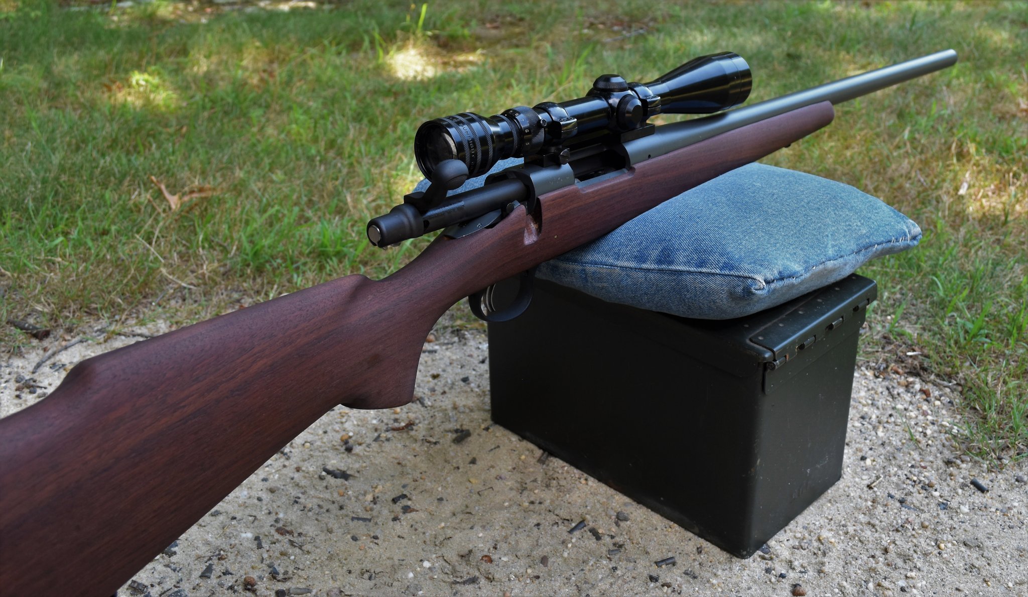

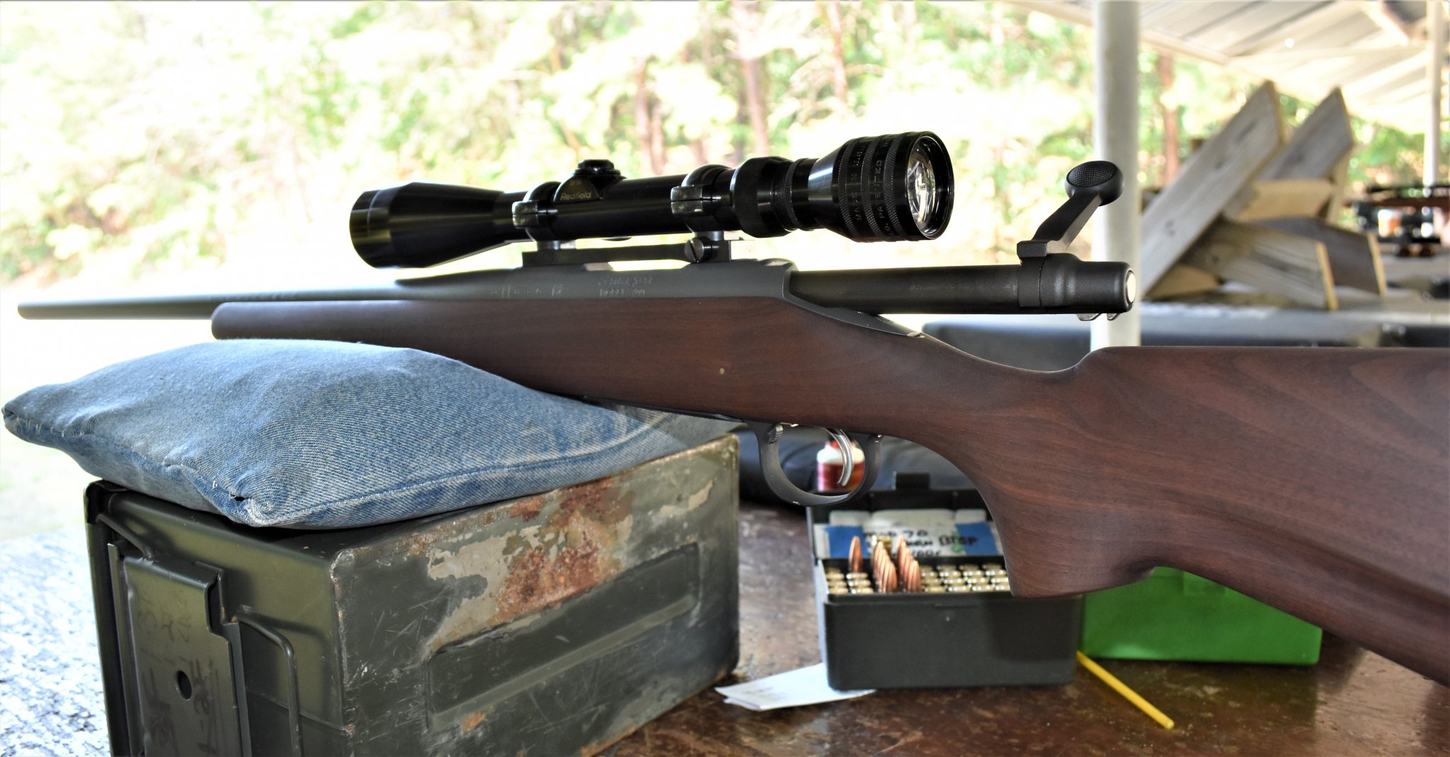

At long last it was range day.DSC_0068.JPGDSC_0066.JPGI went with the redfield scope, the Leupold greenie is staying on my 223 for now. I was not disappointed with the Redfield optics.
After putting it together I had to redo my inletting in the barrel channel, I had the stock in a leather pad in the vice. Poor choice of material, the leather drew the oil out of the stock leaving two ugly marks on the forend. I spent a couple days re-oiling my wood... Then I discovered the bottom metal was causing a hangup so that had to be fixed, more inletting- no leather this time!
I duracoated the barreled action, wasn't real happy with the results, looks s little on the shiny side. I got a metal buttplate off ebay but it was crooked going on and will need some serious work to fit. That's a project for later.

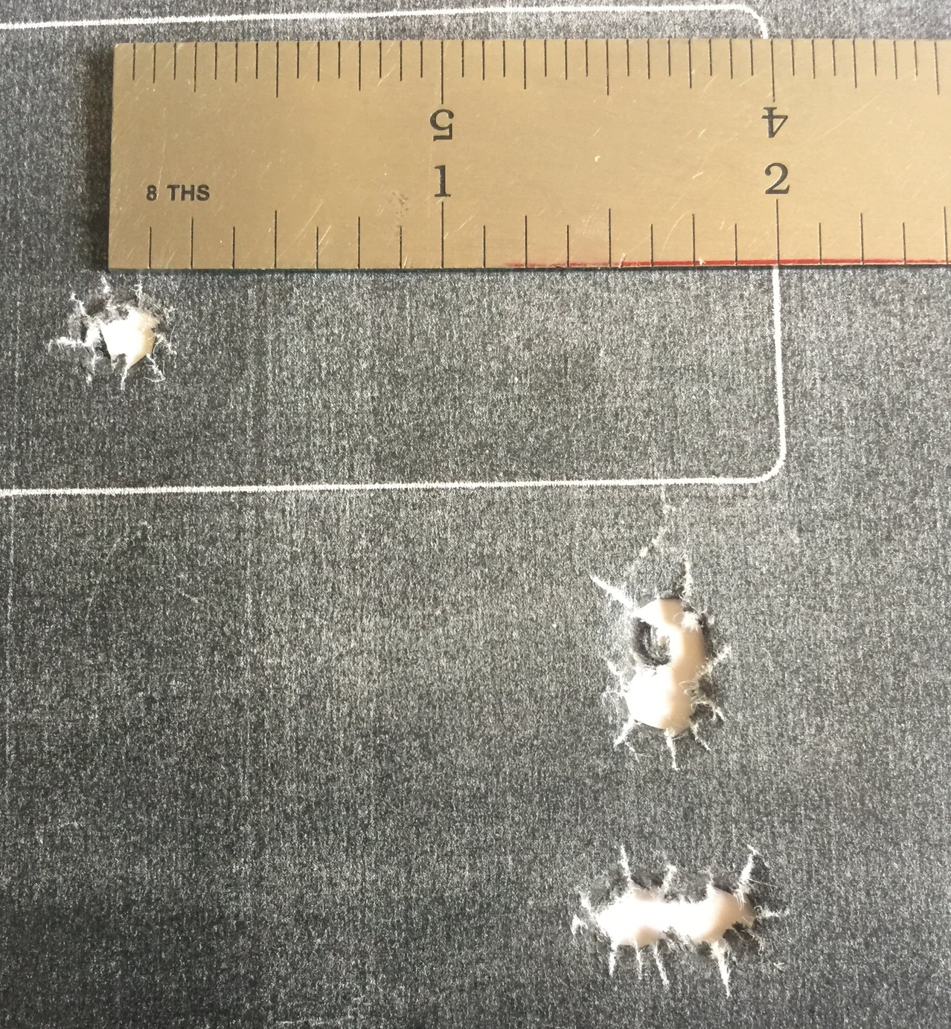

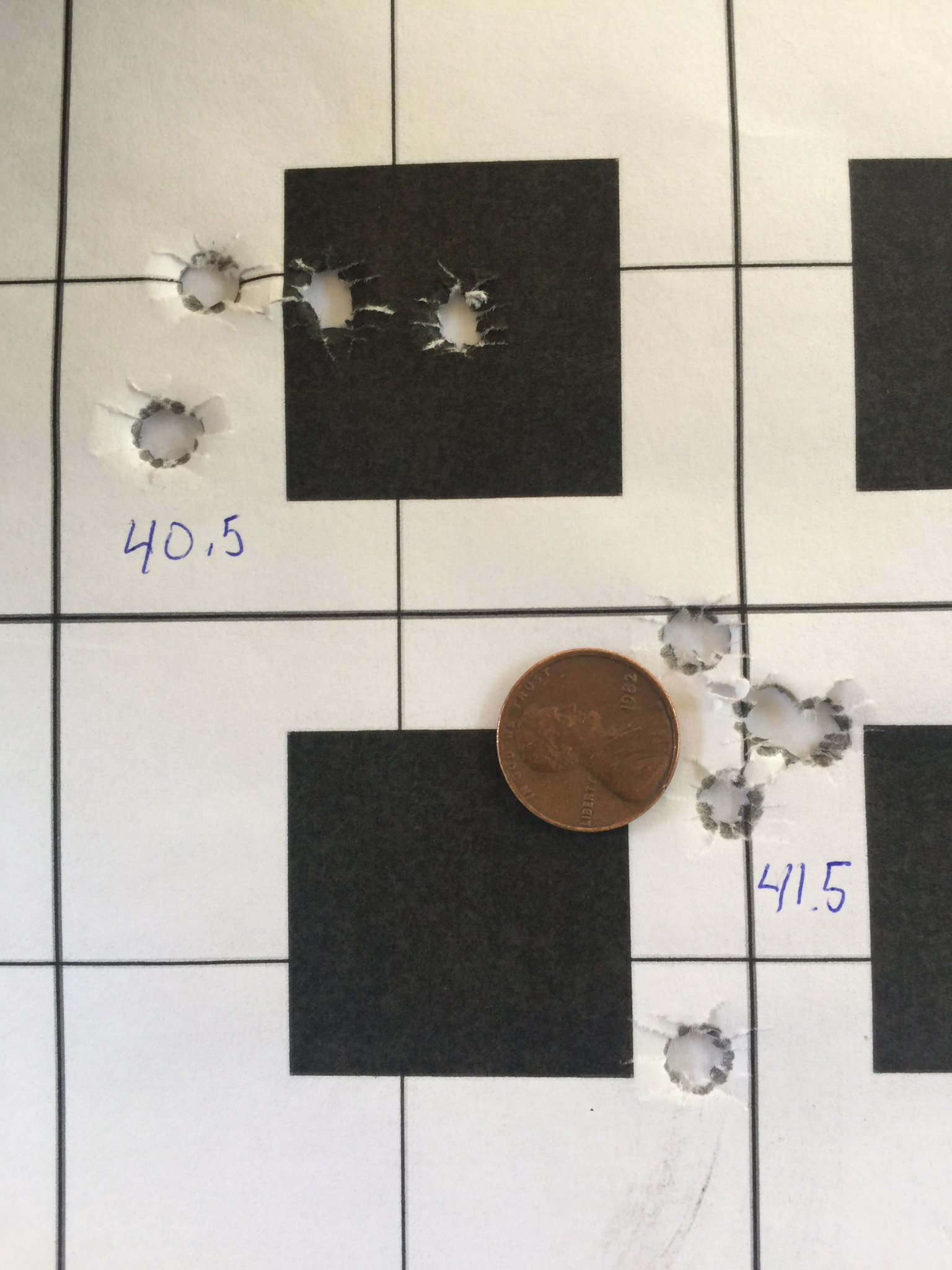

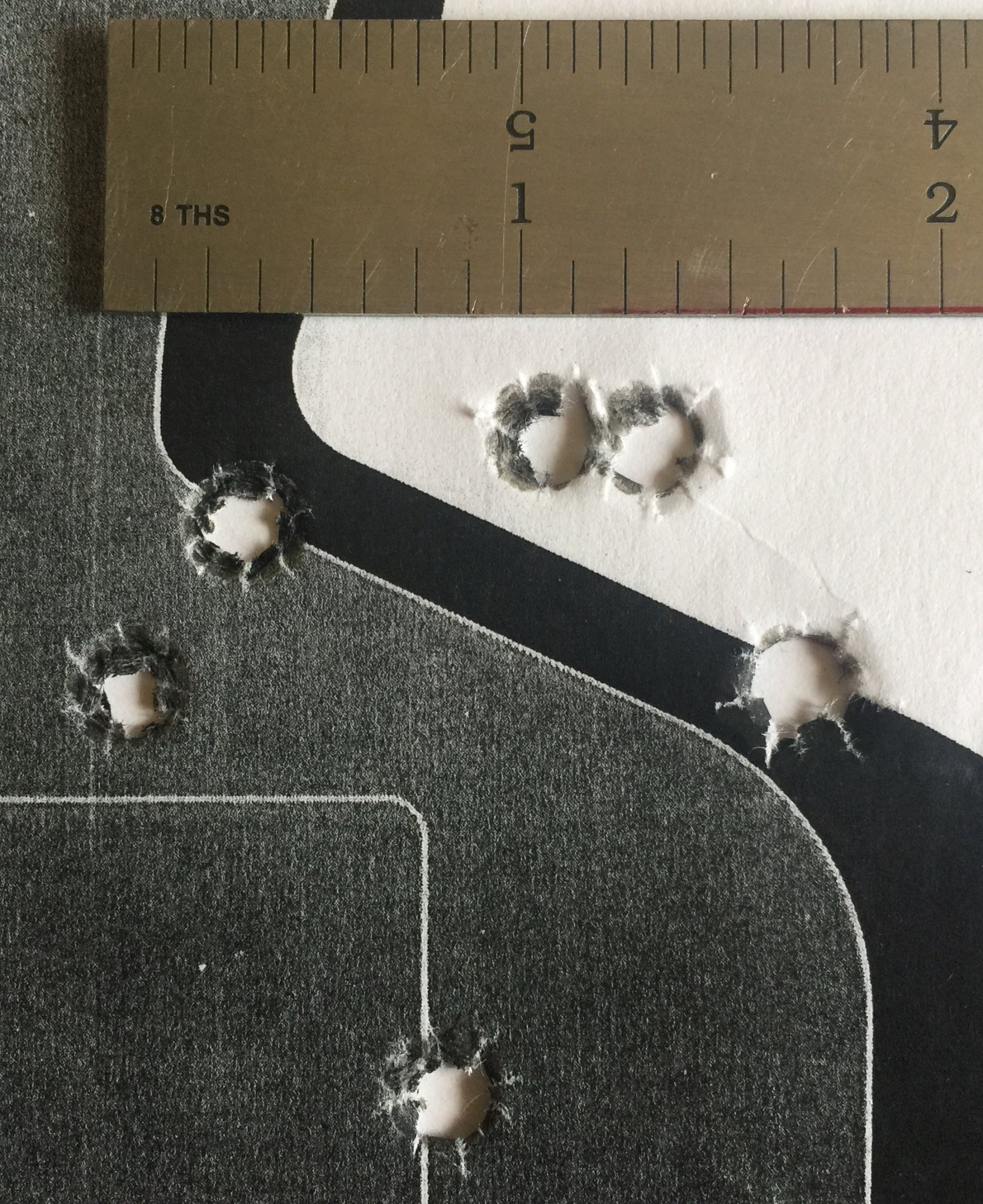

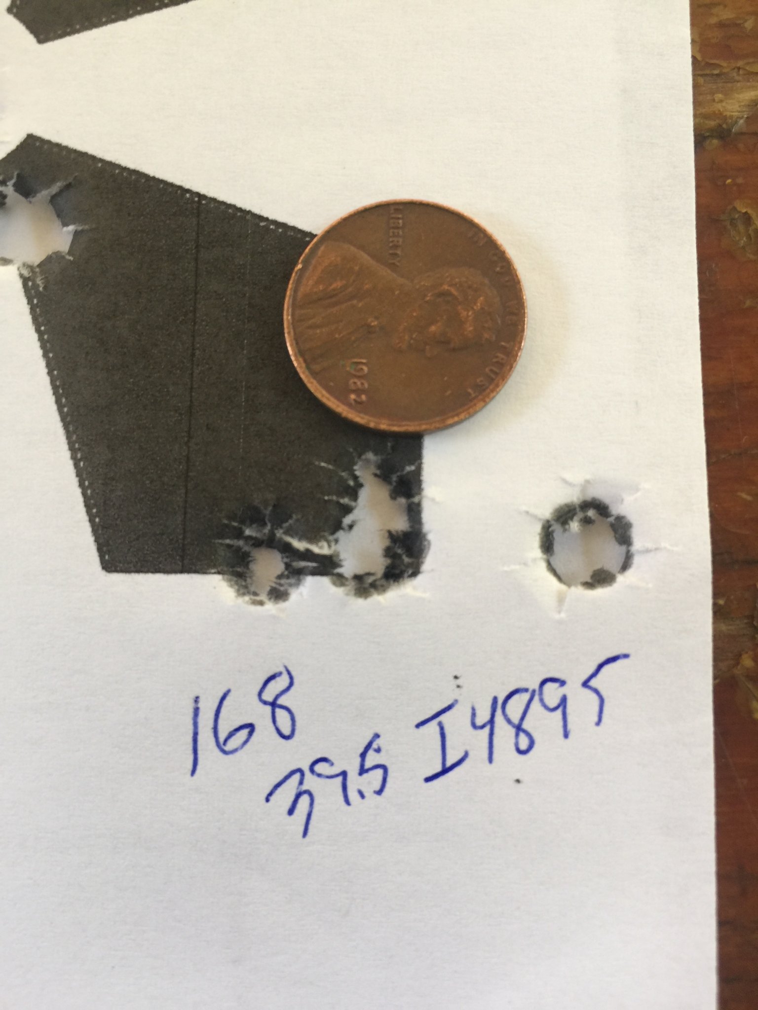

After a few warmup shots I tried some handloads. LC Match brass IMR 4895 168 smk's IMG_3196.JPGIMG_3197.JPG
I was pretty happy with the results. It's the first 20 or so shots from a new barrel, so I didn't expect much. The rifle will eventually be pillared and bedded.

Also, any idea what timeframe that stock came from? I've never seen an ADL with no pressed in checkering. Boy, would that be a pain in the ass to take out!! 722's were plain, but they were long before the DuPont finish on all 700's I remember.
Thing about that stock that strikes me is - no ebony fore tip.
Most of the 700s had that dark wood nose cap.
Only non ebony stocks Ive seen, without searching, were mil or police stocks.
Yet those didnt have checkering and yours did...
The ebony fore-end tip was found on the 721/722 deluxe then BDL. Yes, BDL's came before the 700. Also, later in production, but before the 700, was the 725 model. Even the 725 had variations on how embellished they came.
When the 700 series started, they had pressed checkering on ADL/BDL. But, the BDL had the ebony tip.
Come to think of it, the Classic series did not have pressed checkering, or fore-end ebony tip. That might be a Classic stock.
