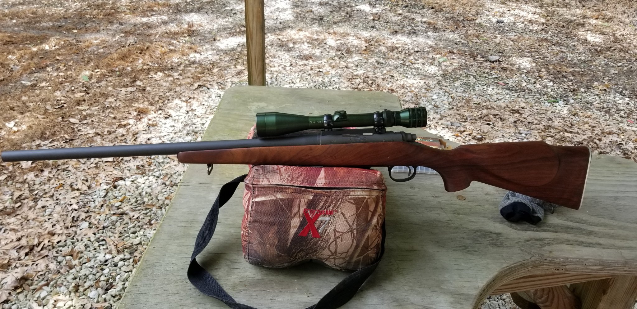

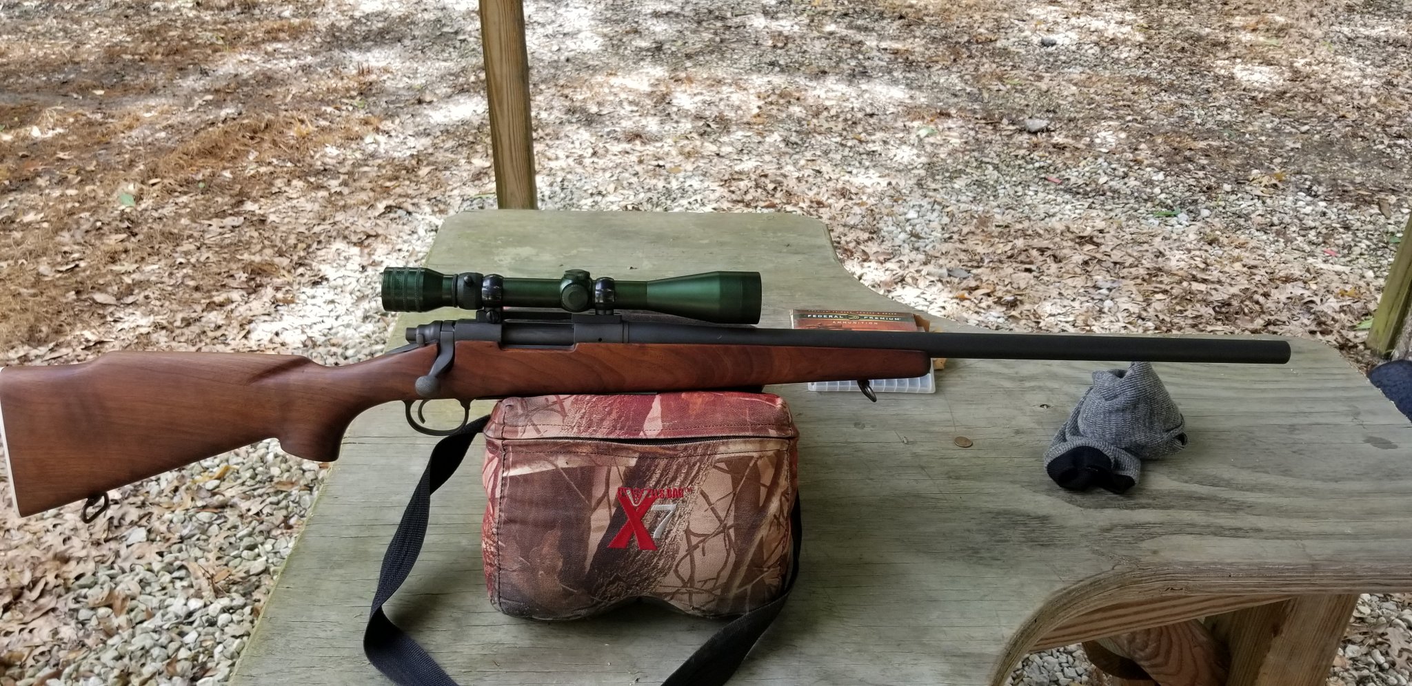

Well, putting the pieces together took longer than expected... but I couldn't be happier!
Build specs:
6 digit Remington 700 receiver, bolt, aluminum butplate, and trigger assembly.
Lija 1:10 remington varmint profile barrel
Toki finished period correct Redfield
Redfield "66" rings
Leupold 1 piece base
Remington 700 BDL stock (Ebay find) checkering removed, pillar/glass bedded, and finished with BLO.
Remington 513 swivels
I dont believe that there is a sexier looking rifle than the 40.

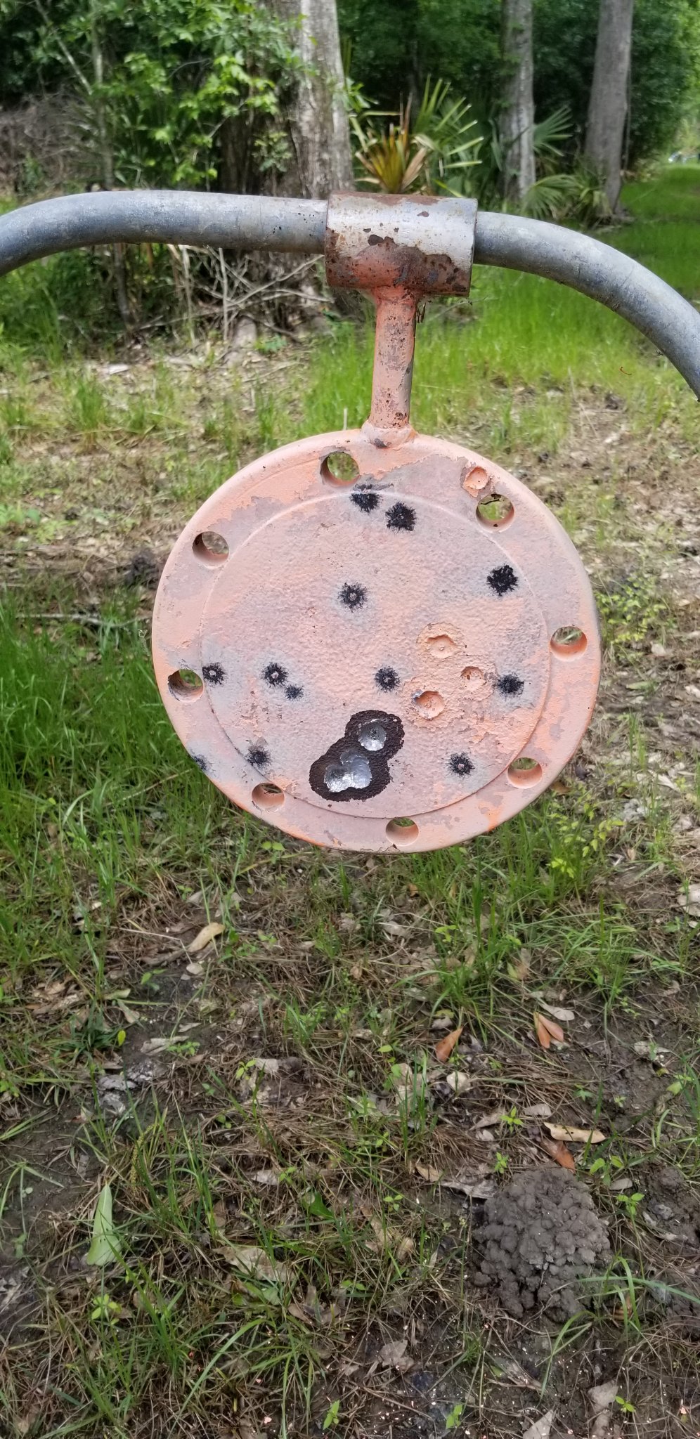

Below are the 1st 4 shots @ 100
with plane ole 168 gmm. I couldn't wait for my lapua brass to arrive.
Wow, congratulations, great build! There's lots of work in that stock I'm sure!
No doubt that the stock is a labor of love. Lots of time steaming out and sanding the checkering. Luckily I have a friend who was able to show me how to do the bedding. I was actually surprised how dark it came out with just the BLO. It finished out just like I wanted. It took 6 coats with lots of pressure and hand generated heat. I finished it with a couple of coats of paste wax.
