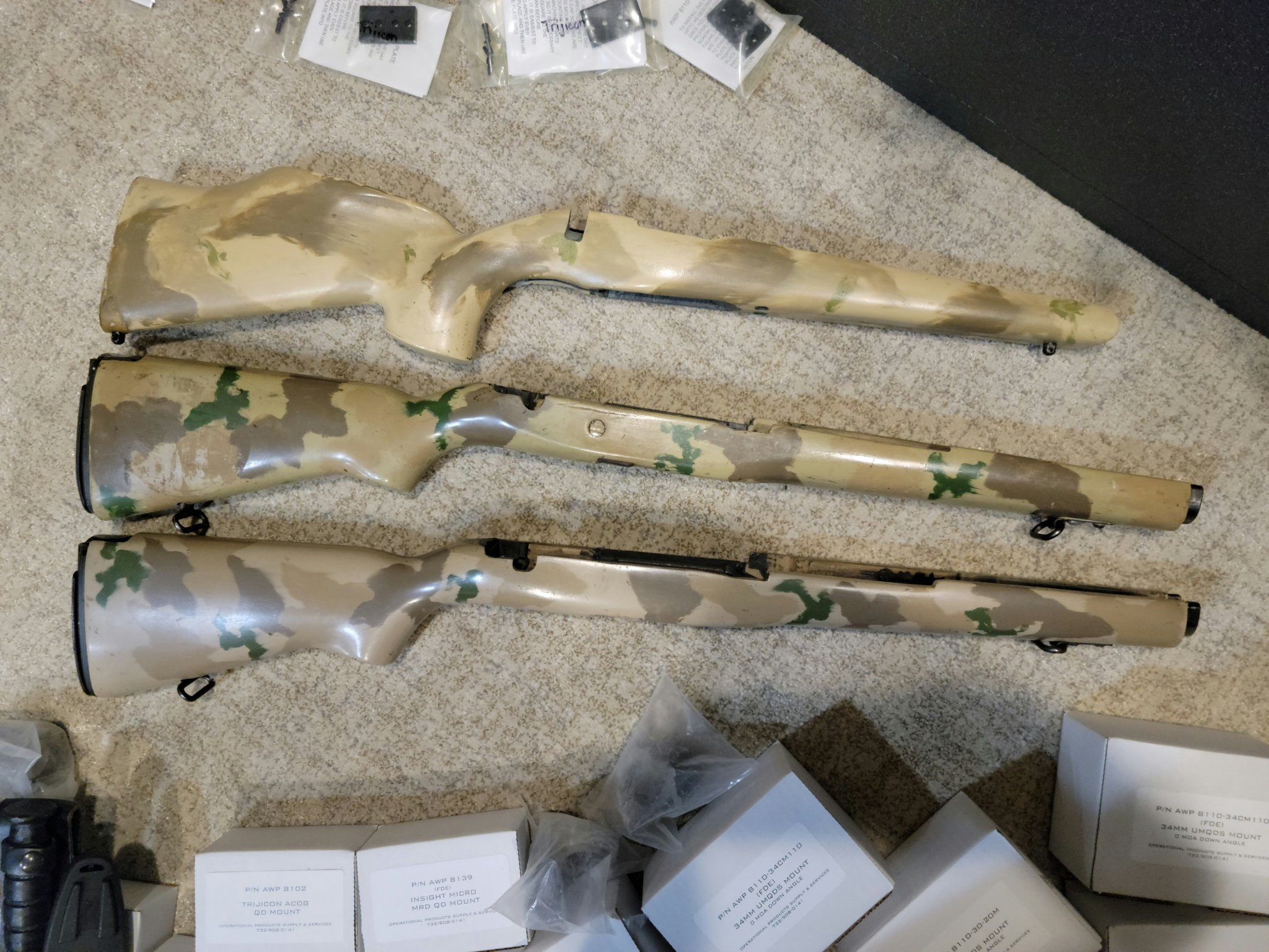

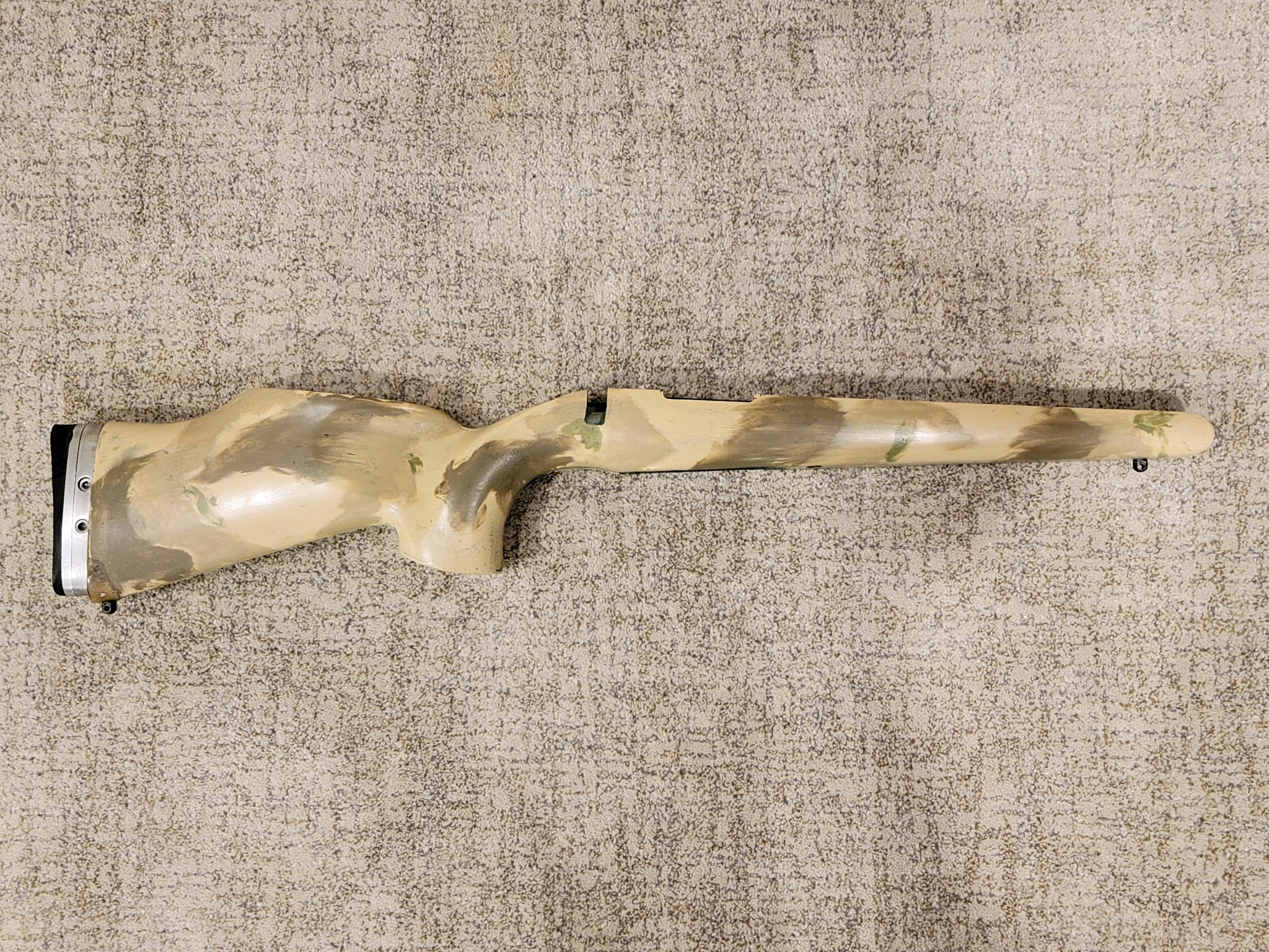

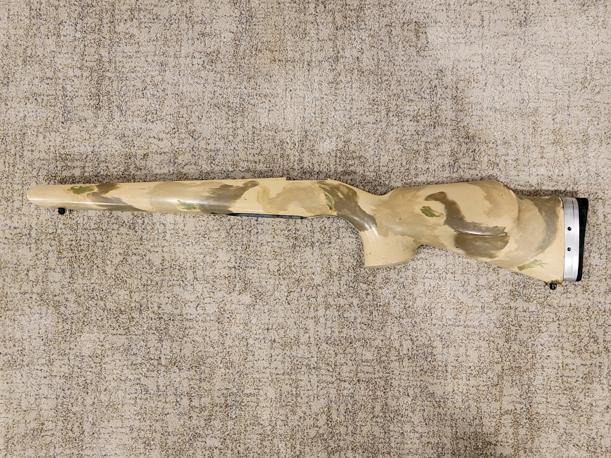

@USMCSGT0331 awesome info as always! @AquaRhombus77 you can get a desert camo molded in Mcmillan HTG stock if you would like to do an M40a1 build. here is a link to an expired guns international listing for something similar to what you discribed. its not a spec build but pretty close.
use the pics as a reference if that is what you truly want. as a substitute for the MST-100 you might use the older Redfield 3-9 that looks like what was used on the ncis episode where Gibbs' rifle was stolen by Ziva's brother. To me the A1 isnt really an A1 without the Unertl or USO MST-100. I think @Jrb572 has one for sale. But the BDC cam will be for 308 win. not 6.5 creedmoor.

Definitely a cool desert tricolor HTG stock in your link, but unfortunately not the desert smear like OP is looking for. But, since it is desert colors and an HTG, it's closer than my suggestion of a desert smear M83! I wonder if the OP could call McMillan and order a desert tricolor HTG right now? I have no idea what that company offers anymore, but definitely can't get a smear. I'd love to see a desert smear HTG, I really hope someone has one and posts some photos if it exists. That would definitely be a really cool stock, but so far the M83 might be the closest for an actual smear and the desert tricolor the closest if he only wants an HTG.

Definitely not a smear pattern, seems to look like later issue woodland camo. but desert. Mcmillan website states molded in, kinda looks like painted IMO. OP stated he is left handed so finding a smear stock alone is a pain but a lefty version, darn near impossible.
So I think OP wanted an M40A1 look-a-like tribute than OP could order Left hand HTG stock with Desert Camo. Witchita stud in front and swivel in rear. cerakote barreled action tan. and that leaves the scope.

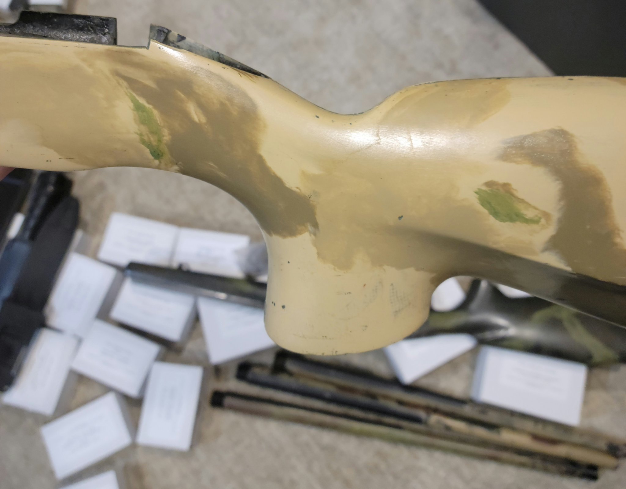

Those woodland and desert smear stocks are gorgeous! Thank you so much for sharing the photos for reference and the information as well. The desert came smear stock would be lovely. Sadly I think my route is going to get a molded desert camo from McMillan. I'm still deciding between the M40A1 or the M40A3. As for the optic I'm planning on getting a Bushnell ET 6-36x56 XRS3 W/ G4P reticle or a SWFA 5-20x50 SS HD 30mm Riflescope I know it's not to spec but I really like both scopes.

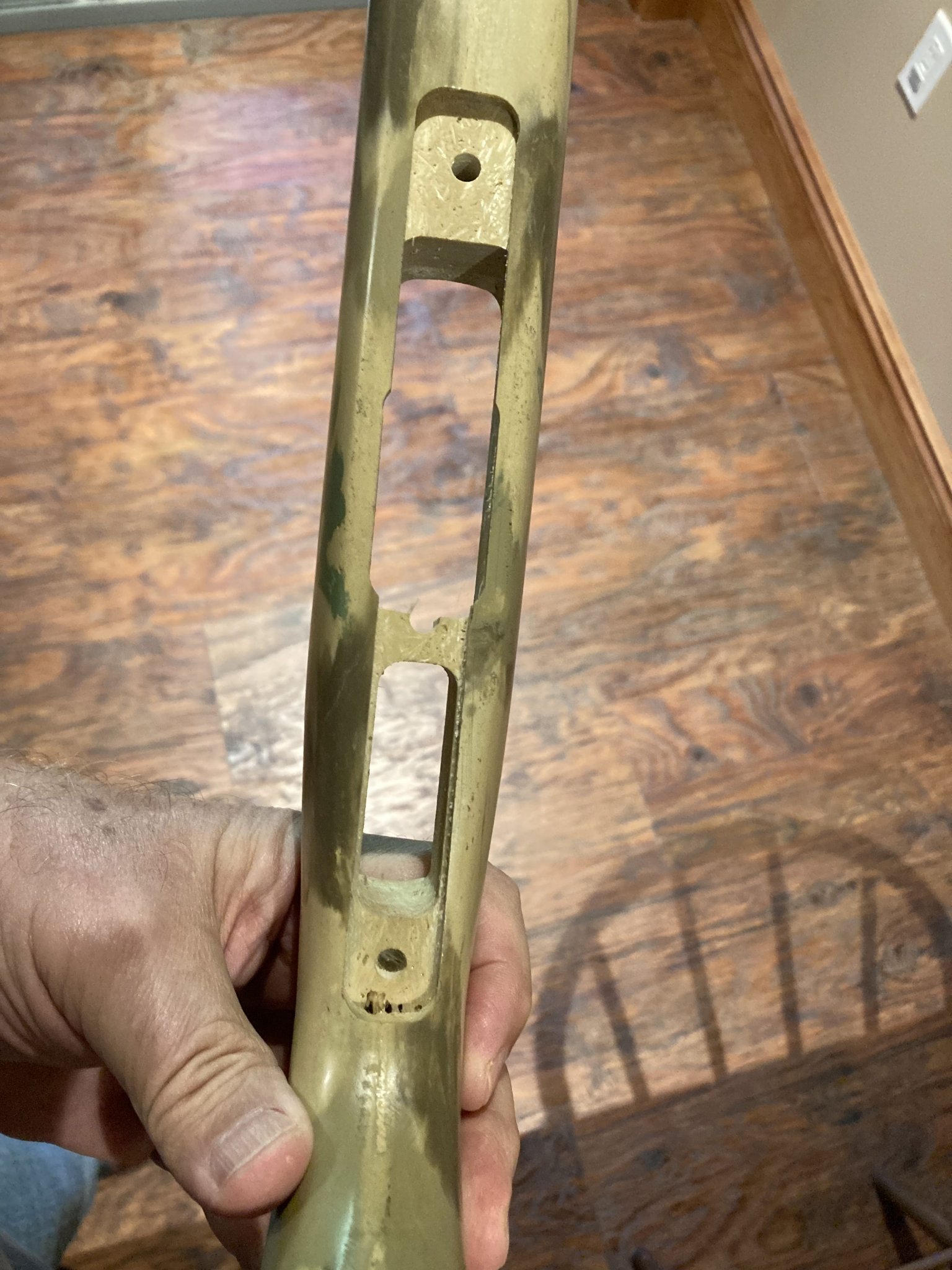

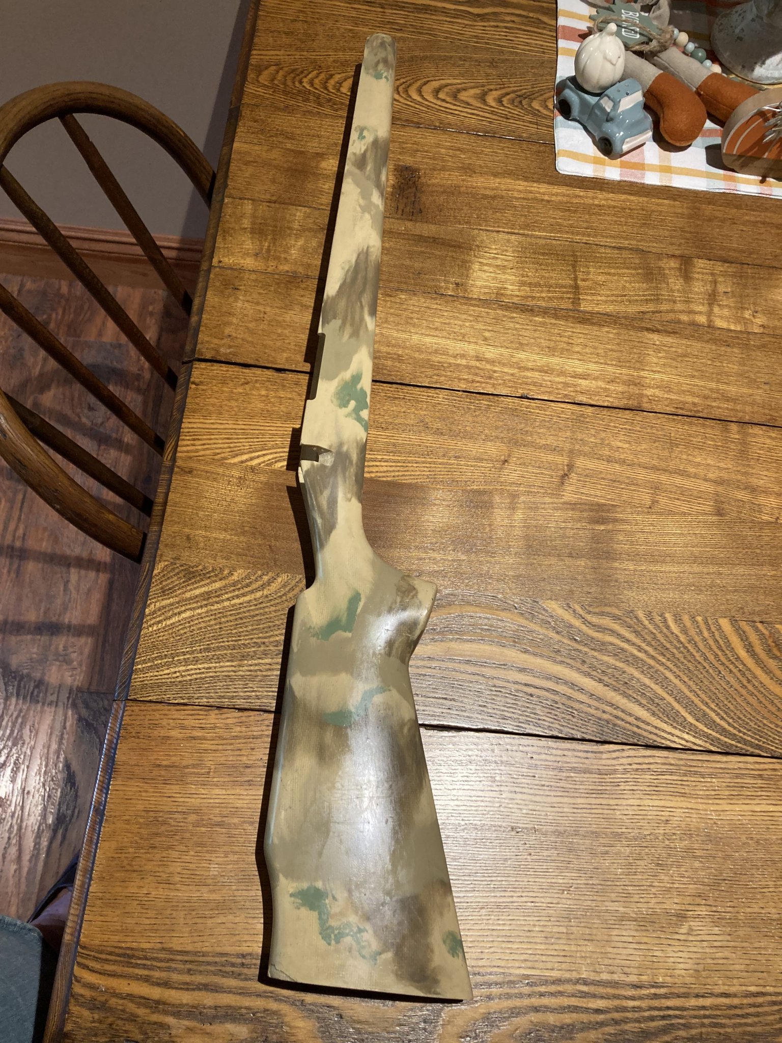

I'm new here, but I found this thread as I was looking for information on a stock that my father recently picked up. Here is a desert smear McMillan HTG. A Remington 700 action drops right into it, but I have no idea what bottom metal it is cut for. If anyone has any ideas on that front I would be grateful for the help. I'd love to build on this stock, but I simply do not know how to deal with the bottom inlet.
Also, I've seen the M83 rifle mentioned several times here, but I can find very little on it. Are there pictures of these rifles out there? What were the detailed specs on these builds? Thanks in Advance.
I have an old CDI bottom metal that is square like that up front, but it is round in the rear. Its not ideal, but you could bed that back without losing any function. Given its location, few would ever know.
Beautiful stock though. Looks cut for a straight handle, so maybe for a 722. Interesting. Good luck with the M83 search...there are a few around but are rarely seen.
I was wondering whether the inlet was for CDI bottom metal, but I couldn't tell from any of the pictures that I saw. Thanks!
