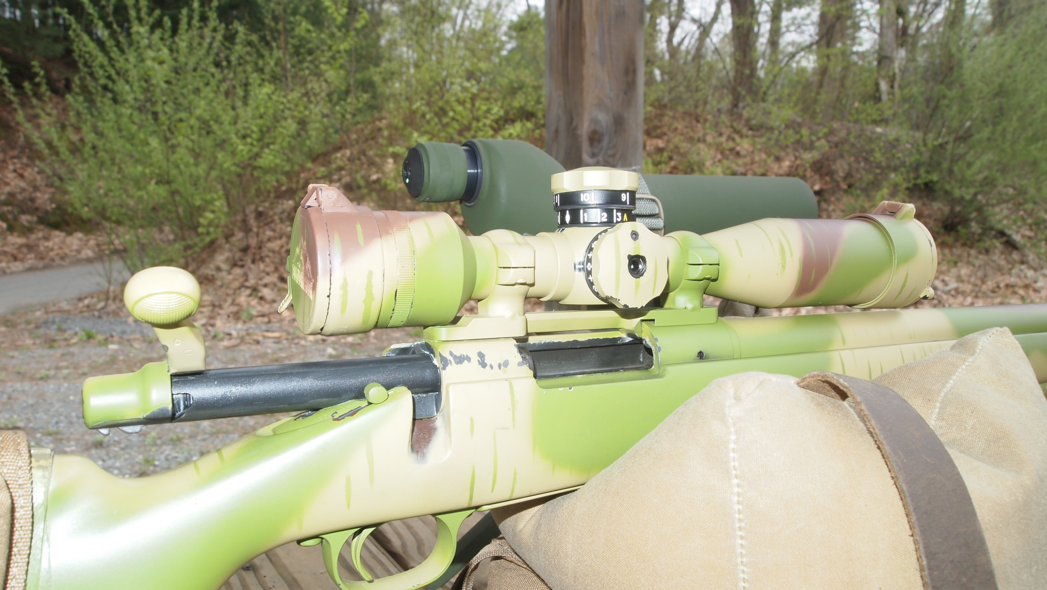

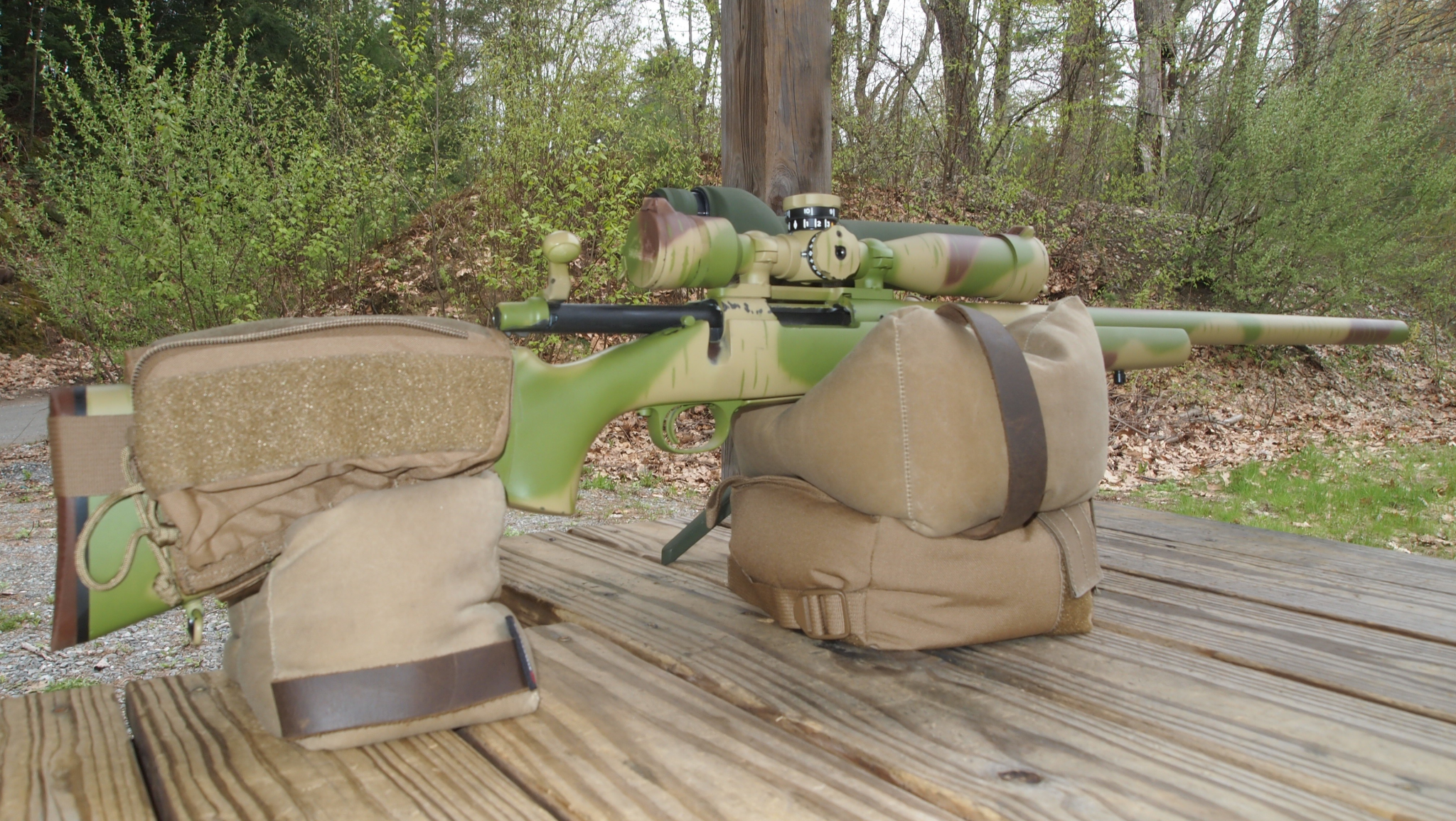

Picture of my scope mounted in a Two Man ring set...
I have the scope pulled back so the front ring is just at the edge of the ocular bell transition, as close as I could go without fear the front of the ring was in the transition while the rear was on the tube.
Im not a big dude and I can get pretty good eye relief in my scope.
I did add a stock pack to my taped up comb. If your having trouble its likely you need more comb.
Intended to shoot on steel this weekend with this but the NE is getting hit by a funky spring snow storm ruining my plans.....
