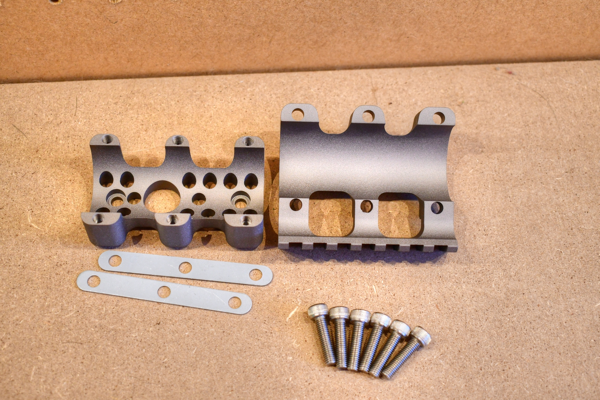

    PGW slightly changed their EFR rails that were used on the USMC M40A3 and A5 rifles. I'm not sure how much they changed on the new rails, but they no longer use the shims between the top and bottom sections.
    If you're planning on doing an A3 or A5 build, shoot PGW a call and see if they have any of the old style EFR rails left. When you call, ask for Roxanne, she knows that we're looking for the old style.
    When I ordered mine they had about 10 left in stock. Hope this helps anyone who needs parts!

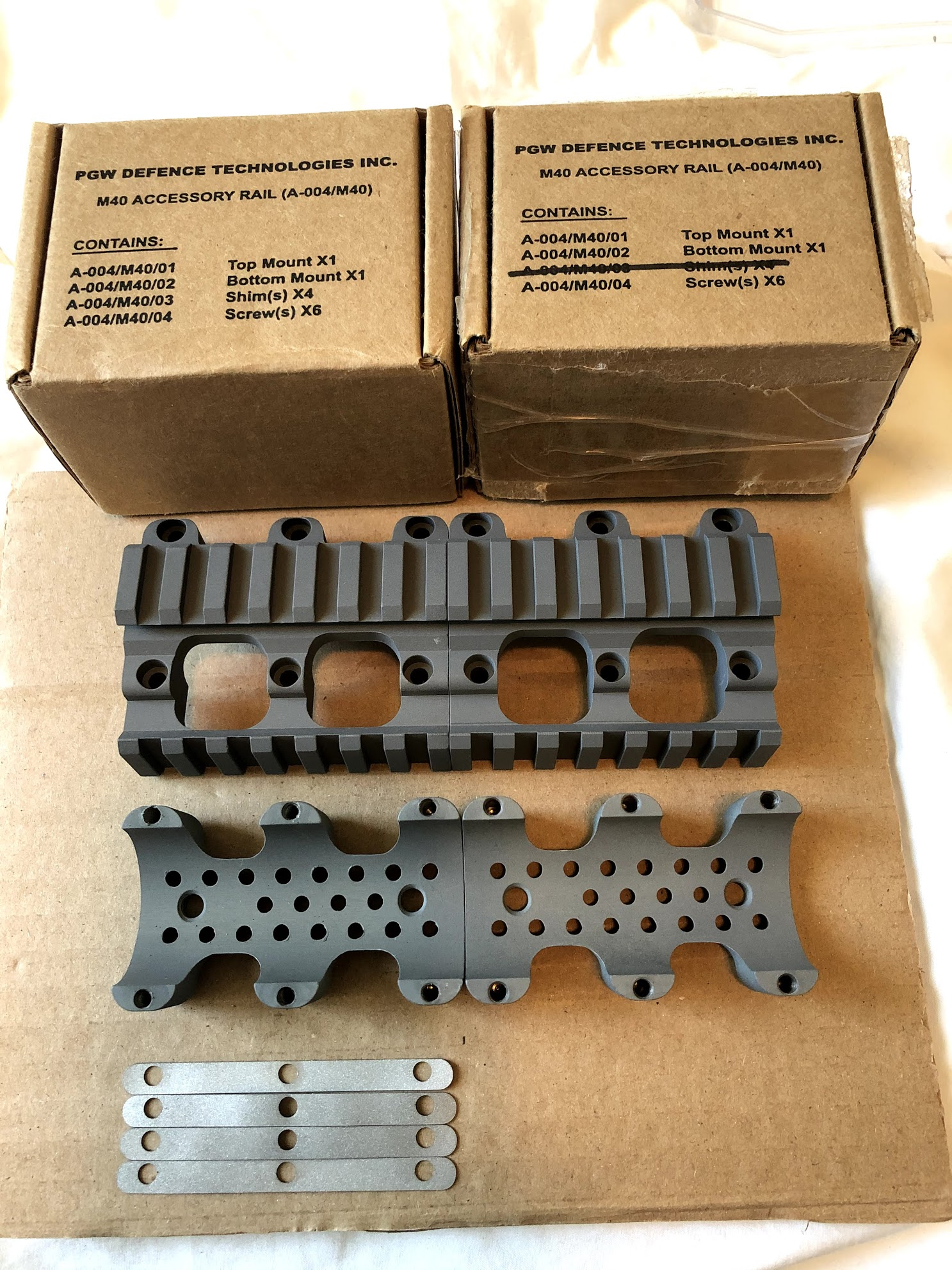

    Interesting...I just got a couple of these in and they both have the line for “shims x4” crossed out on the boxes. Order was placed a few months back in May but got stuck in customs for weeks. No idea about the differences since I have nothing to compare against. Anyone willing to take some detailed pics and/or measurements to see if it’s only the shims that changed?

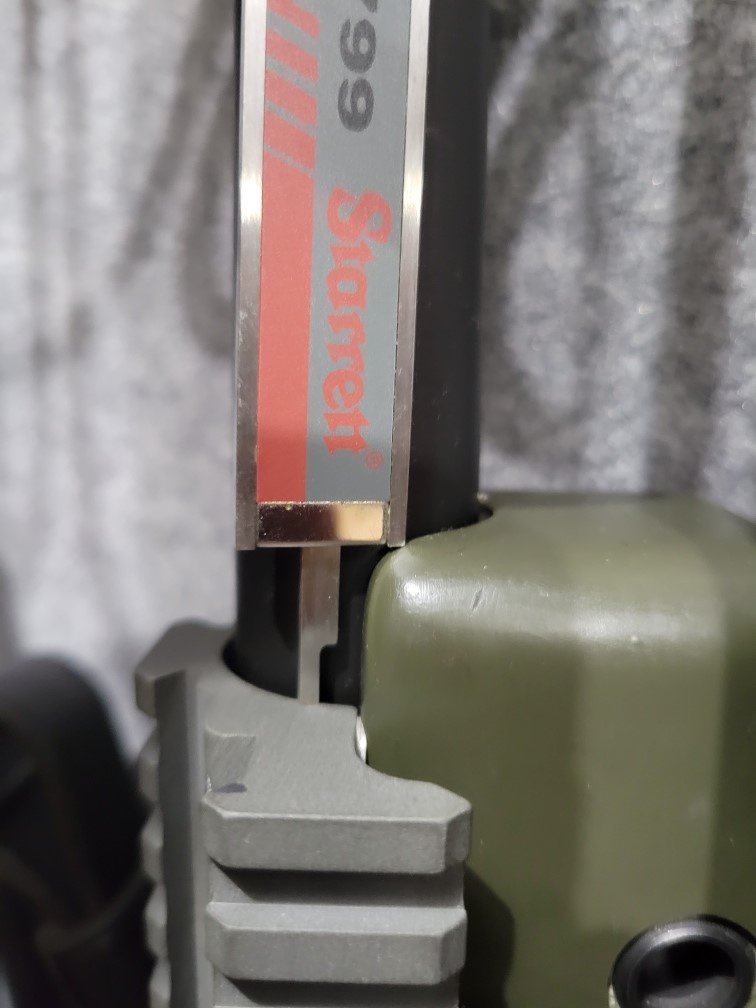

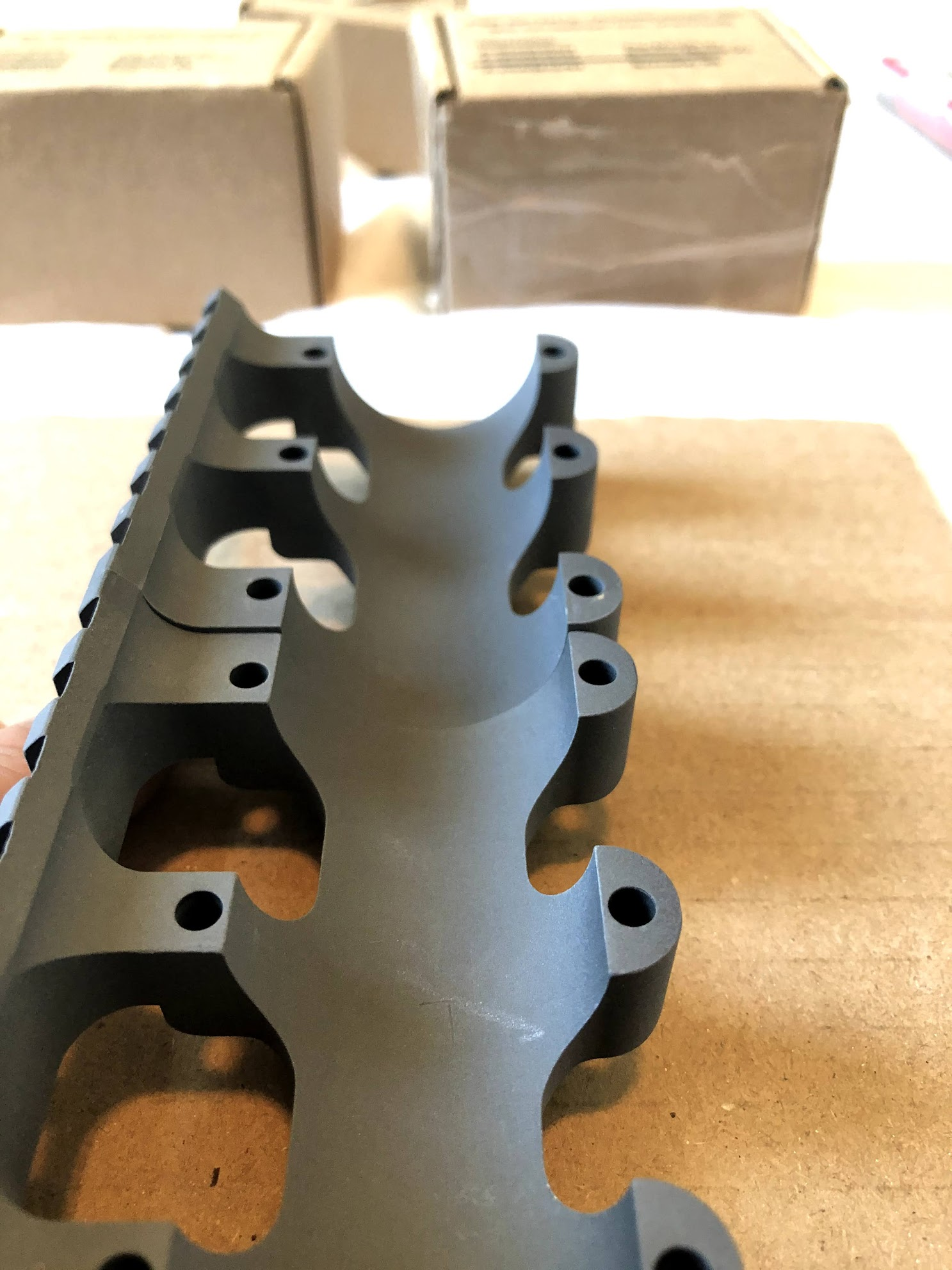

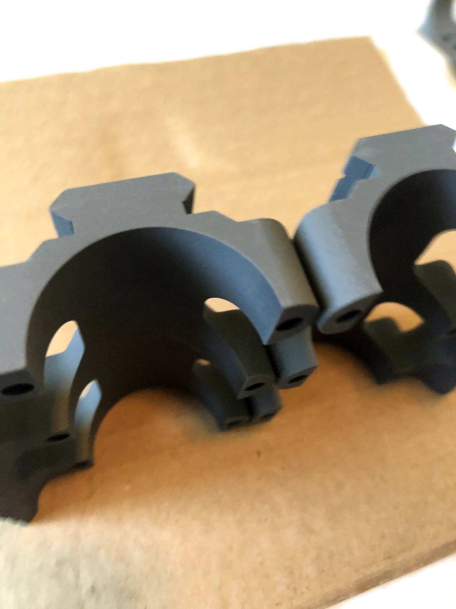

    I was able to pick up the legacy mount with the spacers. Somehow they breezed through customs this go around and I got them in hand in less than a week.
    Basically, they did away with the spacers and added material to the top half of the mount to make up for the thickness of the two metal spacers. From what I can tell the bottom half and bolts are unchanged. The finish looks to be the same as well.
    Here they are side by side. Old on the left, new on the right:
    The difference is ~0.045". This is just a little more than the ~0.043" thickness of two stacked shims. Hope this helps to clear up the differences between the old and the new version of this rail.

    That's great info, thanks for the pics! Minor difference with the spacers, but clone correct has to be clone correct, lol

    Nice to see the differences documented here. Thanks for doing that!
    The minor differences might not seem significant right now, but I'm sure you know how those minor details will make all the difference years down the line when they are no longer available.
    It'll just raise the top half up a little. Doubt it'll have any functional effect on things other than the rail being visually higher off the barrel. I doubt that little bit would even matter for those running clip ons.

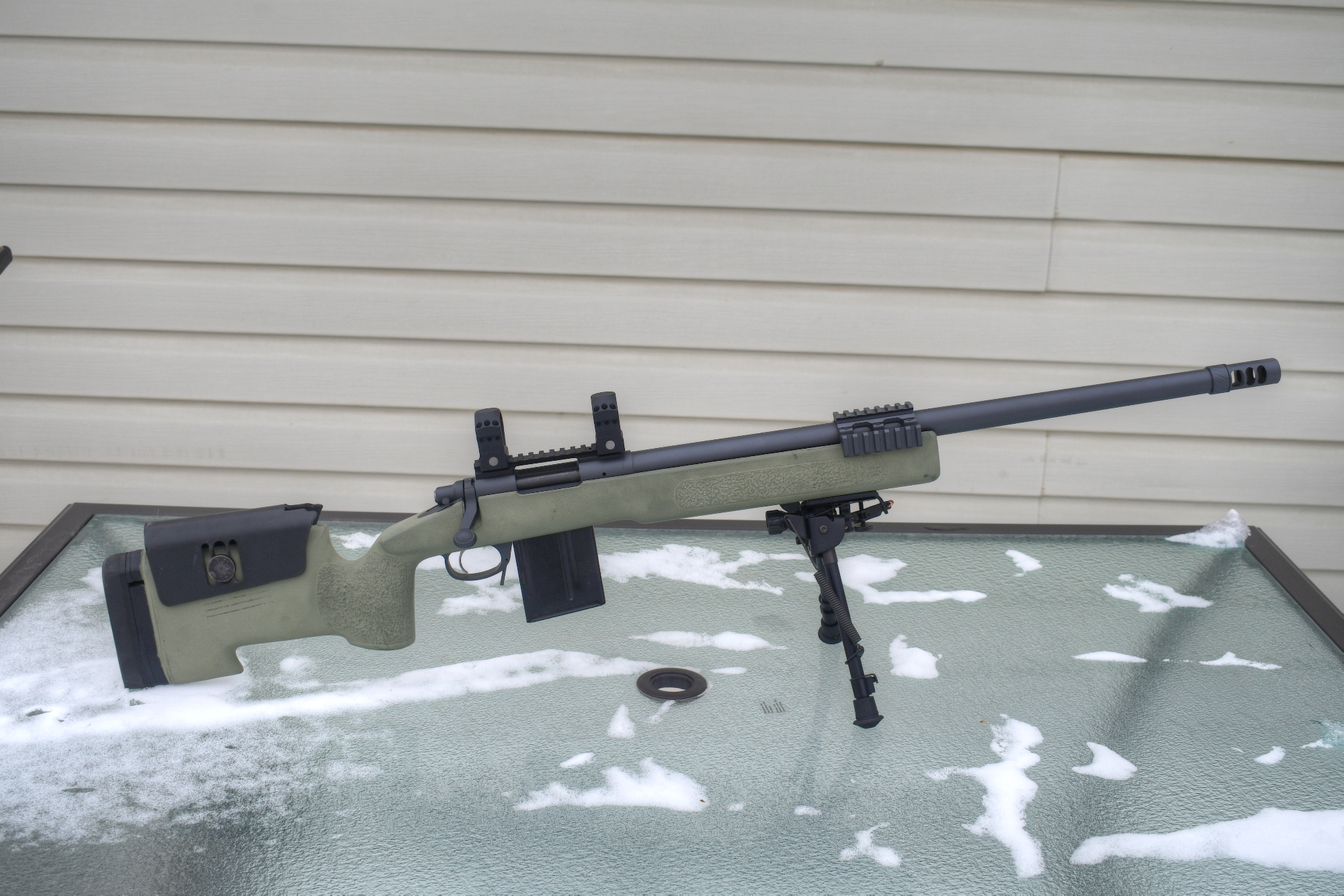

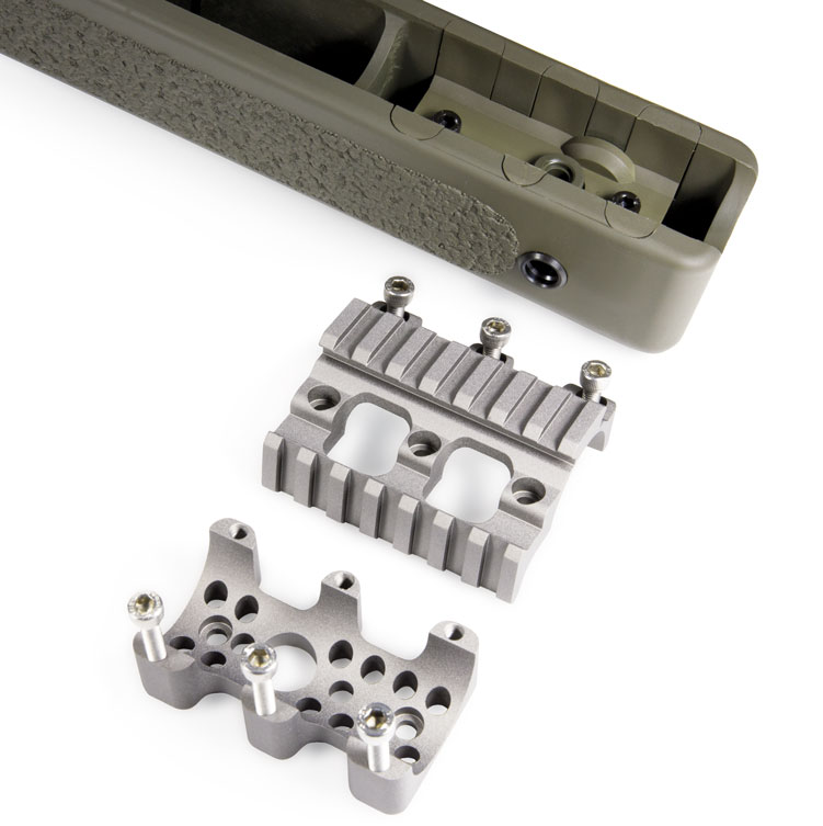

    So after a lot of searching I've decided I'm going to try this. It's CNC aluminum "copy" of the M40 rail made by Action Sports Games (ASG). Although not an exact copy, it does mirror the overall size. Best news it was only $100 USD after the cost of shipping. A lot nicer than the $400 USD for a PGW M40 rail. Yes I'll probably get some hate putting an airsoft piece onto my real rifle (and I'm not happy about it either) but if it works, then I'll have saved some money for something that was just going to be cosmetic on my gun anyways.
    We all try to be as clone correct as possible, but some of these parts are just too damn rare/expensive. If there aren't any more PGW rails available, then the airsoft stuff is the next best thing. Nothing wrong with wanting to build a great rifle and using what's available. Maybe another company will pick up the intellectual property or patents or whatever for the PGW rail and start making them again.
    I'm working on about 30 various AR15 clones right now and some of the parts are extremely difficult to track down. I haven't resorted to the airsoft stuff, but a lot of guys in the M4A1/Mk12/Mk18/SAM-R/etc. threads on ARFCOM will use airsoft parts until they can find the real deal. Hopefully that rail will be a good enough stand-in and you'll keep us updated on your build!

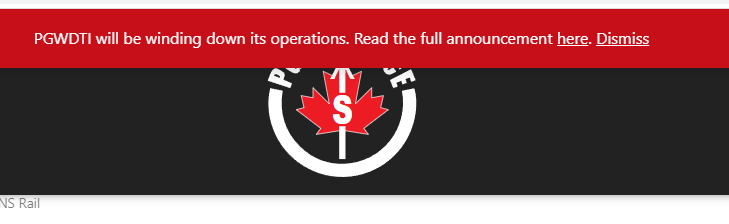

    PGW has has some issues lately, I think they are down sizing because of fiscal issues with their current business model. Building rails outside of .gov contract is probably not their biggest worry right now.
