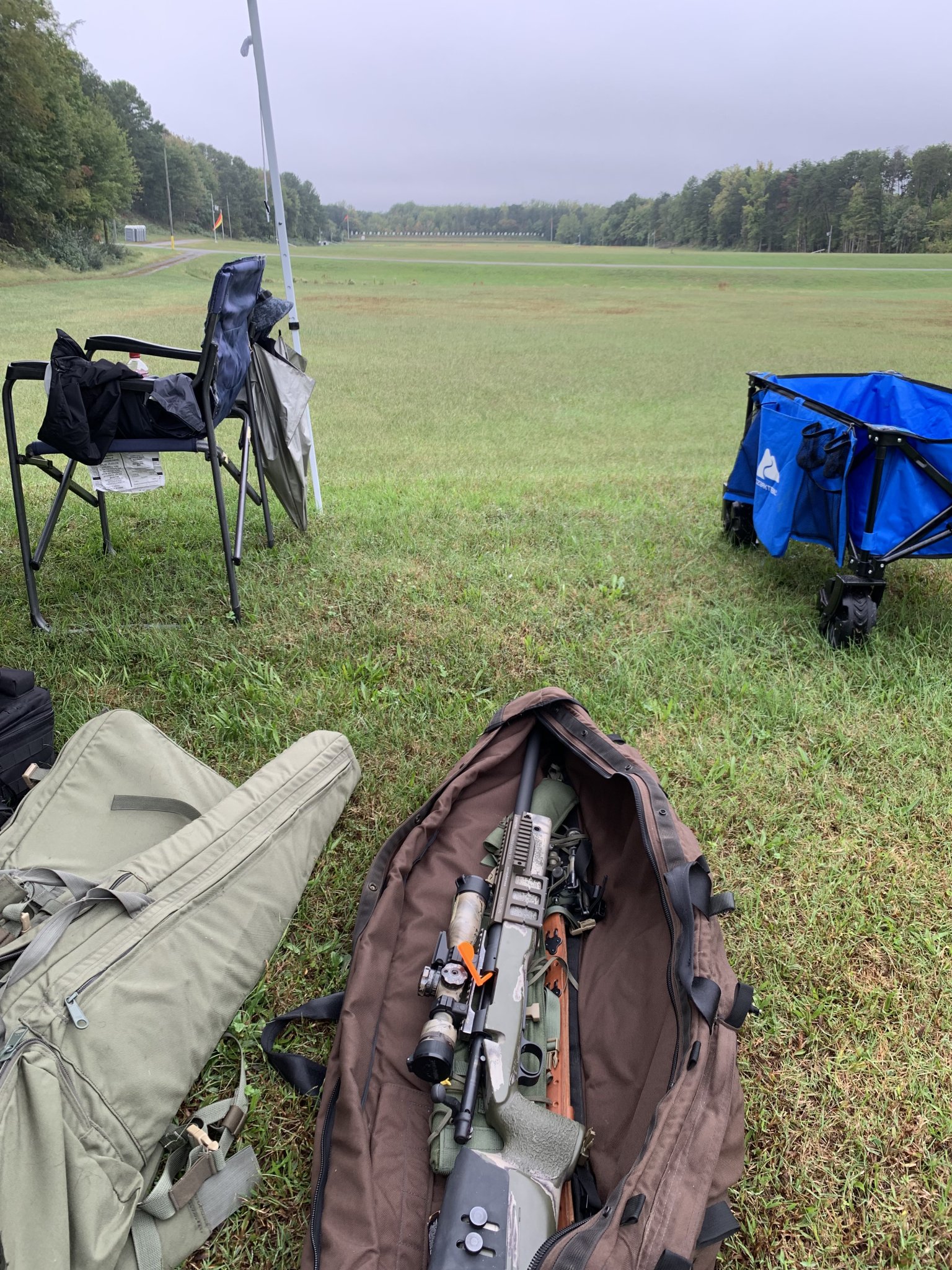

Looking forward to seeing some pictures of the finished product. I was fortunate to shoot my A3 bastard clone last weekend at the Vintage Match at Quantico. 800 yrd line….

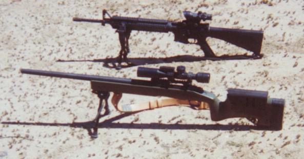

This photo of an early large butthook A3 was probably taken at PWS, there's also a similar photo of an A1 that's taken on the same concrete floor. Apparently that was the last A1 made and this was the first A3 made (at least that's the rumor). If anyone has any information about this rifle, please post it here.

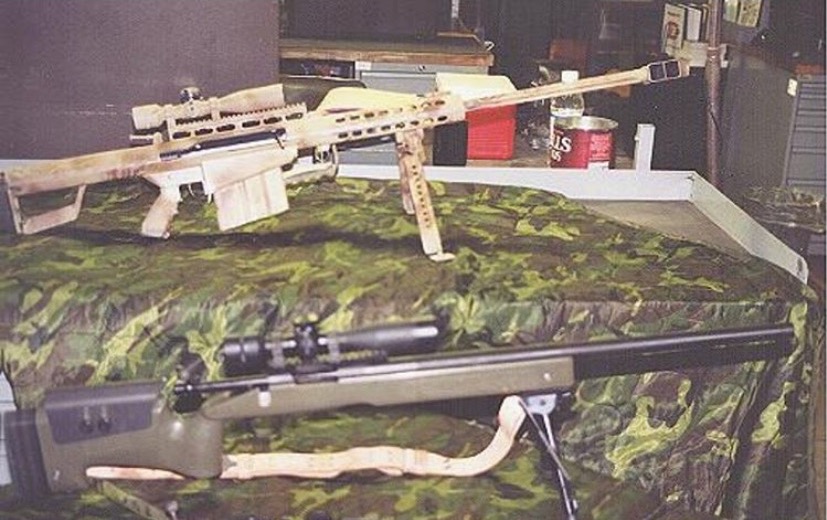

This might also be an early A3 at a USMC static weapons display, but I haven't verified if this is a USMC rifle. If anyone here has any information on it, please let us know.

The very earliest M40A3's were made in December 2001 and supposedly those rifles had GG&G scope rings. The Marines used GG&G scope rings on the A3's for the next month or 2, and then swapped them out for Badger Ordnance scope rings. The Marines hated the GG&G scope rings, apparently they had issues with them breaking and/or coming loose.

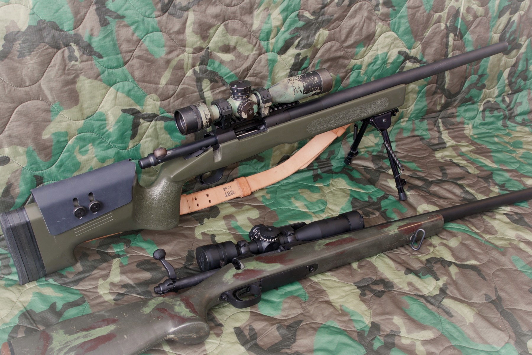

I “cloned” that static display! Lol
If you look closely at the original, there’s what is probably a Vietnam era M40 peeking out at the bottom right corner.
Here’s another photo floating around of that same static display, showing a Barrett M82 placed above the M40A3.
