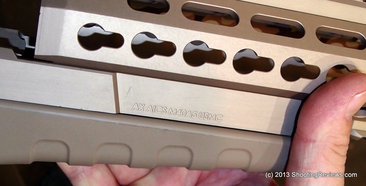

I'm looking for some information about the trial for the M40a6 upgrade. The specific area I'm trying to obtain clarification is the stocks provided by Accuracy International and the configuration of the barreled actions used during testing. It appears that AX AICS stocks were utilized. The prototype stock is engraved "M40a5".
So the question is, did they use M40a5 barreled actions or the new M40a6 configuration to trial the Accuracy International chassis?

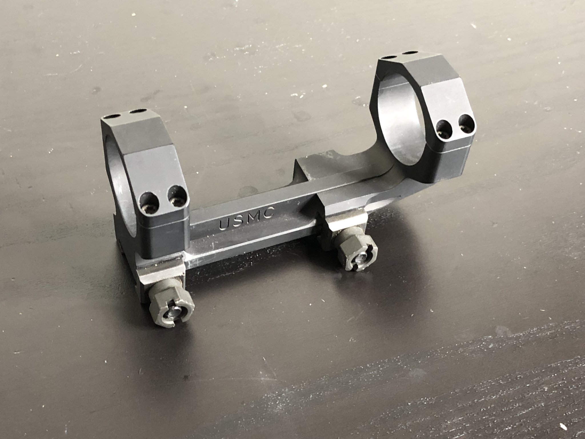

One of your best options would be to contact badgerord in the below thread. They submitted a prototype mount (Badger Unimount with USMC engraved on one side and PN 306-64M on the other) for the M40A6 contract and had been involved with other contracts previously.
This thread was from the early A6 days.

My thoughts? I suspect that prototype AICS chassis is designed for the old M40A5 lug per Marty's posts, but that's just a guess. As to why the AIC chassis was not selected? Probably have to find and contact the AICS federal sales Director for that particular answer. Typically the vendors can (and do) request a de-brief on why their product was not selected, and usually the USMC will not publicize the internal selection process. (Factors include cost/value, technical performance/technical approach, key personnel, or past performance/core capabilities of the vendor, etc.).

I did an interview with Scott at Accuracy International some years ago and we talked a little bit about the USMC chassis solicitation. The AX AICS mitigated this issue by using action screw holes that were slightly oval shaped. This and other design elements were carried through to the post-2014 AX AICS, including fitting a M40A5 recoil lug.

My intention is to build a barreled action for the AX AICS trial chassis to accurately represent the set-up as tested. From the information gathered thus far, it is pointing to an M40a5. One piece to the puzzle that is eluding me is the barrel length. Meaning, should I build it using an M40a5 barrel at a5 length or cut down to 20" oal per a6 specs? At what point in the process did they decide to go with the 20" barrel? From the very beginning of the solicitation or after the trials were completed?
