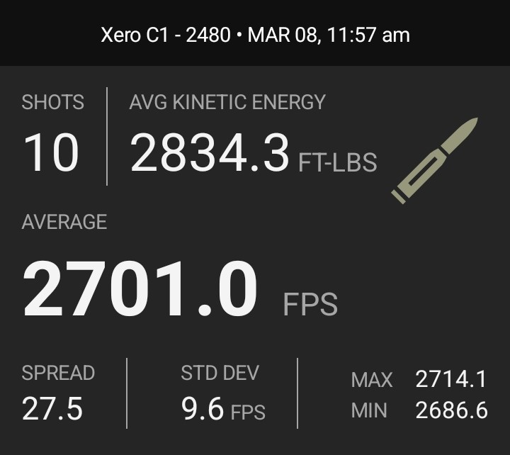

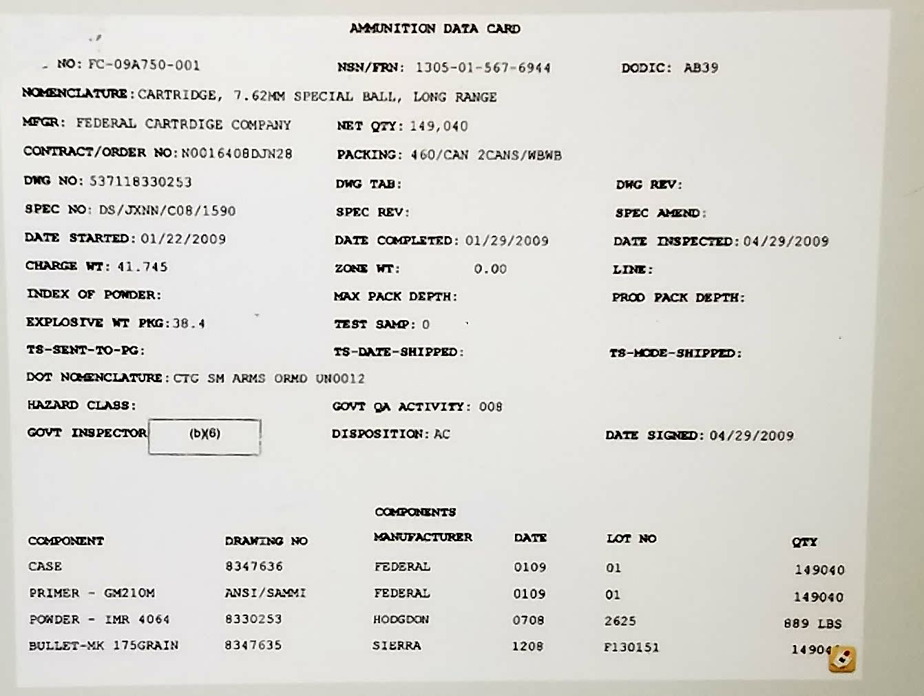

I got the spec sheet that states 41.745gr of 4064. We can't get that in my country so I used the closest proxy which is Varget. Dropped 41.8gr of that in a FC 308 case with a 210m Match Primer behind the 175smk and got the below on the Garmin.

That's good info, thanks mate.
I cloned M118LR out of my M40A5 and my results are almost identical to yours so that makes me happy.

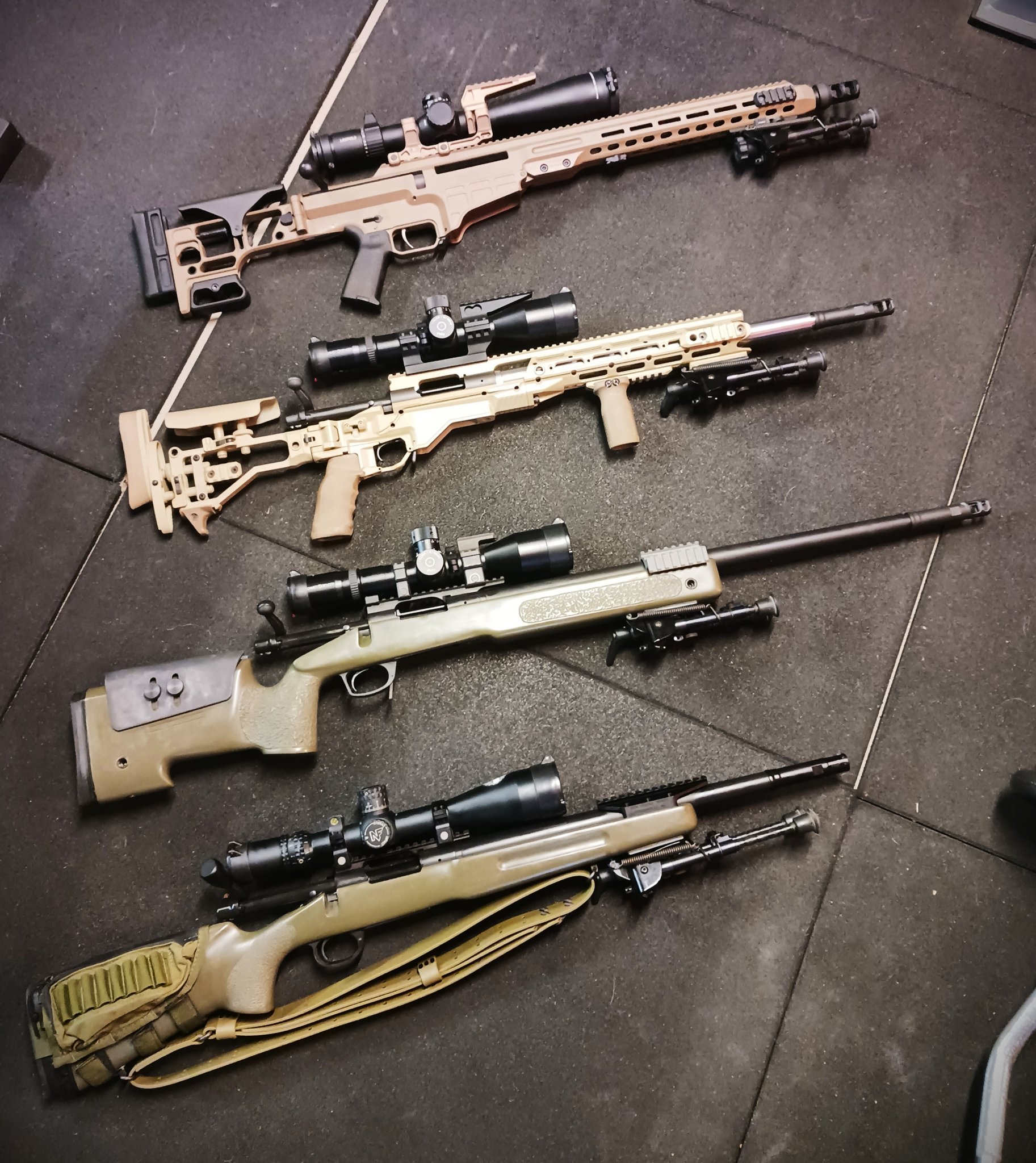

Do you have any other pics of your A6? That's the real reason I clicked on this thread! Post up some more pics of your rifle! And, what's up with the vertical foregrip? Are you taking a lot of standing shots or something? Does it actually help on a bolt action sniper rifle? Definitely haven't seen that before, and I'm interested to know why you're using it on the A6.

The fore-grip is for Precision Service Rifle Series. We shoot hawkins and it's a very dated firing position that favours older stock designs. The fore-grip closes the gap for me between the bottom of the fore-end and the ground. Not sexy but it's totally necessary.
This is the only other pic i got sorry mate

I've been loading m118lr to this. If I'm correct this is the most recent recipe for it. I use different primers and load to I think 2.820 coal.
Yeah mate, we've been referencing that document. We can't get IMR4064 here unfortunately so we are stuck with Varget but it's certainly pretty close if results are to be believed
