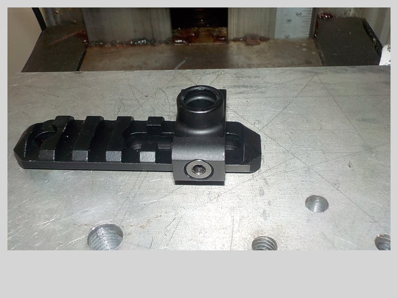

    I'm trying to figure out how one would best machine an anti-rotational flush cup.
    Does anyone have the specs (if there is a standard) for the inner diameter of a flush cup, and the diameter/size of the inner non-rotating feature?
    I'm thinking of something like the Magpul bolt-on flush cup, if that helps visualize what I'm going for.
    Thanks!

    Seriously consider machining the main part you are trying to produce but with a threaded pocket to accept a limited rotation cup.
    The cups from GrovTec are stainless with black oxide finish. Very high quality part and are inexpensive enough that it may be worth your while to purchase that part already made then loctite in place with rotation clocked to position you desire. The thread is a standard, easy to machine thread and the cups have a 1/4" hex drive in the bottom. . . .
    Terry,
    Thank you very much for the insight and the information.
    Do you think there is a downside to using 6061 or even 7075 Aluminum for the actual QD pocket? Will it wear or potentially fail? (I know there only a small rim of material providing the support for the sling to not pull out)

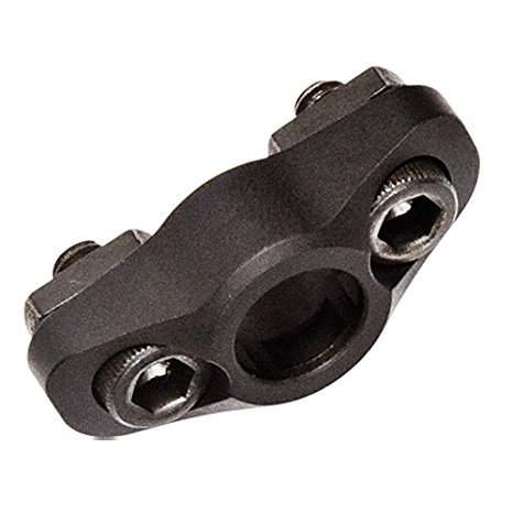

    The design I'm working on is similar to the Magpul 1-piece shown in my original post, but thinner, so I'm not sure the threaded pocket will work as I'm looking at it right now. I'm wondering if making the entire piece out of Stainless would be a better choice if I can't get a threaded pocket to work?
    Thanks again!

    I even found this on 2 different lengths of fore end pic rails for my Atlas with QD mount, both rails from B&T…..
    Built solely to clamp bipods to. 🤷🏿
