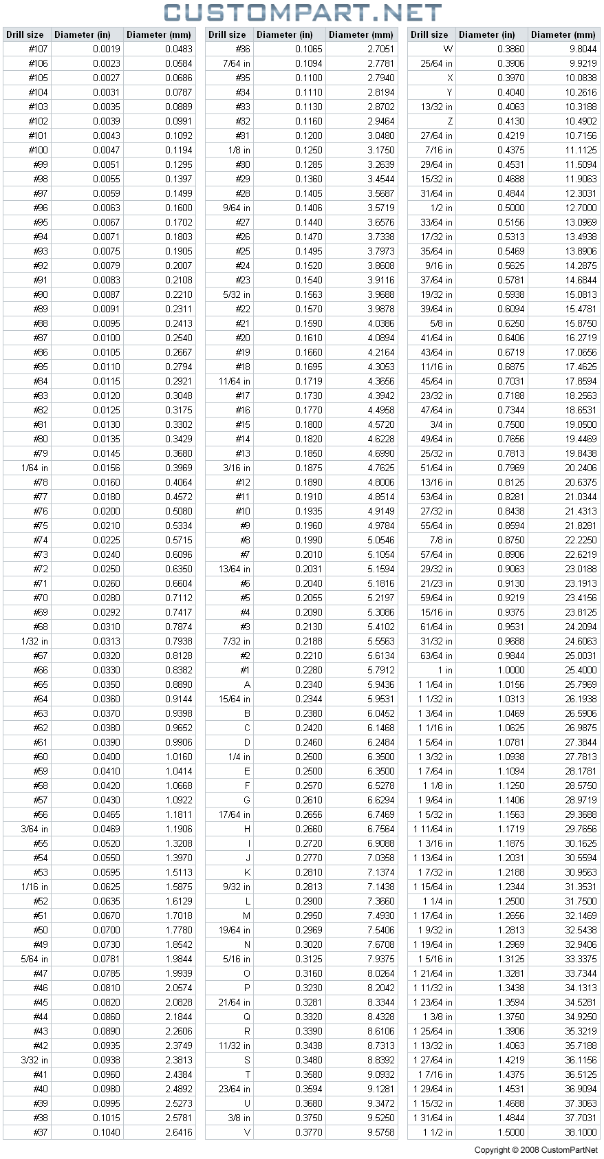

I recently acquired Glen Zediker's book "THe Competitive AR15 Builder's Guide" and have chosen to use this as my resource for my first build. I have all the parts and tools and am getting ready to start the lower. QUick question though. PRior to starting the build be states that I should ream out the holes with machinsts drill bits. I will be using Cobalt bits, but it's the sizing that's confusing me. How does a #22, 23, and 40 correlate into inches? Are the drill bits labeled as such at the store?
Here you go. Yes, they are labeled at the store, however you may to find a machine supply shop to find lettered and numbered drill bits.
McMaster-Carr is going to have everything you need. They have a website and their shipping is quick.
Because you're just clearing paint or Cerakote from the holes, high speed stella will work just as well as cobalt, and will save you some coin.

Yes, you can get numbered drill bits from a real tool store, but you won't be finding them at home depot or the such.
if you need to start reaming out holes on a an ar receiver, you are buying parts with really poor qc. I've assembled more than I can count, and can only think of one I ran a bit through a single hole. If its out of spec, send it back.
If you need to ream out holes, you should not do it with drill bits.
You should do it with hand reamers (or chucking reamers) if using a power tool.
Drills are for making holes. Reamers are for precisely truing holes. They are two totally different animals and not interchangeable.
And I can start on Pin hones if you want to talk about aligning holes and truing them to tenths.
