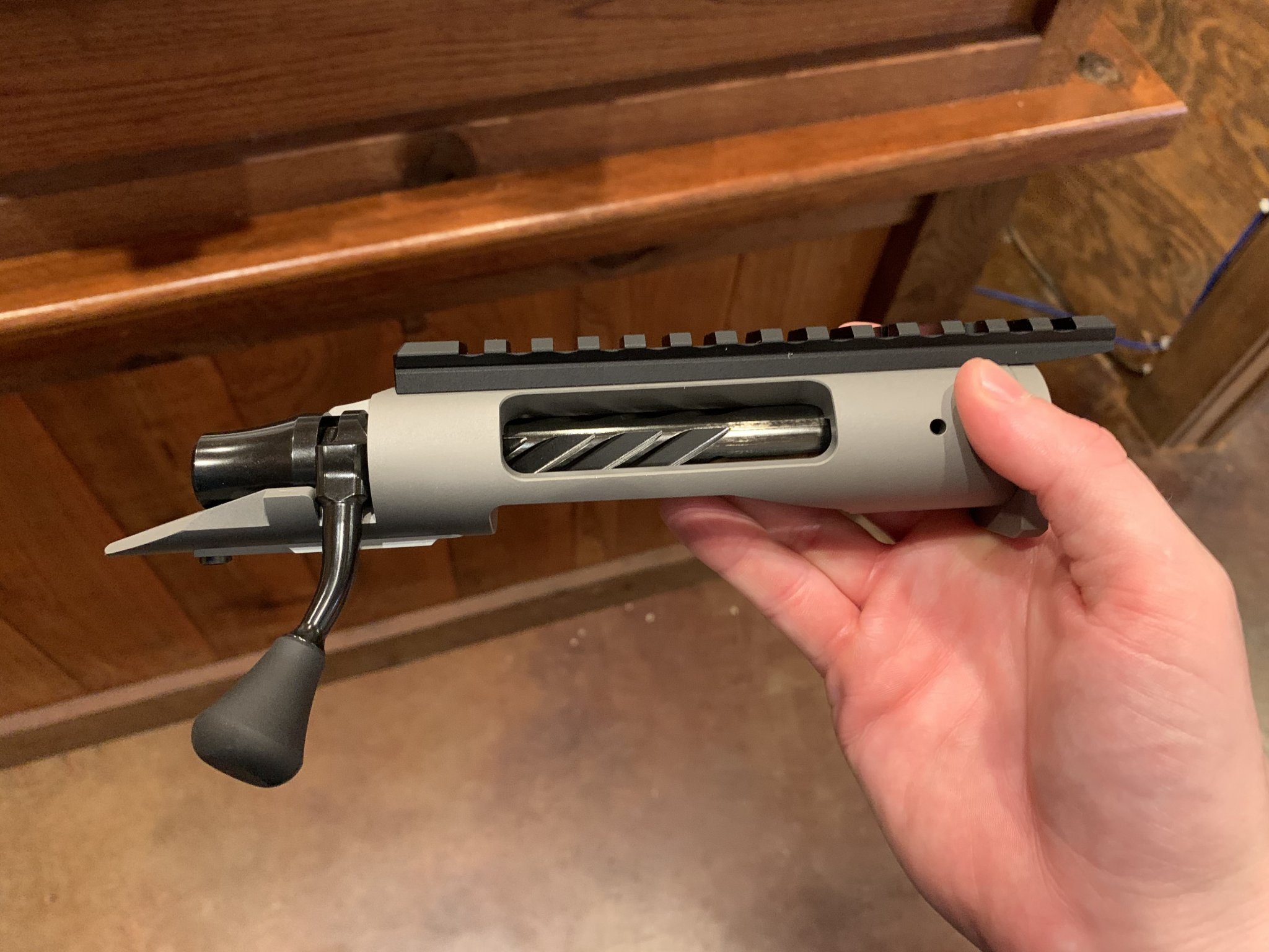

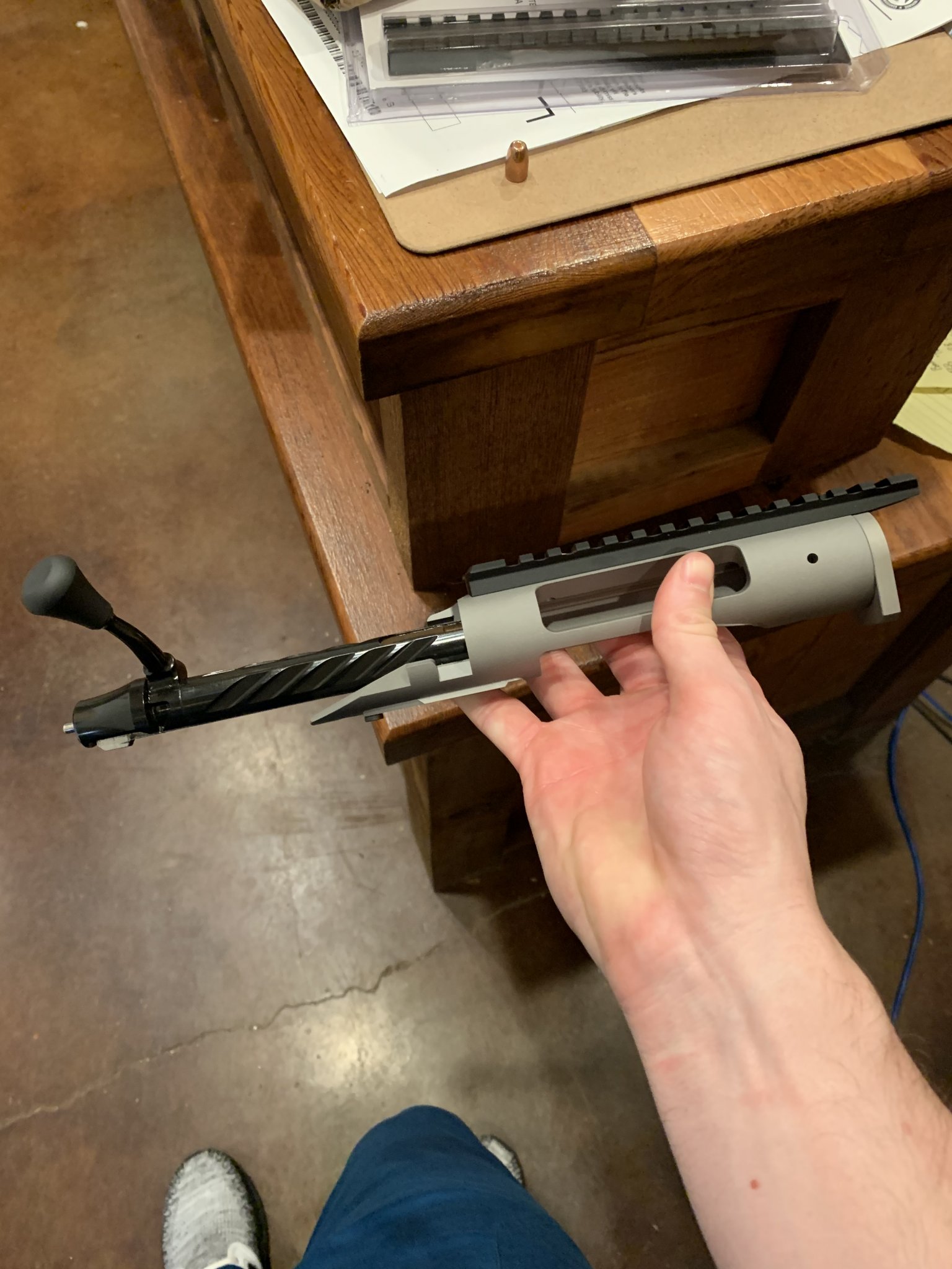

Don't be tempted to think this action is sub-par compared to others due to the low price point.
I think it is the most under-rated action in our market space.
I have about 10 in customer circulation with at least 7 of those being shot quite a bit.
They have been impressive and are showing no signs of trouble from any of the components.
It is honestly equaling or outperforming more popular and well known actions of a few fronts.
They run very smooth. MacBros has a good ration of bolt/receiver clearance dialed in.
Tool-less take down of the firing pin assembly with a bayonet style shroud release.
Very cool and novel design on locking the recoil lug rotation without pins.
True R700 footprint.
Utilizes a trigger hangar with good design.
AW cut in bottom of receiver.
Even though the receiver does not have an integrated recoil lug, the amount of tenon thread is on par with Surgeon/Defiance due to the design.
The absolute best extractor design in the market.
They are keeping headspace consistent enough to accommodate Pre-Fit support.

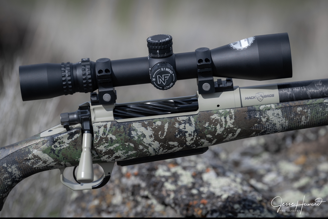

Some arent aware that they sell a range of hangars to tune the trigger to the action. Not as cool as the CDG, but cooler than no adjustment at all.
They also just released the Element, which sets the benchmark for economically priced ultra-light steel actions. I just got one in and its bitchin!
They seem to be doing a better job with production as well, ive been snagging them with ease.
Lastly, they’ll build complete rifles or barreled actions in house using in stock carbon or steel barrels or a barrel you send them.

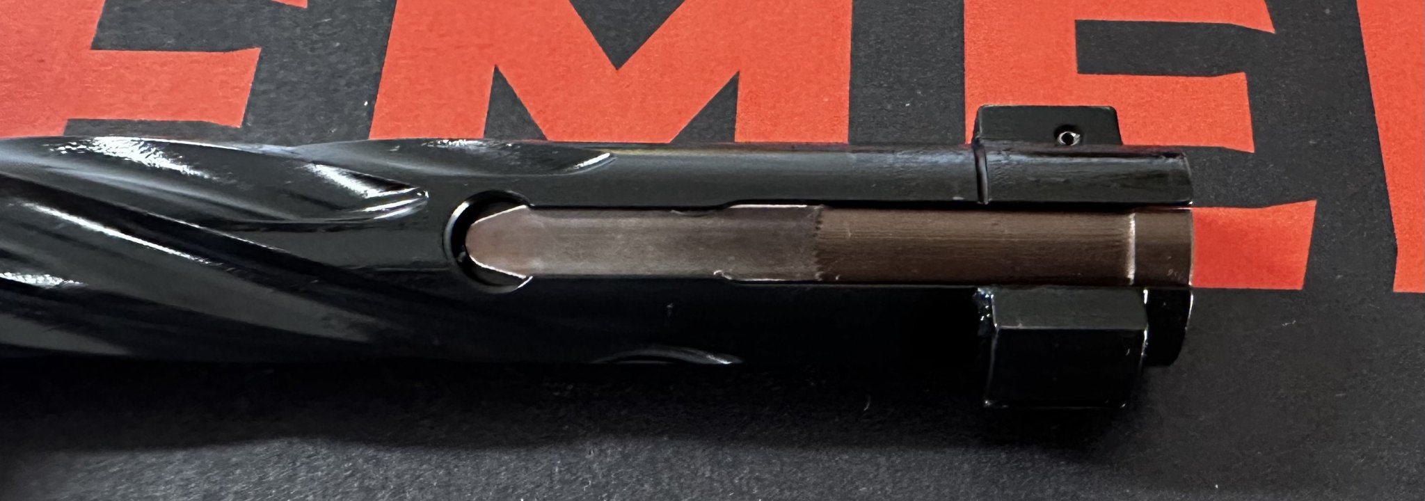

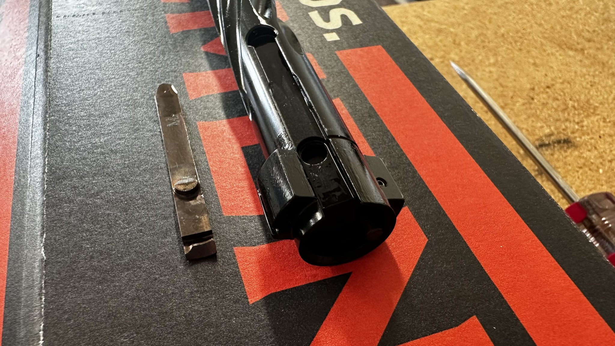

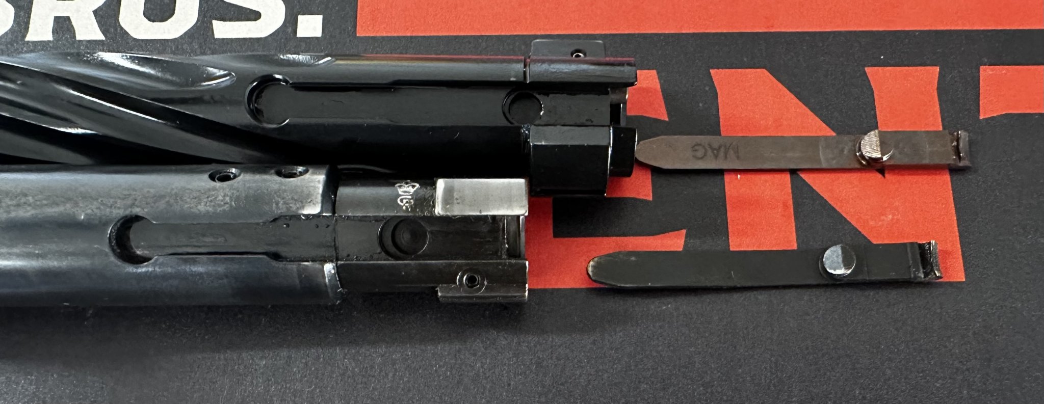

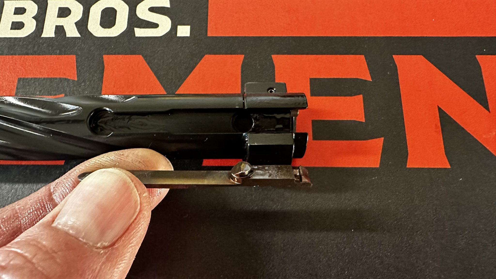

@Terry Cross and @Supersubes , for those of us who haven’t used or had a Mack Bros in hand, what sets their M16-style apart from other M16-style ones in the market? I‘m thinking specifically Bat’s as I have a couple. Thanks
Its really not an M16 style as most people know them. Straight up Accuracy international design. No pins, no springs, burly as shit, works flawlessly. Disassembles with a medium flat blade screwdriver. Im sure its happened, but ive never seen one fail. Perhaps Terry has.
AI bolt and extractor on the bottom, Mack Element on top
