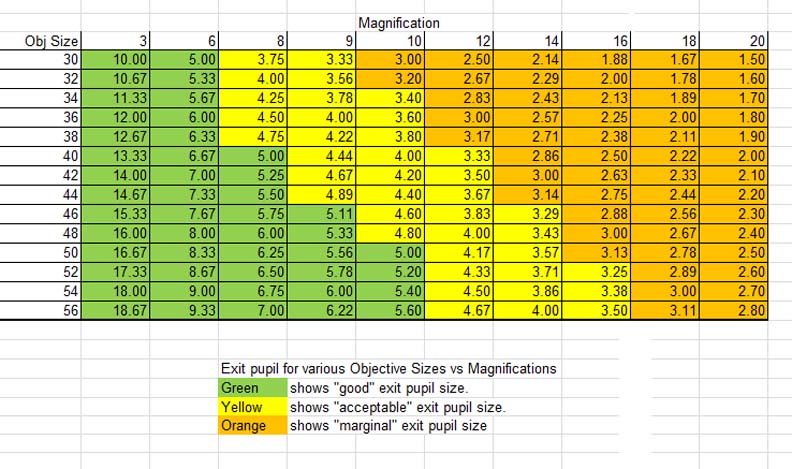

From your post, I got curious about what my "junk scopes" have for exit pupil, then also got curious if I could make a chart for other objective/magnification combos, so that I could see at a glance what might/might not work. Others might also find it useful, so here is that chart:
The colors/ratings are based on my own experience with the acceptability of my "junk" scopes, anyone else's experience may vary...
You are very welcome. My comments should be taken as anecdotal evidence and not as clinical findings. I believe that an undersized exit pupil adds the complication of edge shadowing to the image, and that this can bring unacceptable issues to the already difficult task of sight picture resolution by causing cheekweld to become overly critical. I think your chart brings needed clarification to a significant issue.
Greg
