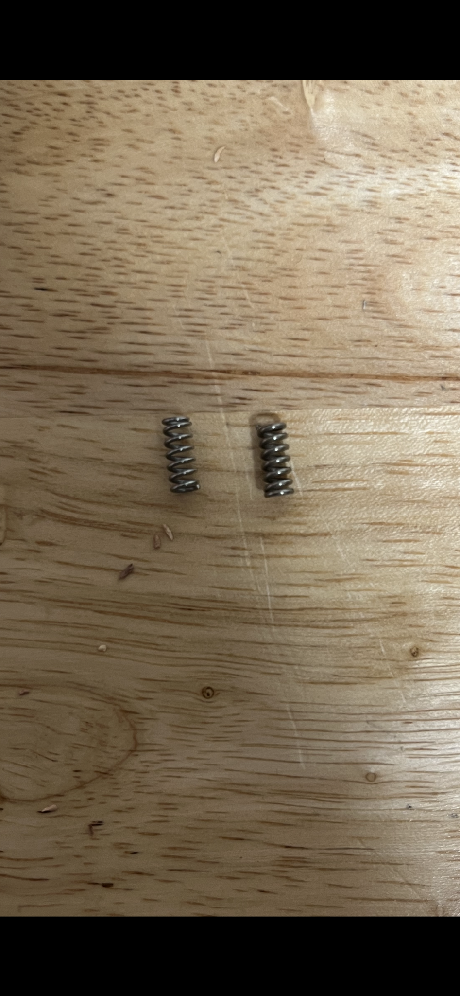

Hang tight but I might have found a solution for some, including myself, that are having issues with the magazine coming unlatched or popping loose under recoil.
I pulled the spring from the magazine release catch. It is pictured on the left. It is the same size and length as the the beefier Tikka factory trigger spring on the right. I have a bunch of these Tikka factory trigger springs laying around after swapping them out with Mountain Tactical springs.
I installed the factory Tikka trigger spring and it fits. Now my magazine seats with a nice “pop” and that sucker is locked in there. When I depress the mag release, the magazine will not fall out of the mag well. I have to use the other hand to pull the magazine out.
I did have to make small adjustments to the trigger guard. If it was all the way forward, it was too tight of a fit for the mag release lever to release the magazine. In the middle position, the magazine is snug with virtually no play but I am able to remove the magazine. With the trigger guard all the way back, it’s got too much play.
I will report back after a visit to the range tomorrow if installing the Tikka factory trigger spring works. For now it seems to do the trick.
