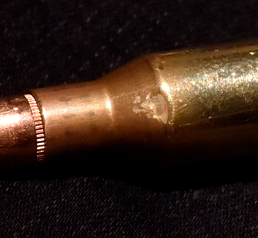

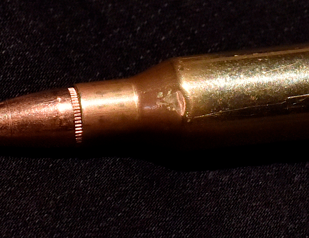

I recently got a Savage 110 precision in 338 Lapua. I took it to the range last weekend to test fire it and noticed that the cases in the magazine are all being dented under recoil. The rounds were pristine while I was loading the magazine, so I know that they weren’t already dented. When a round is fired, the rounds that are still in the magazine are being dented on either side of the shoulder by the ribs that run down each side of the magazine. Is this normal with AICS style magazines, or is this a defect in the magazine?
This is the factory Savage/MDT magazine that came with the gun and is not aftermarket. This is my first real venture into long range, but I would think this would have a bad effect on both brass life and accuracy.
There is an identical dent on the opposite side. These dents correspond exactly with where the shoulder contacts the ribs in the magazine and are repeated across multiple rounds.

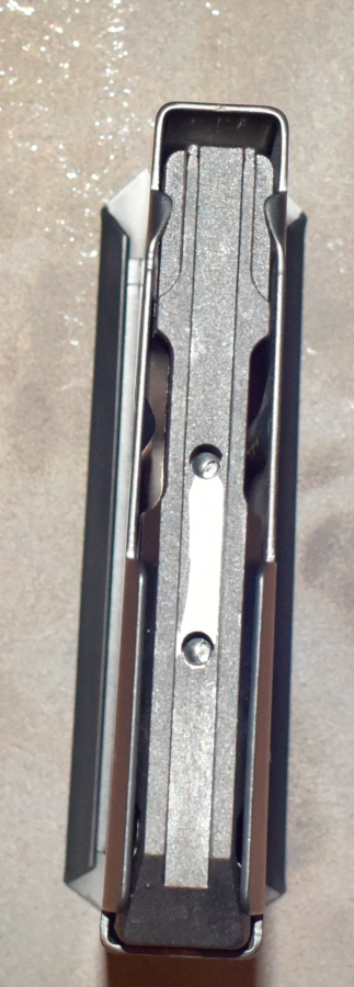

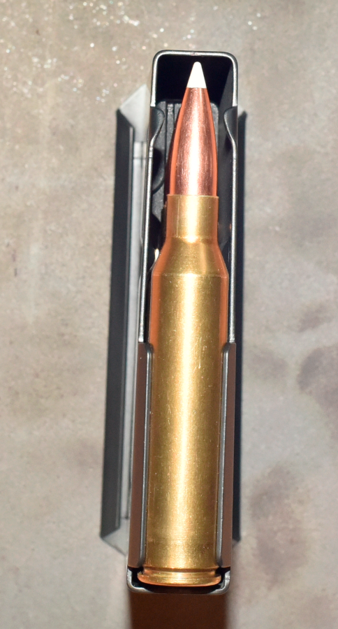

Here are the requested pics.

Is the magazine semi crushed, so the side ribs are hitting the area of the brass that's being dented when the rounds are inserted into it ?
Is it hard to insert more than two rounds into the magazine ?
I would send the pics to savage CS and see what they say and/or buy another 338 magazine to compare it to.
SJC
SJC
There is no apparent damage whatsoever, the magazine loads and unloads perfectly. The picture above is with it fully loaded with 5 rounds. The only way you know something is wrong is by firing a round and then looking at the remaining rounds in the mag. The rounds also do not show any damage from just being loaded and cycled through the gun without firing, so they’re not being dented during the feeding process.
So under recoil is when they are denting?
Exactly.
I’ve never seen another mag for this model to compare to. But the gap in front of the follower in my mag seems excessively large, it allows the follower to slide forwards and backwards about a quarter of an inch with nearly zero resistance (that's an estimate I haven't actually measured the gap). I'm wondering if they may have accidentally used a follower from a shorter magazine, therefore allowing the follower (and all the rounds in the magazine) to slide forwards under recoil. If those of you who have actually owned this gun could look at the empty mag pic and tell me if the space in front of the follower seems unusually large that would be great.
Regardless I will soon be getting a new magazine to compare with.
Reactions: msgriff
Those little tabs toward the front look suspicious. If you load a few cartridges into the mag and then push the top one forward does the shoulder hit one of those tabs?
Nope, they barely touch the tabs with the magazine out of the gun and I think they clear them completely with it in the gun. They also touch the tabs in the wrong place on the shoulder so that isn't it.
