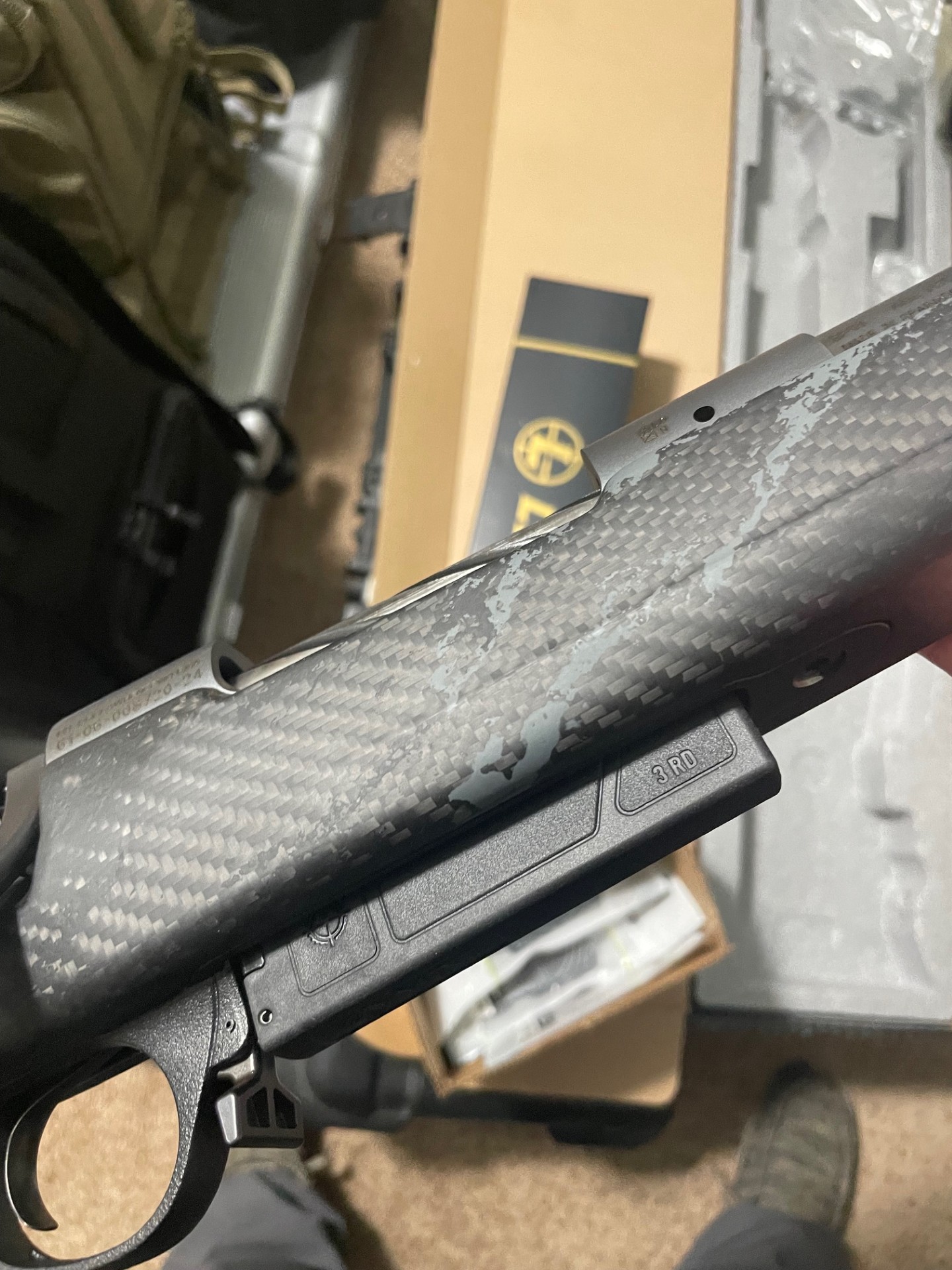

The MDT 3 rnd poly 7PRC mags work great... fit much better and much quieter then the medal mag that came with the rifle.
