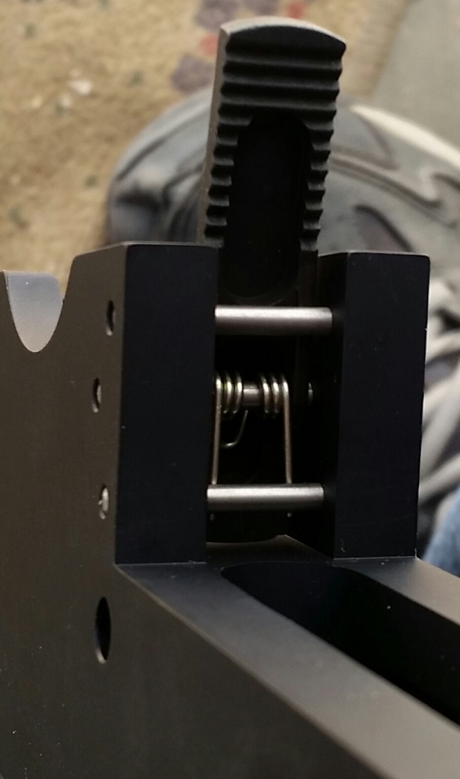

Can anyone point me in the right direction in terms of what springs are being used for AICS bottom metals?
Length, rate, diameter, etc.
From my limited experiences the typical latch spring is similar to the trigger spring or hammer spring in an AR-15. I think I have a picture of one out of an AICS. If I find it I'll post it.
